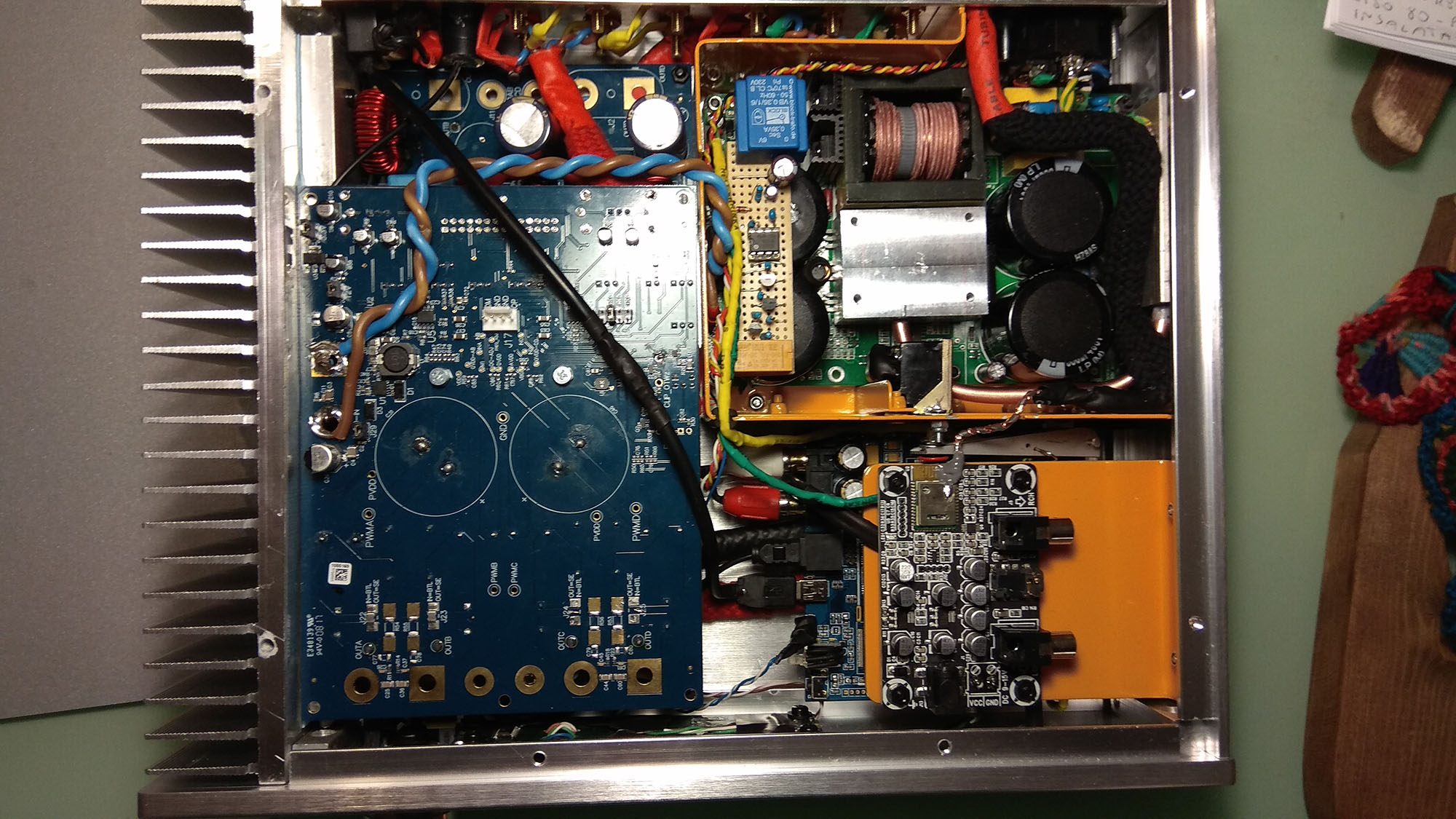

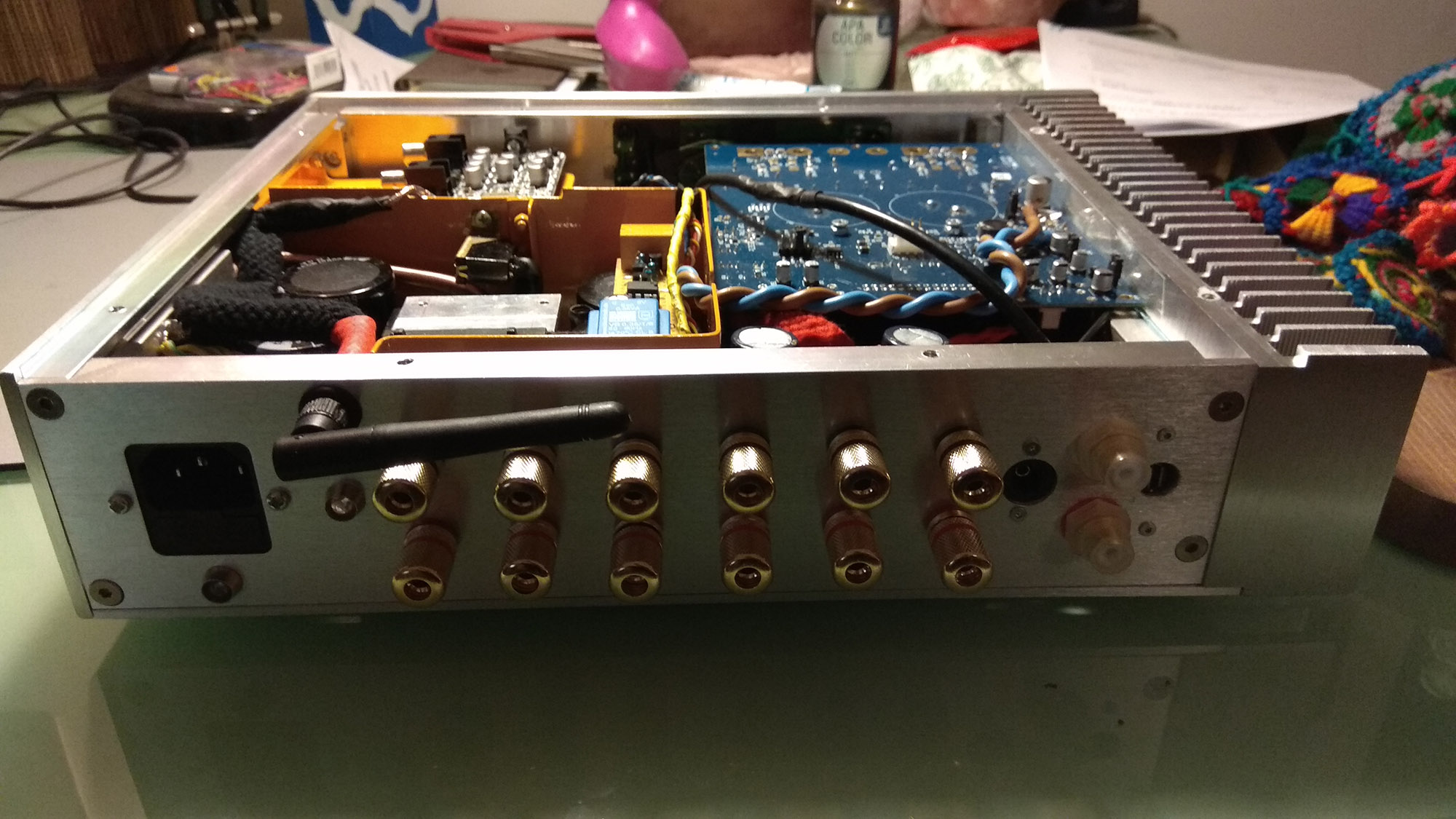

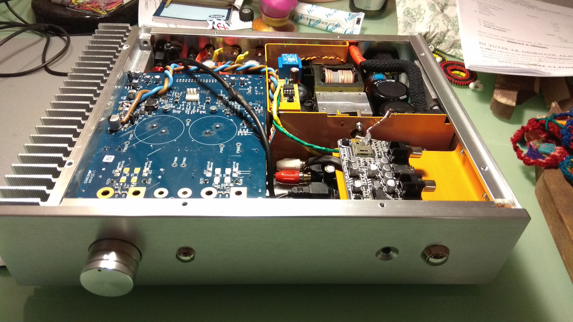

here is my amp, so far.. of course i now need to take it all apart again to troubleshoot!
i know.. the messy soldering. the shifting of the big caps to the other side of the boards was done first, and with a gas soldering iron. I then upgraded to a soldering station so the other soldering is a bit nicer!
its a 30cm x 30cm (approx) case with an 800w smps, 2x 3255 evms , a minidsp2x4HD, and an aptx bluetooth receiver. had i known how crammed it would get inside i would have got a bigger case.. i did layouts in 3d first, but didnt consider how much space fixings, cabling and metalwork take up!

I remember your packaging cogitations, but yeah, that looks a bit compromised to squeeze too much into too little space. I'm honestly concerned about cross-coupling of magnetic fields, but that may be unwarranted. That's a lot of EMI floating around though, so it'll be tough knowing if you're running into a board level or package level problem.
* You could probably yank the PSU out and make a super power brick keeping the local bypass in case if you need the space.
yeah thats always been my backup plan. once id bought all the bits i decided to treat it as a challenge (like tetris!)
ive kept all psu related stuff inside a shielded area, and all cables with any ac or signal on them are twisted tightly and shielded (the line level stuff actually has two shields 😛 )
when its on with no input, i dont get significant noise on the speakers.. just a slight mains hum if i literally touch my ear to the cone.. so it works in that sense.
- i even went as far as activating the power switch with a lever/pushrod from the front button. there was no space inside shielded area directly in front of pre-drilled power button location, so i placed it where it would fit inside shield, then added the lever.. works well!
front panel controls for minidsp are hacked in, by adding a stripped down minidsp remote internally, connected to frontpanel controls. ir emitter is placed next to ir reciever on minidsp. would have been simpler if minidsp actually provided a control header on their board!
