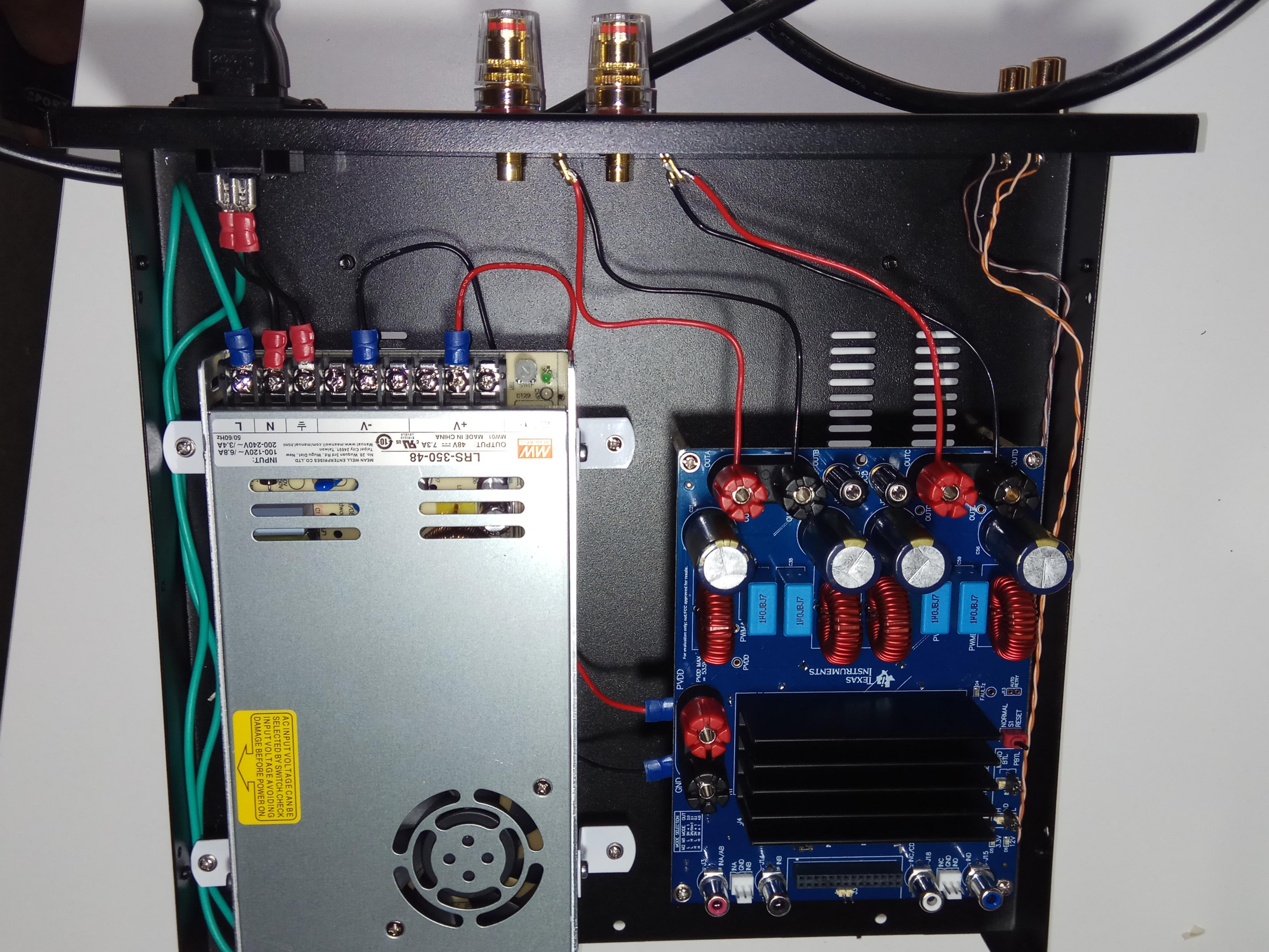

Very high pitch whining sound (>14khz) from the amp and/or PS. Not sure which one is it. I will disconnect the fans in my case and then from the power supply one by one and see if the fans are making the sound. Anyone else noticed it though?

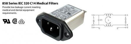

This brings up another question which is should we be using the EMI(?) plug filters (like Schurter), etc?

I have had a similar issue and found it to be a grounding problem.
Check the grounding of your PS and your input device. In your case, are the input connectors chassis-grounded or floating? They should probably be left floating (insulated from the case). You can check if this is the issue by connecting directly to the board without using any intermediate connectors.

Each power supply is grounded using the +/-/GND poles. The amp is connected to the power supply. Since the "case" is nothing but a cardboard box, there is no ground for it. Input to the amp is coming from the Pioneer preamp and output is going to the speakers. The power strip in which both PS are connected is connected to the same one in which preamp is connected. I will still try to lift the ground by using 3-2 pin plug on the strip and see if the sound goes away.
BTW, the sound is not coming from the speakers, since I disconnected the speakers and still the sound is there.

oh wow i totally misunderstood. is it coil whine? if so, probably from the PS. Try adjusting the voltage slightly up and and down. That can sometimes make coil whine go away completely or greatly reduce it.
That was my guess. Blue tack on the inductors (as long as they're not getting too hot) may be another thing to think about. Or hot glue (versus potting).

Finally installed the board and PSU (Meanwell) into the chassis. Everything fit inside and still has enough room to work during installation. Unfortunately, I forgot about the reset switch when order the chassis. I do not want to drill a hole on the front panel. Ended up placing a small toggle switch on the right hand side panel as the reset switch.
