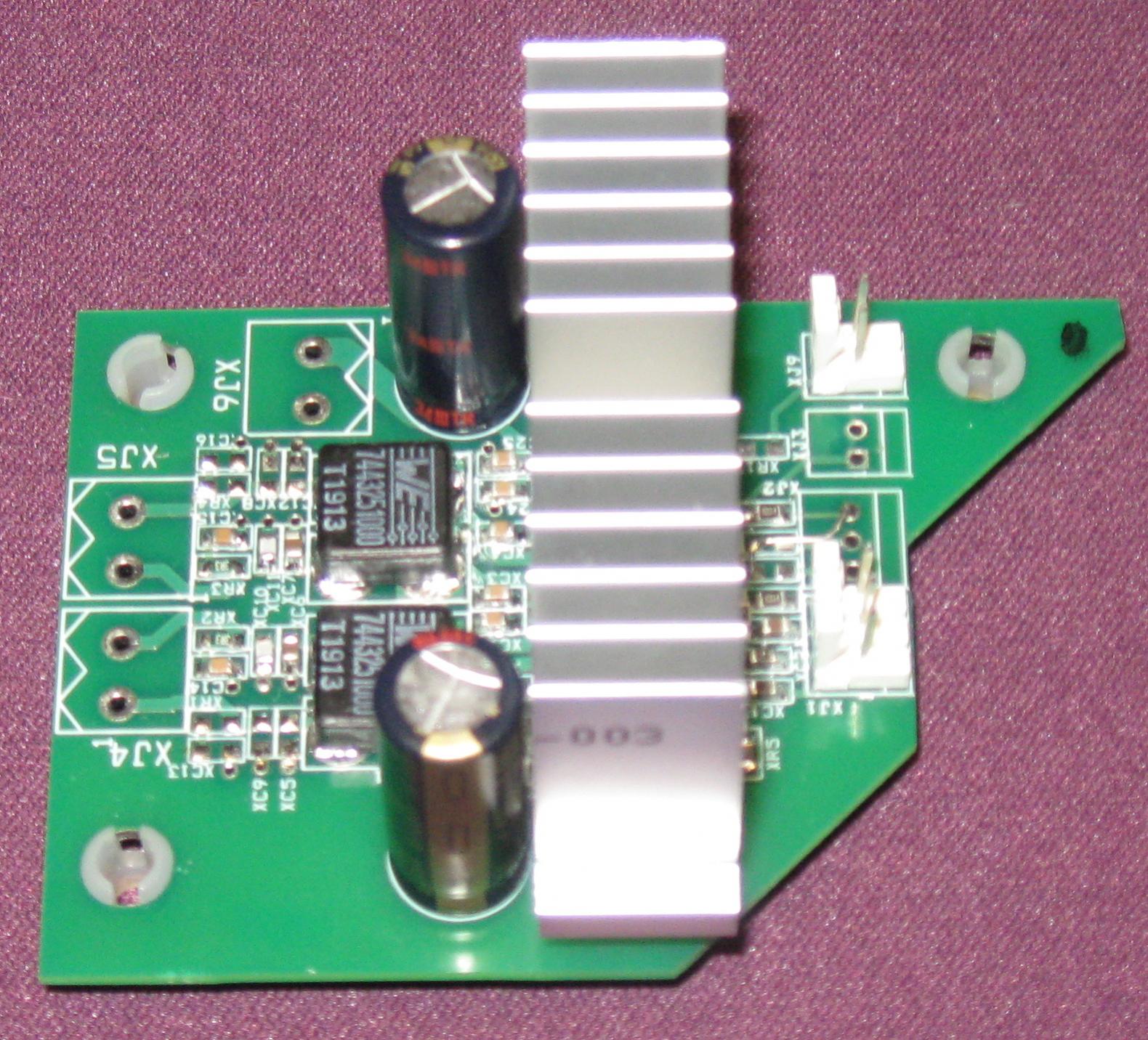

Wow those look beautiful, you do some really nice work there. Amazing to think that this little thing pumps out 50 watts/ch! Is this the base circuit from the part spec sheet and not the eval board circuit?

Did you use bigger inductors than 10 uH for the subs because they look different? Spec sheet circuit calls for same - but I guess if you intend to use it to drive sub, making it bigger gives cleaner rwponse at expense of high freq response.

No, I did not make the boards but I did the layout, soldering, etc.
The other thing I did not do was mil the 1mm recess in the bottom of the heat sink...CNC guy did that for me.

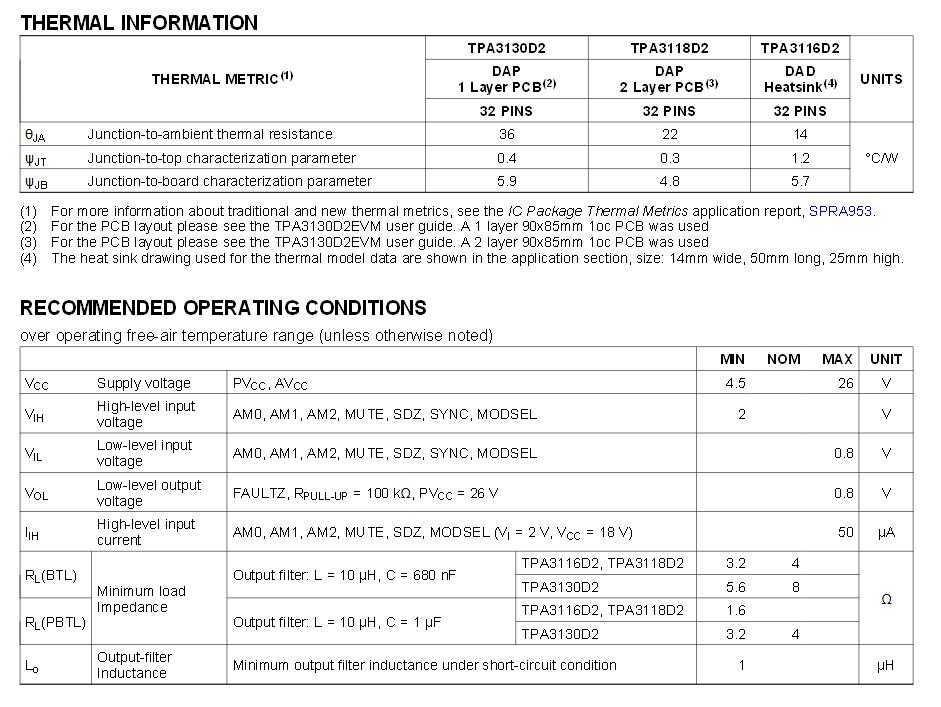

tpa3110 is already bridged. Tpa3116 and Tpa3118 are both the same chip, one with heatsink pad up allowing adding of heatsink above chip and other using pcb for heatsinking thus the lower power ratings. Thats why I said you already built tpa3116 since your dead bug chip was upside down with heat pad up.
tpa3130 is lower current version more suitable for 8 ohm loads.

You are serious? The difference is in the orientation of powerpad only? That may not be true because the letter designations following the chip number DAP (down) vs DAD (up). Why didn't they just call 3118D2 the 3116D2DAP? Neat if so, I can say I know what the sound of the 3116 is like - the same!

TPA3116 vs TPA3118 vs TPA3130
TPA3116 pdf here:
http://www.ti.com/lit/ds/symlink/tpa3116d2.pdf
jpg shows different thermal resistances to heat sink pad. (from data sheet)
I had thought that the TPA3116 had higher output current but both the TPA3116 and the TPA3118 are rated for 7.5A while the TPA3130 is only 4.5A (bottom of page 6)

This is why I was spec'ing the more expensive 7.5 amp inductors at first. But when you pointed out thatook i=V/R we get 24 volts/8 ohms = 3 amps. For 4 ohm speakers you need more or for peak transients. But transients are short and inductor should be able to handle it. The inductors are the single most expensive part (besides IC and PCB) if you go with 7.5 amp units ($1/ea) vs $0.63/ea for 3 amp ones. Are you recommending the bigger ones now? That's what I have in the 3118 foam core build.
Remember that even though the smaller inductors will handle the current, they will be at a lower inductance during that time.
This will change the filtering characteristics and the loading "isolation" for the IC.
I try to design with inductors that do not change more than 10% of value for max current.
Some data sheets give the inductance vs current graphs...these are the ones to look at because you know what they are doing.
