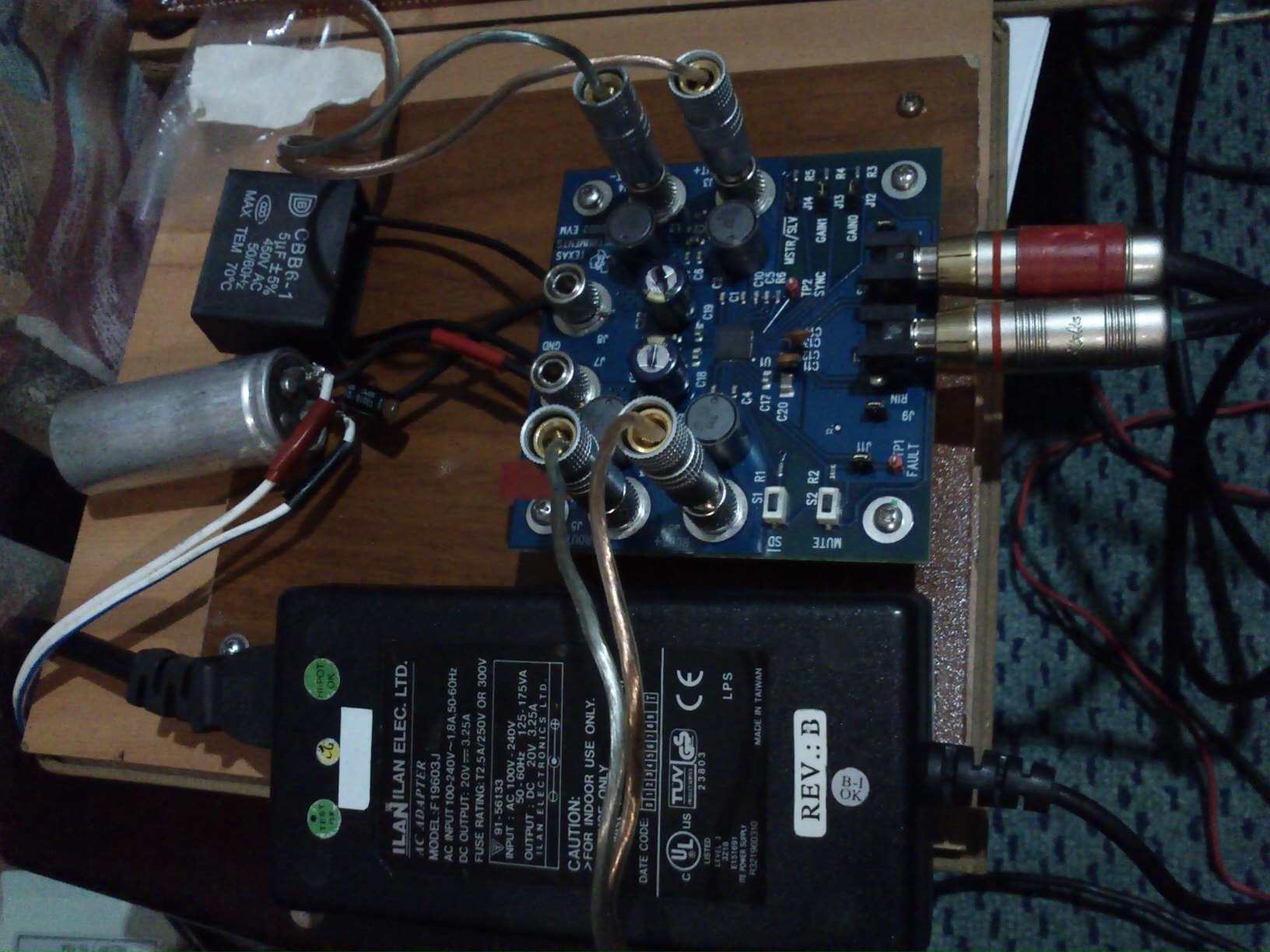

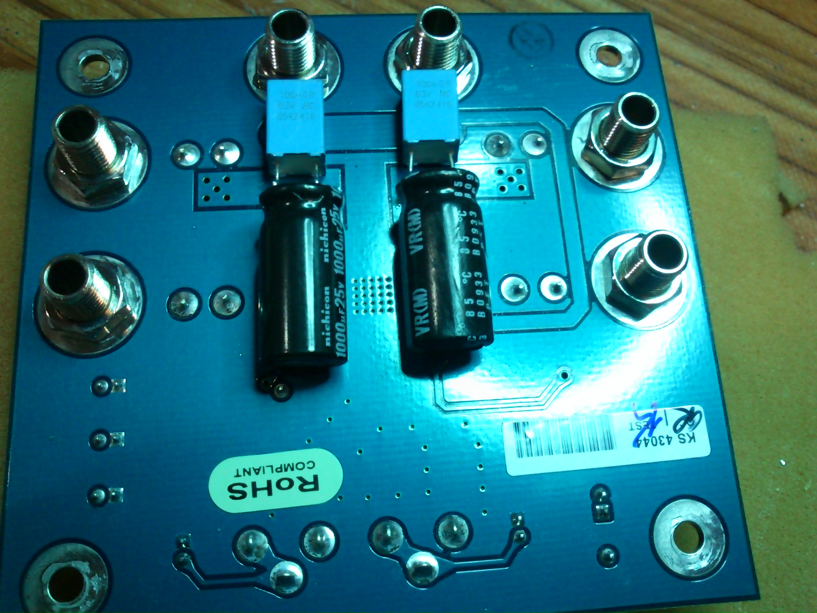

Hi
This are the motor run cap that use. Rather cheap parts.
I tuned it by ear. The 2 biggest caps are the motor run caps with values 0f 1 uf and 5 uf.
The second picture is a more effective upgrade in my view.
I parallel a 1000uf 25 v cap on the underside of the board. The 1000uf is an improvement over the 470uf.
I tried 0.1uf electro cap, 100nf polyester and 101 ceramic caps. The ceramic sound better.
The type of the bypass caps has a big impact in SQ.
You should experiment and post your findings here.
cheers
kp93300
