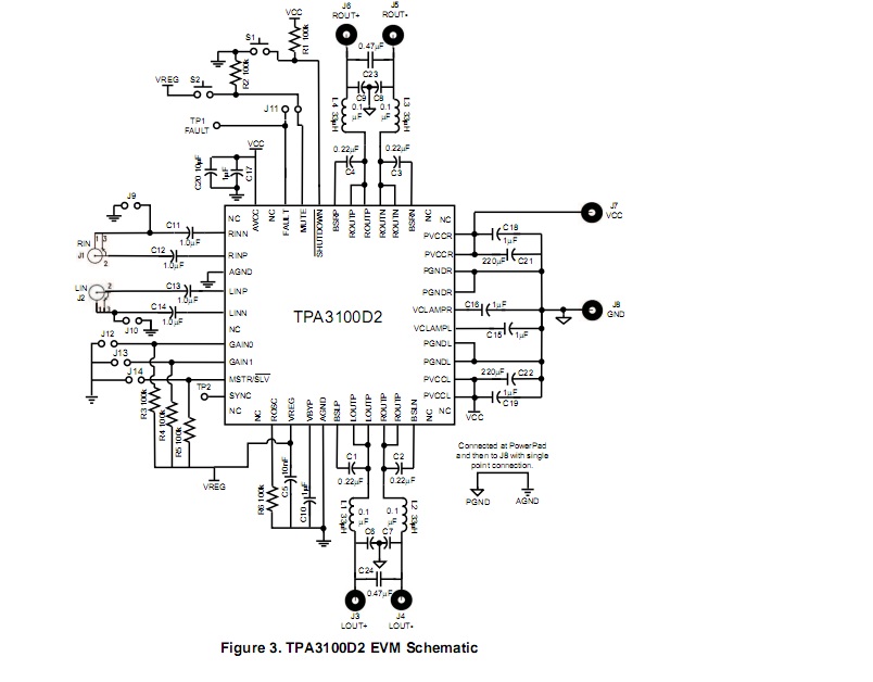

The RCAs are a problem. Maybe someone can figure it out: They have differential inputs with jumpers by them for unbalanced. I have no idea what balanced rca's exist that could be used in the first place. Anyway, I tried to bypass the rca inputs but nothing worked. I tried to solder connections directly to the pads which normally works fine but there is something to how the differential input is set up that I am missing because nothing works. So I have to plug an rca into the jacks and run wires from the plugs to the chassis inputs, creating an unneeded extra connection.
If someone can explain how to avoid having to use the stock rca that would be great.

The board has jumpers for standard rca. The development board pdf in the first post has pics so you can see the jacks and explains differential input.
lol I don't think this thread has generated enough attention to have anyone rushing to make a pcb yet.
I post the schematic from the application manual

Hi Wushuliu, what is the size of the power supply caps and input coupling caps in TBI ??
What is the power supply V in in the TBI?
thanks
kp93300
I have no problem w/ bass or treble. The TBI is similar to the eval board in terms of component values as far as I could tell.

I use a Meanwell 24v SMPS at 25.8v. I have also used batteries and compared with the TBI and although the TBI sounds a little bit better (due to the buffer?) I did not hear any kind of rolloff... Have you played with the gain?
I set the gain at 26 db. Tried a buffer and didnot improve bass and treble.
Vocal has a tube type of sound and is good with the eval board..
I notice that the board use 1uf smd ceramic input caps . The Texas chip is smaller than the Tripath chip.
