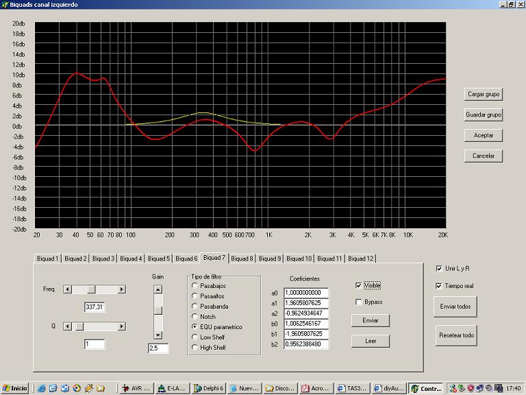

3 days fighting with the same problem,now i can read the flag ok, it seems that you can't read this flag until the dsp i2s and main volume is configured.I am working in a front end for this DSP, now I can manage input mixers, biquads (with a screen showing freq. response, 7 types of equ, all in real time). I'm using an ATMEGA88 , AVR pascal and Delphi 6.

OK, send me you E-mail address to vuelti@yahoo.es, I have code to calculate biquad coeficients and bode plots, greets.
