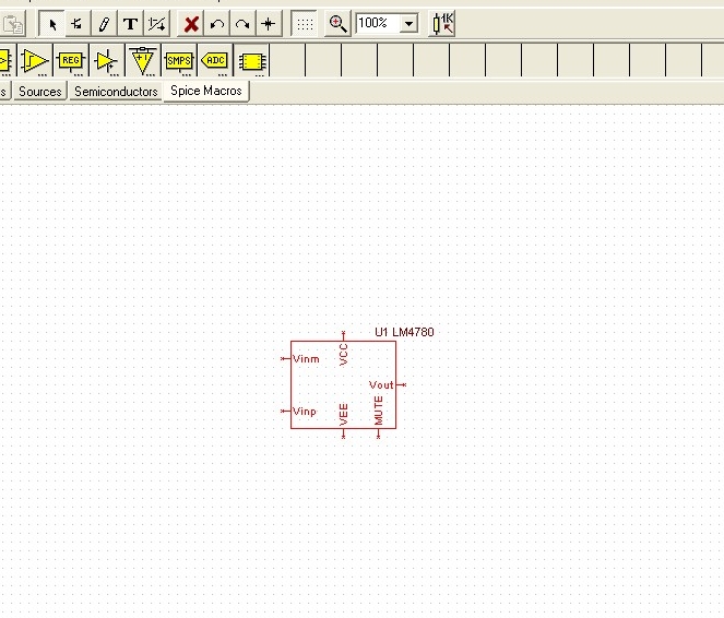

Hello
I've updated my Tina-TI to version 9.
The LM4780 model are included in this version, but as you can see in the image, there is no ground pin.
Where do I connect the ground on this LM4780 model ?
Do you have a working Tina schematic file of a LM4780 amp that you can post here ?

What i understood is that GND pin is important only for specific working condition, principally for muting and undervoltage state, you can read about also in another tread here:
http://www.diyaudio.com/forums/chip-amps/105386-lm3886-pin7-gnd-current.html#post1258074
So you can simulate a normal working condition also without it.
How i already write, you can only make attention to connect the mute resistor to positive supply, instead of negative as in real circuit, becouse this is a bug of spice model.
I have not a clean schematic to post now, because i maked many esperiments to evaluate modding for simply, bridged, paralleled and bridged/paralleled configuration, again other solution on dual point of signal reaction for manupulate dampig factor, included some experiment to modification "My_ref" of Mauro Penasa, using other op-amp driver or discrete circuits and different mode to stabilize in frequency.
Startin by the datasheet schematic, is very easy Drawing a basic non inverting or inverting amplifier based on this chip, anyway, if you have some difficoulty, i can try to reedit and post a basic schematic but you can see the same on the datasheet on Texas site.
I have posted here only some message and I dont know if here I can share directly schematic .TSC file, i fear i must send it to you only by email
I hope my english could be comprehensible 🙂
