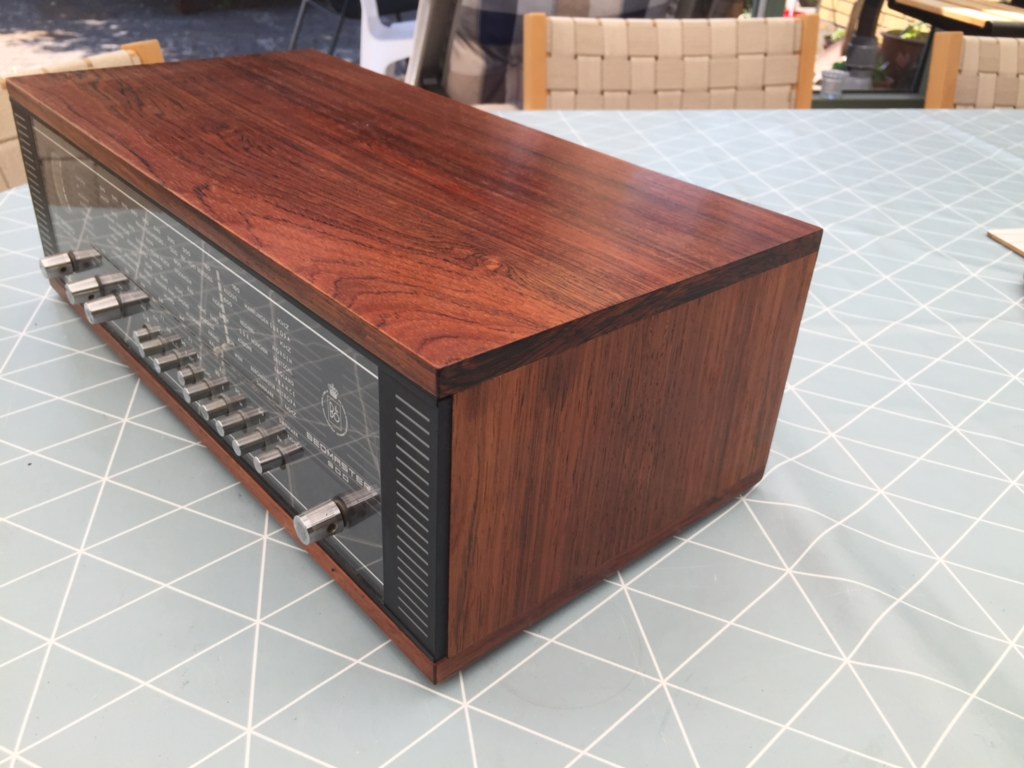

Thanks, thats kind of you. However since a long time ago I have planned to reuse some old stuff and build everything into below beomasters. I've found 2 of those, need a third one for source, preamp and power amp.
EPP-300-48 is the best candidate I've found.

Wow! That looks cool!!
I also almost feel like a vandalist removing the old electronics and giving it a new front plate, everything is so nicely made. I hope 3 next to each other will look nice ;-) Its quite easy to find in my country, most families had something more or less similar (B&O and some kind of wood) in the 60s or 70s. I guess they all knew a guy who knew a guy who worked at B&O :)
