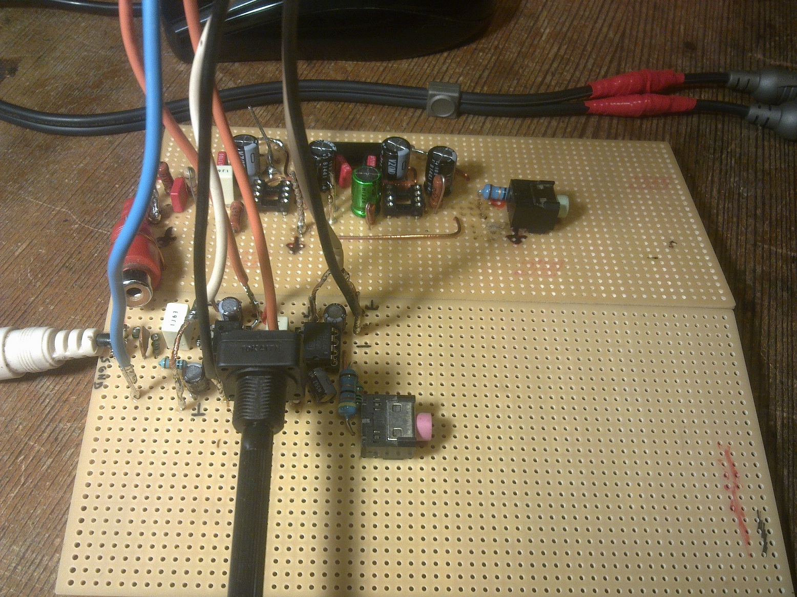

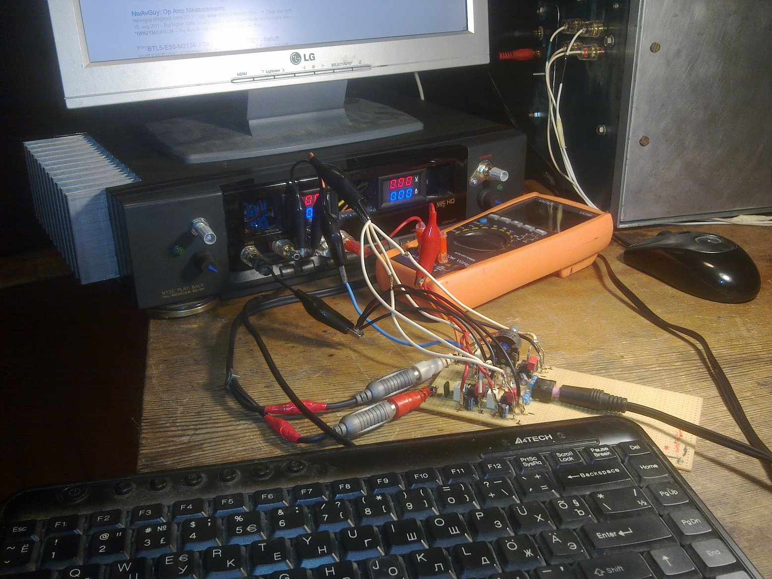

Hi all, build 1 prototype, no hum when heavy attenuation is applied from 10k potentiometer(linear).
But there is a problem, when LM337AT/317AT PSU is turned off, i still hear the sound from amp(gain 27) or headphones(40 oHM) :D
Sound is full of DC, its somehow gets multiplied while Texas is powered off.(DC in 2.4mV, DC out 20mV jumping with heavy bass.....As soon as i turn power back on to the prototype, everything normalizes in no time and it attenuates music as well and there is only 0.8mV DC steady state!
Laboratory +/- split supply has no effect in curing power off sound leakage...
I have tried NE5532, OPA2134, with all these there is still power off sound leakage....
Changed input caps, from tantalum to MKS.
Someone, ideas ?
Thanks for answer (Y)
Yes, i will think of some relay muting/power off circuit.
Finished second one, will add third one, side by side on the same PCB.
6VA 2x18V AC, each winding 170mA transformer with LM AT-series regulators will do just fine :D
First there was a plan to implement them into AMP to get rid of HUM when using potentiometer without active devices.
I think they are better off in a tiny box as a preamp driving longer unbalanced distances.
Maybe someone knows easier way to implement a headphone stage to these Texas devices so one could be used as a preamp or headphone amp ?

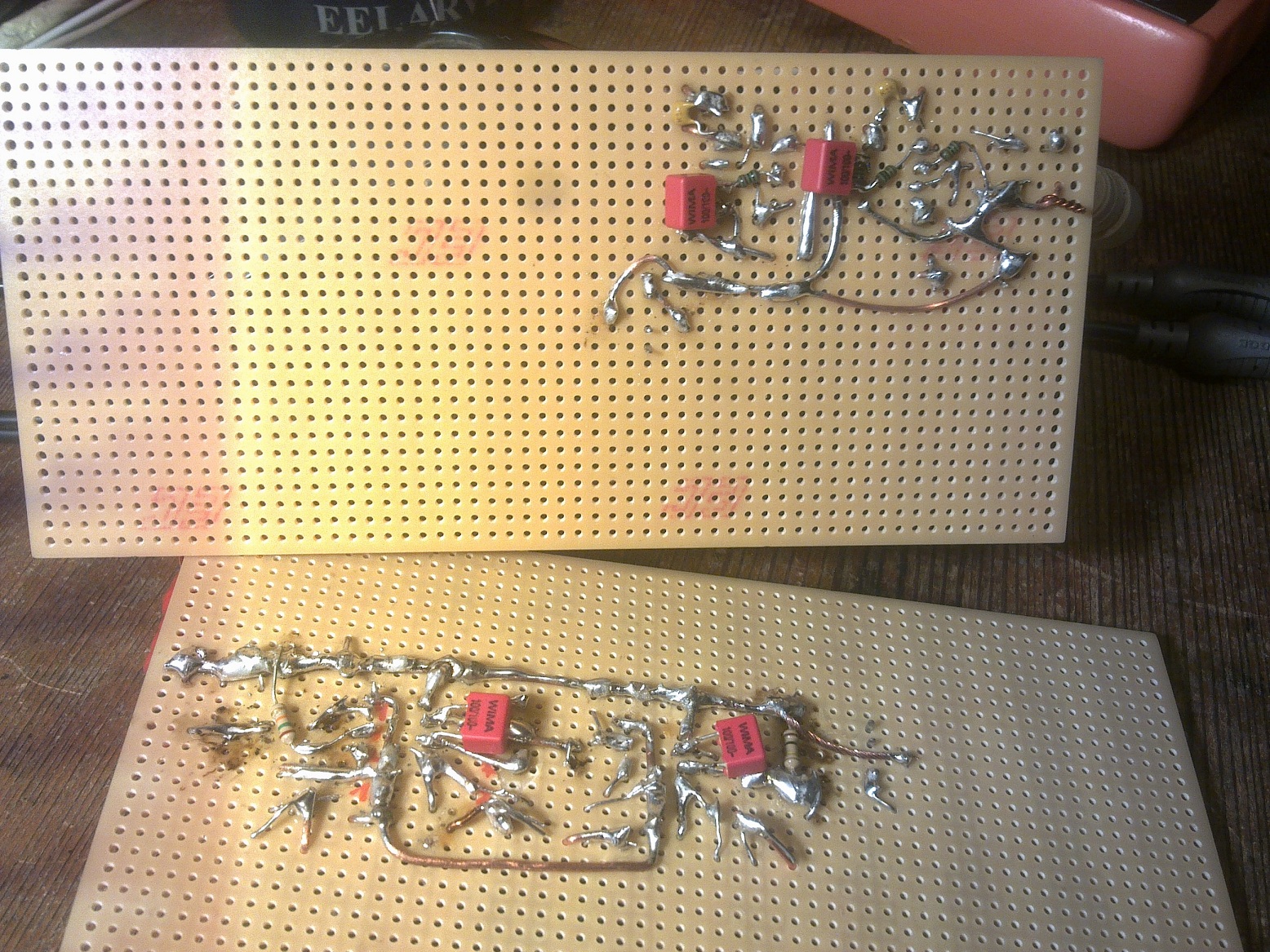

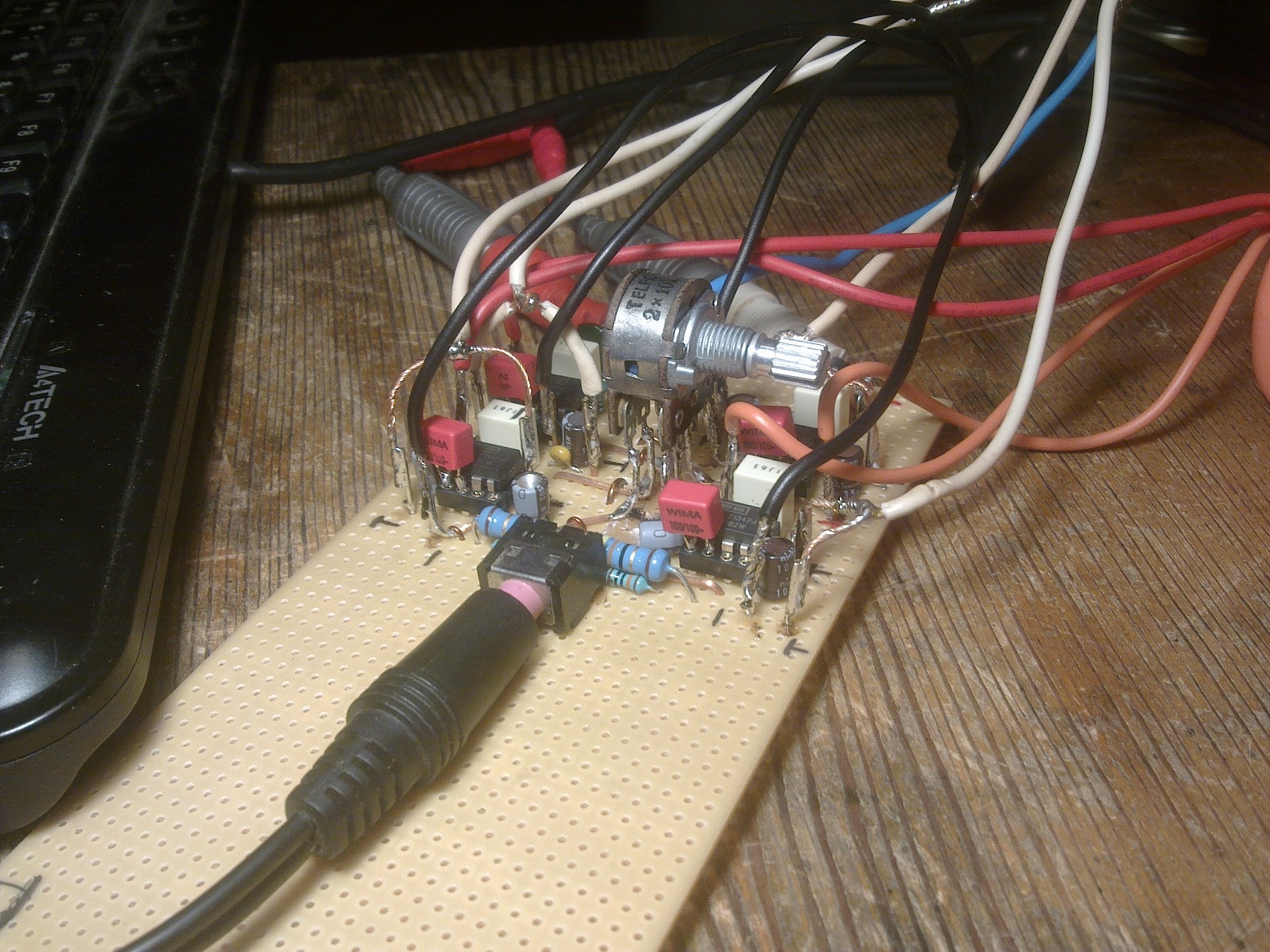

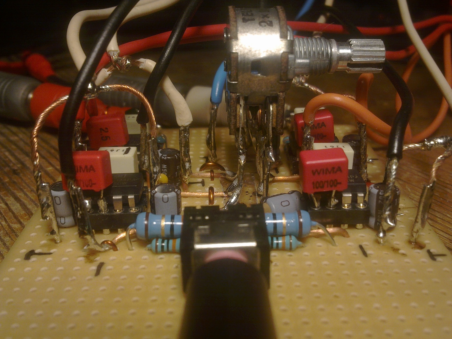

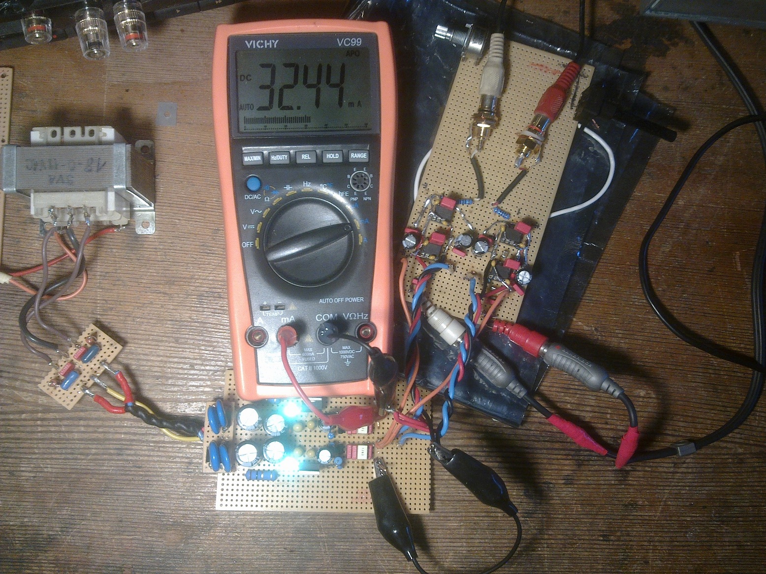

Finished the board
GND`s are separated (PSU and audio) as "stars" which are connected together @ 3.5mm jack output GND.
Decoupling paralleled capacitors are grounded @ PSU 0V star.
No hum or any kind of noise.
Total current draw when both channel are active is 33mA(opamps: opa2134)
Output DC offset is 000,0mV, i don`t even know why it dropped to zero from 0.8mV. But my guess will be in the schematic with changing some resistor values(gain of the first stage opamp).
Max signal input is 0.8V, output signal 1.2V.
Can i use here 1uF instead of 22uF @ both locations of Texas Active volume control ?
Texas recommends non-polarized caps, all my 2uF+ caps are polarized.....
Is it worth constructing better filtering then LM3xAT series can offer ?
Thanks in advance!

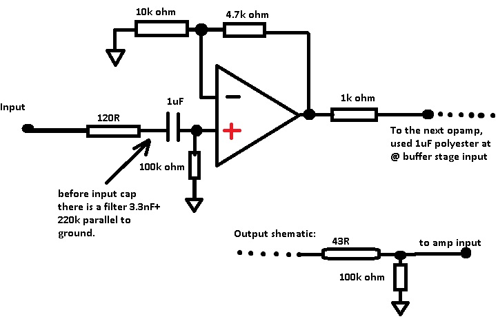

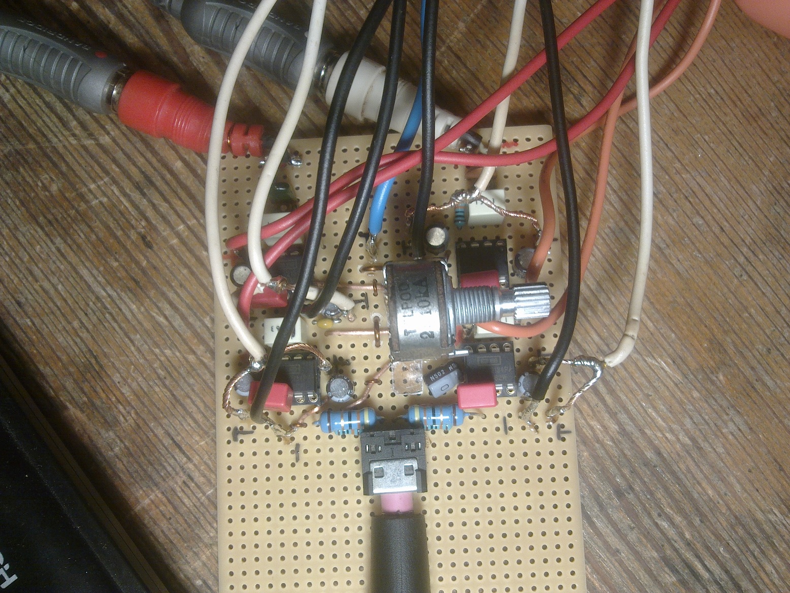

Played with the gain in the input stage, ended up with 24K to ground and 10k from the output to negative input.
Replaced 100k from Texas output with 56k to GND <- output impedance is now closer to the amp input impedance.
Why there is no significant DC on the output of Texas? I used to have 0.08-0.1mV with only 1 channel active.
Both channels active using 1 stereo potentiometer:
(Right channel: -000.2mV)
(Left channel: +000.0mV)
Polarity of DC on the output are somehow different ?
Maybe the reason lays behind the ground-plane that both channels share ?

All those values are insignificant. Any DC offsets are determined by the inherent characteristics (their internal offsets and so on) of the chosen opamp and any external imbalance caused by the circuit values allowing differing bias currents to flow into each input.
At those levels each opamp will be different and each channel different one to the other.

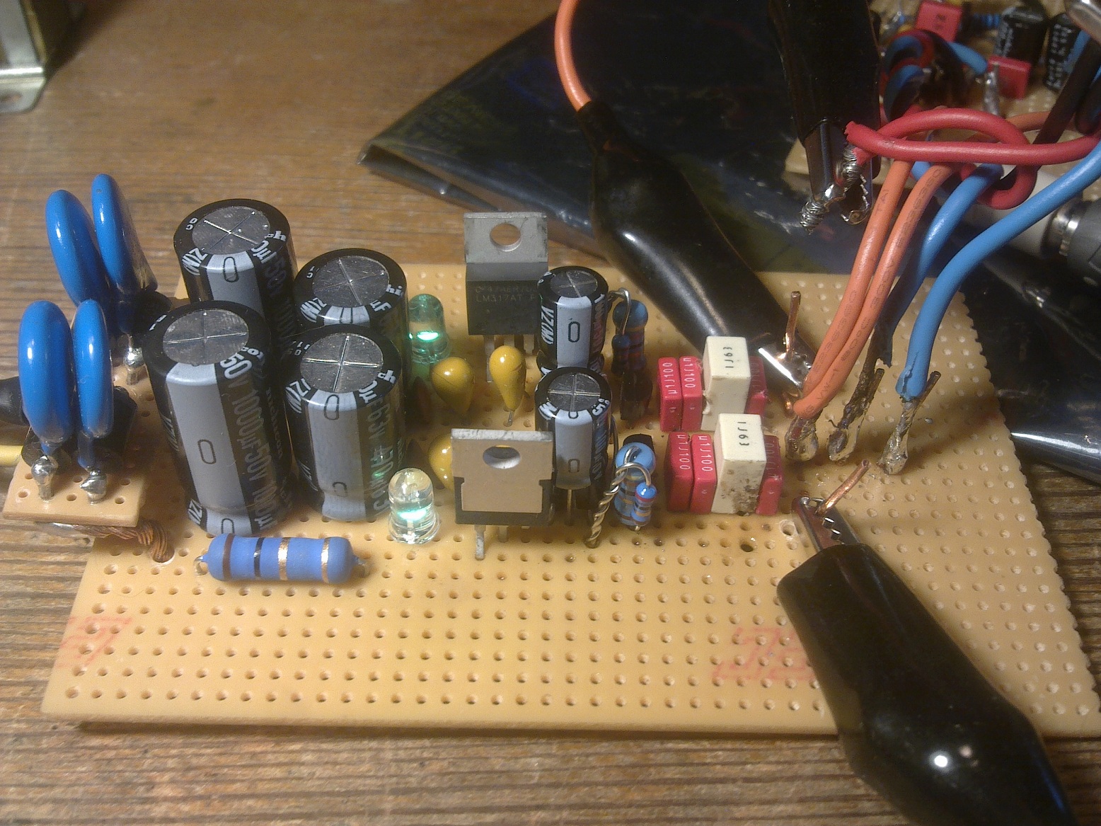

Firstly, tried different PSU schematics on that Texas. LM317AT/LM337AT with the right ESR caps on bypass and output, results = OK.
Then build another LM317/337 psu with the shunt on the output. Results= Better, especially in highs and top end was more like "bounce", very melodic, maybe even better dynamics.
15-18V variations were used, ended up using Texas with +/-15.6V.
Tried 22uF 35V Tantalum capacitors as signal coupling on Texas. Result: Better then 1uF MKT for sure. After a while changed Tantalums to 22uF SMD ceramics. Results: Not sure, but it seems ceramics sound softer then Tantalums.

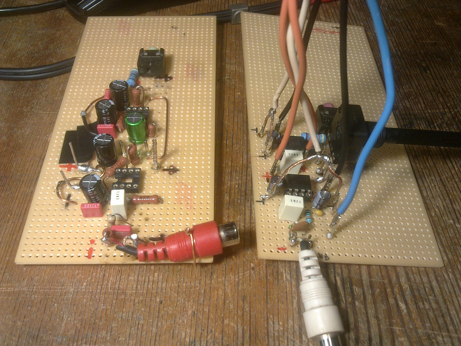

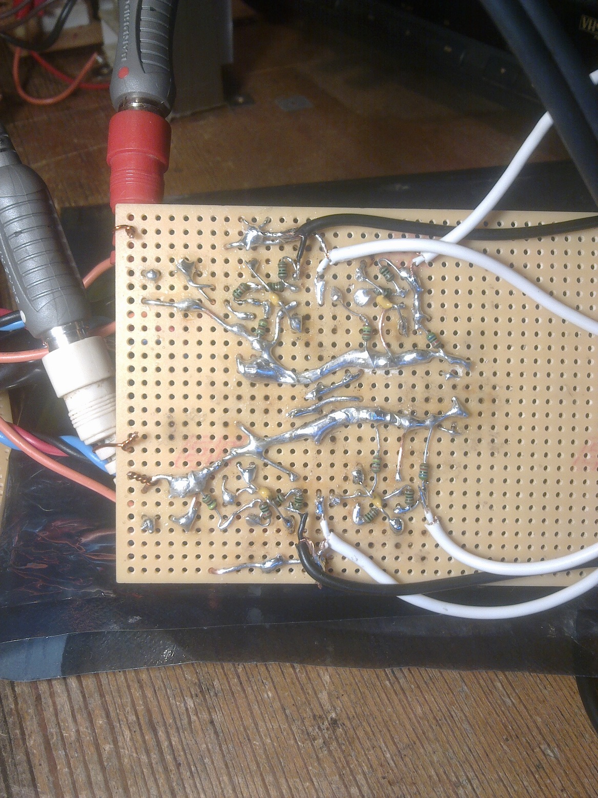

Before mounting everything into amp chassis, decided to simplify Texas Layout.
Rebuild: less wires, more GND routing on the PCB, less electrolytic caps(cuz of the higher uF value per cap), bypass on electrolytics with 3.3nF MKT, 100nF bypass capacitors(X7R ceramics) from every supply pin and as close as possible. Output resistor is now 100R instead of 43R.
Signal GND and decoupling capacitors GND routes/traces are connected together only at 1 point: PSU 0V GND.
Power up time: to our suprise the DC offset is back with the new LAYOUT, both channels are equal -0.2mV.
Secondly, whole Texas draws less current lol. 34.6mA before, ~33.2mA now.
100R has nothing to do with schematic current draw.
Then, added one 10nF X7R capacitor on each opamp package as +/- supply coupling. Turned Texas on, again, the current draw dropped, now 32.44mA.

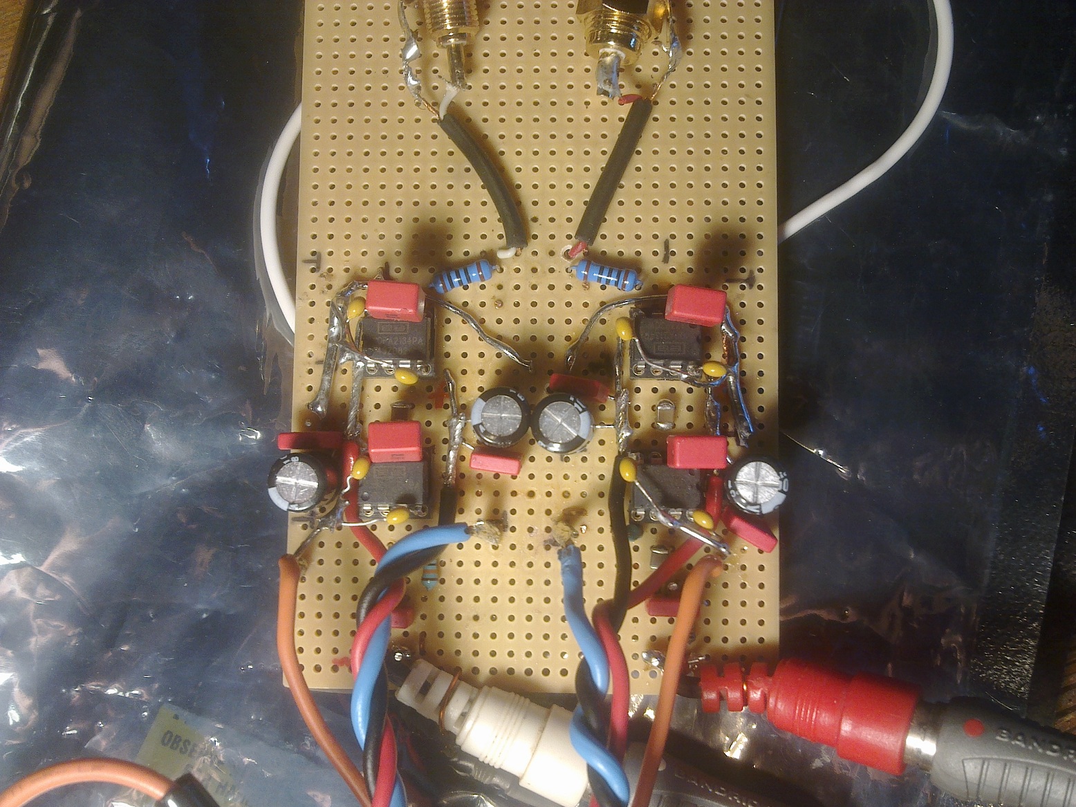

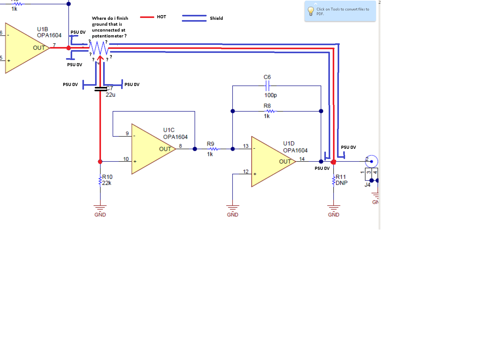

Question: duo to layout limitations in the case i cant mount potentiometers on the PCB, so i took them out from PCB via "shielded wires", the ones used in RCA audio cables. Only at one end Shields are connected to PSU star 0V gnd, where do you suggest to connect the other end of shields to avoid potential humming noise? See the last picture please.

You can leave the shield floating at the pot end because its doing its job by being grounded at the other.
(It is also possible to drive each shield from the appropriate opamp which retains a low impedance for the shield, and because the shied is driven as well, the cable capacitance is cancelled out because there is no potential difference between shield and inner)
I was going to say that, too. But it might be worth having the body of the pot grounded too - assuming it's made of metal. That might just help a little bit. But keep away from making a circuit because, as Mooly says, it's doing its job already.
