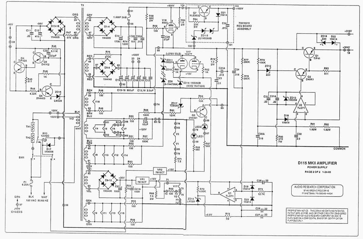

I use two Audio Research D-250 Mk II Servo amps. These are from the same era as the D-115 mentioned in this thread, and share some circuit similarities. In addition to the two opamps that are feeding the screen supply and front-end voltage regulators, the D-250 Servo model has a DC-servo circuit employing opamps to keep the DC-coupled gain stages at the proper operating points. I had noticed a significant thump at turn off when I first got them (mentioned in the reviews, too). I attributed it to these opamps shutting down before the slow decay of the tubes. After I replaced the main B+ power supply caps with double-the-capacity caps, they made Zeus-worthy thunderbolts. Since I'm using them in a bi-amplified arrangement, the directly-driven midrange and tweeters were getting the full brunt of this thunder. So I used a Schottky diode and 30,000uF of capacitance to hold up the opamps for a while longer, similar to what Tube Mania suggested. I had to get up to this high level of capacitance, which is not prohibitively large at a 25 volt rating, to quell most of the disturbing wallup. There still is a pop left. It believe it comes from the front-end inverter used to convert the unbalanced input signal to a balanced signal. The D-115 uses a single triode in this stage, while the D-250 uses a pair of triodes here. This stage is the only section of the circuit that can cause an imbalance in the amp at shut-down, thereby causing a differential voltage transient. The pop is maybe 10 or 15 dB lower than the original big thump, so I'm living with it.
Old thread but I've got D115 which upon the turn on makes thumping noises and flashes in the output tube screens . The sequence is that while the tubes warm up it is quiet than it starts humming and the thumps and flashes begin for a 10 -15 seconds than it stops and the amp plays fine. Kind of annoying since it's intermittent. All the tubes check out fine. When I pull out the V1 input tube left channel starts oscillating -thump , thump, thump 🙂
I may be that on turn off some of the HT supply is dropping out too quickly. It could be the supplies to the input stages - phase splitter. Maybe some of the caps have dried up a bit. I had a problem like that. Basically the negative bias on the output should collapse in order to dischage the HT to both output valves in a symmetrical way. If the input stage collapses first that can produce a thump on the grids which is differential.

It actually happens on turn ON . Cleaning regulator ( 6550 12AT7) sockets tubes pins helped a little. It thumps only when turned on from overnight rest. Subsequent turns ON not do not produce thumps and flashes. I'm replacing the aging PSU caps since they are marginal . The V1 power supply (304v) is stable so no shorts or obvious faults.

My first instinct is in turn to put a scope probe across each of the DC supply rails (use x10-x100 probes) and see if there is any instability on power up, also power down. Do this sequentially. If the instability is suspect and cannot be seen then it is highly probable that RF could be produced beyond the Scope bandwidth. This where I always use an old AM radio which will most certainly 'squegg' or chirp.

Update regarding the turn-off thump of Audio Research amps such as the D-250 and D-115 and others: I happened to notice that the arcdb.ws site has recently posted a turn-off muting modification for these amps. This pdf file includes some handwritten notes from ARC. Basically the mod is simple; it adds two relays that short the outputs immediately upon turning off the amp.

The relays shorting the output do seem brutish, but the only energy being dumped through the output tubes after shorting is a short-lived thump of maybe a couple of volts. Should not cause a problem.
These amps can be converted to fully balanced, which is the natural state of this circuit. The added inverters up front convert what is essentially a balanced amp into a single ended (RCA jack) amp. In the eighties balanced had not yet caught on in a big way. By eliminating the inverter, the thump is eliminated.
