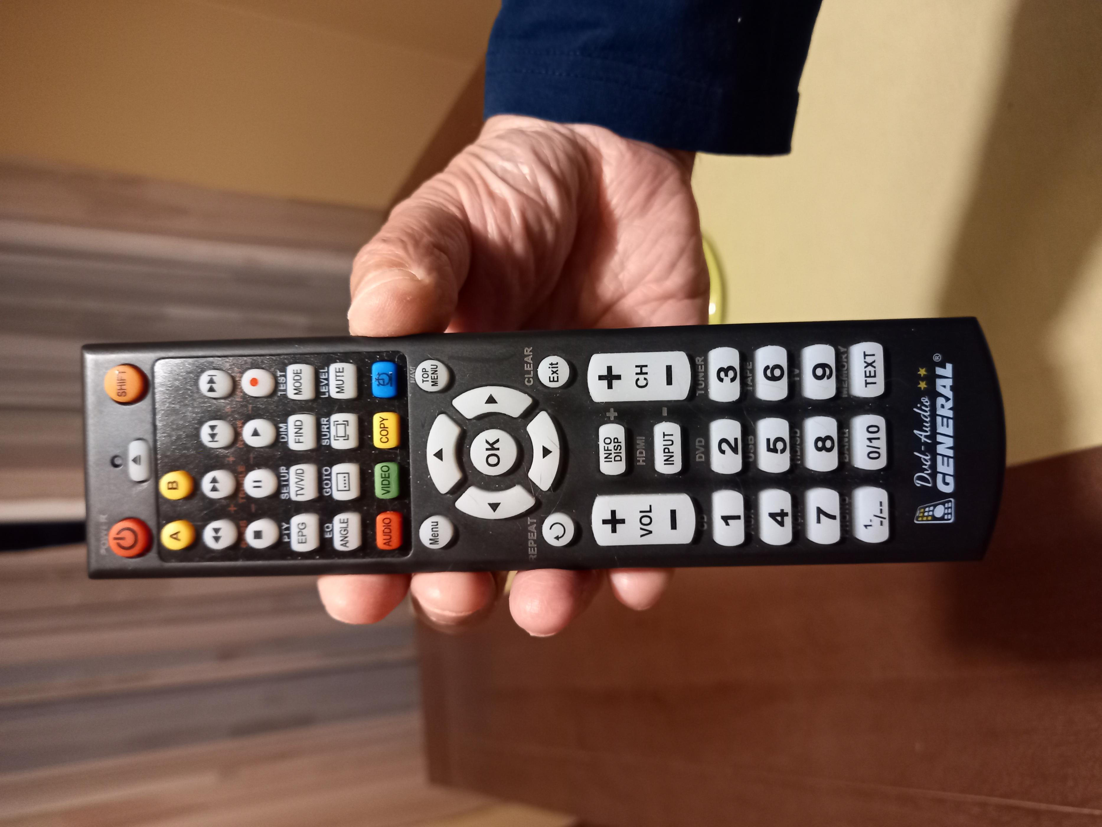

Remote for IA100
Hello,
I bought a generic remote control on this site:
REMOTE CONTROL WORLD, REMOTE CONTROL WORLD, E-shop with original and replacement remotes for TV, SAT, DVD, Audio.
and with I can access all the inputs
see attached
Have a good evening
Hello,
see attached
Have a good evening
