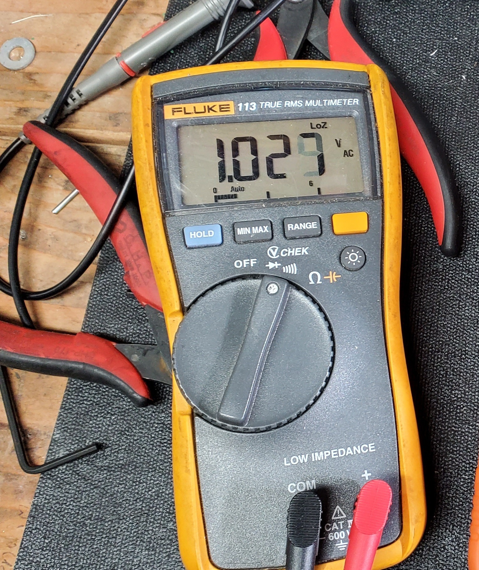

I understand that now, noticed a few others mention it and in all honesty never considered it. There is a "but" in this circumstance.. there would be no way for me to know if resoldering created a good connection as there's absolutely zero visibility. making things worse, other resistors are very near and adding solder blindly could be hazardous.. Since this diy thing is supposed to be fun, i decided to go deep again (and again) but thanks for the input!

Sounds like you've got it fixed. Just FYI, either Fluke or HP specifically recommended this method on test equipment, probably because they considered trace damage far more important than a minor appearance issue on top. Unfortunately, I've never been able to find the specific manual where I read it.
