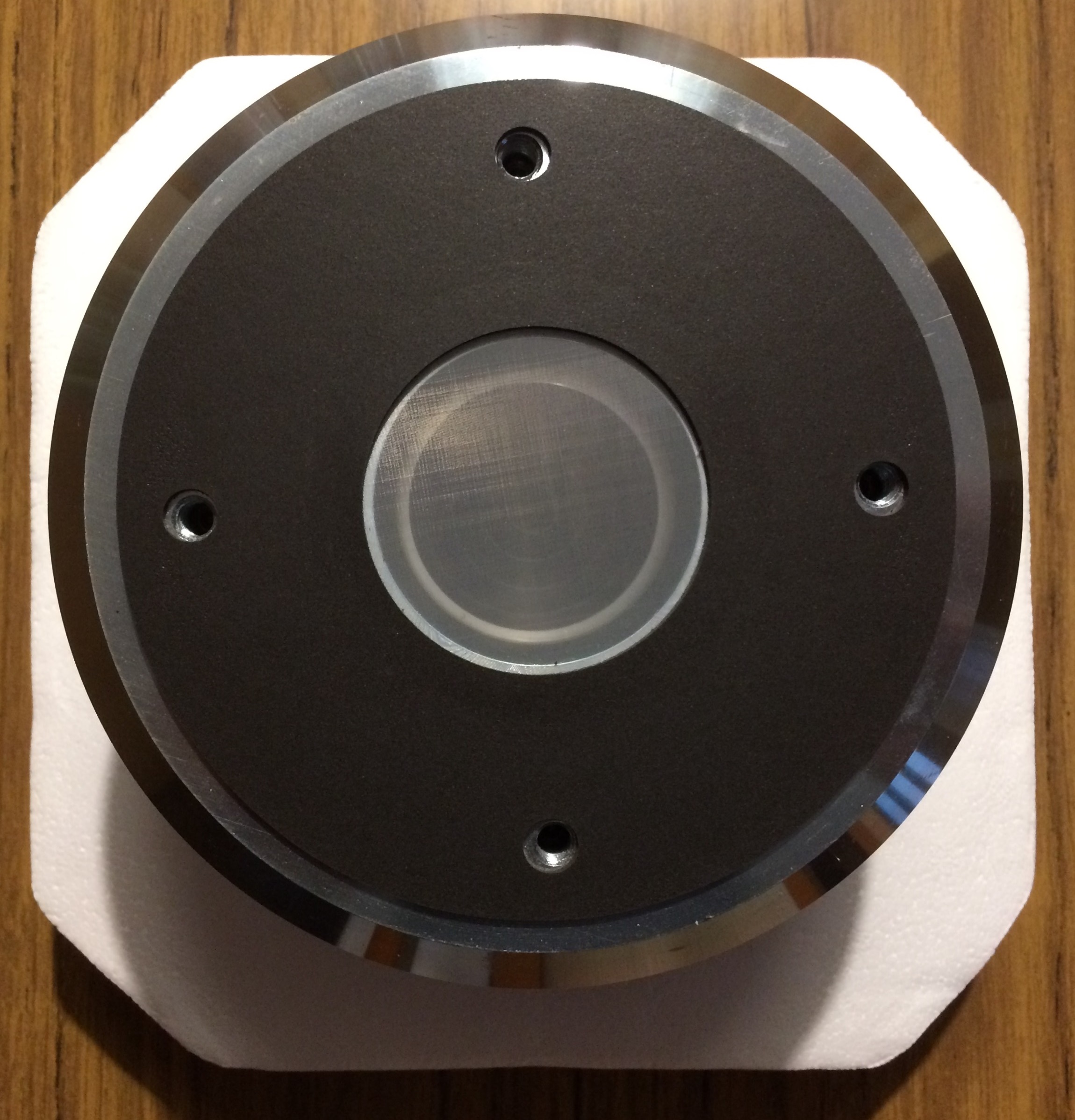

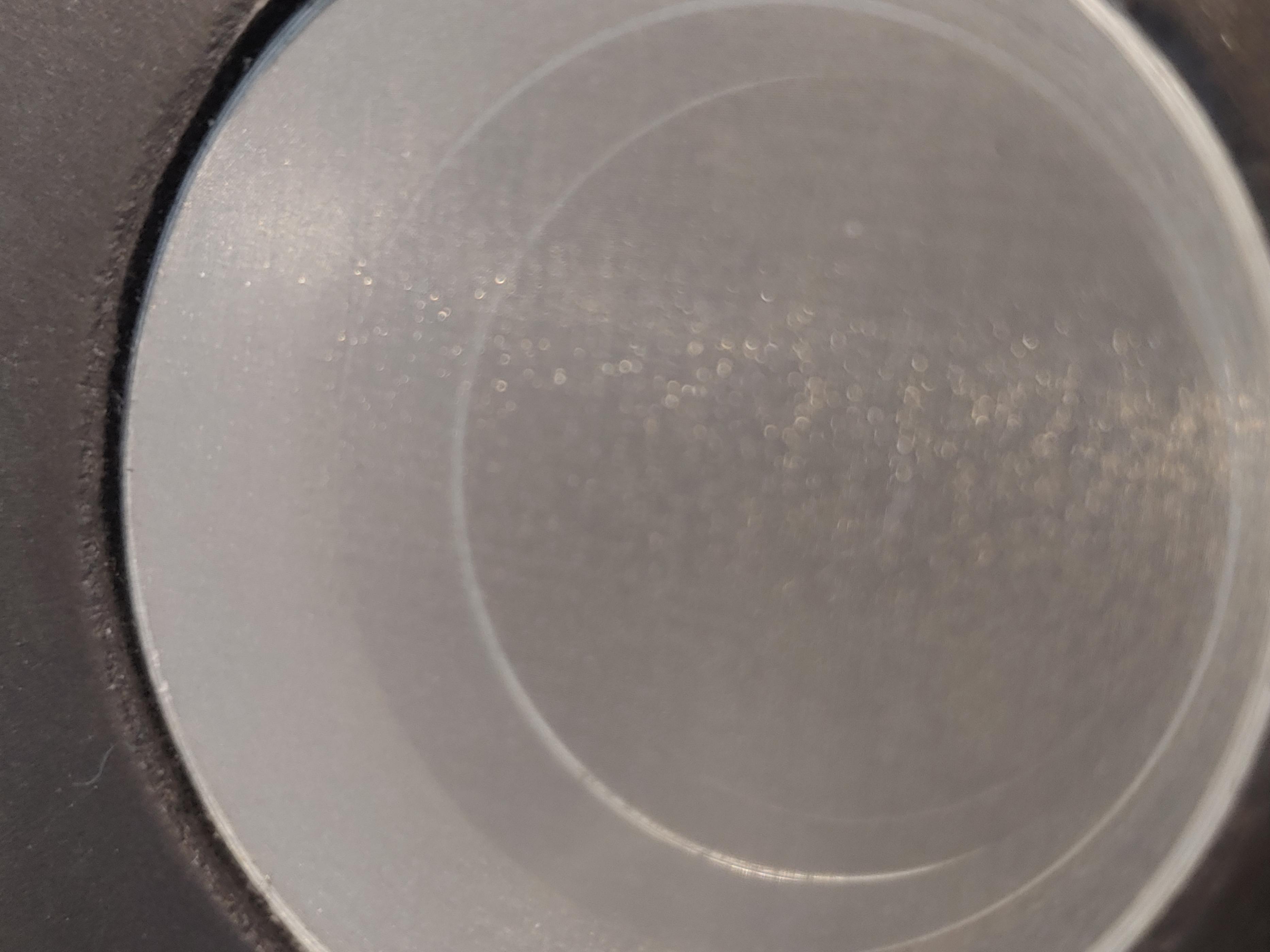

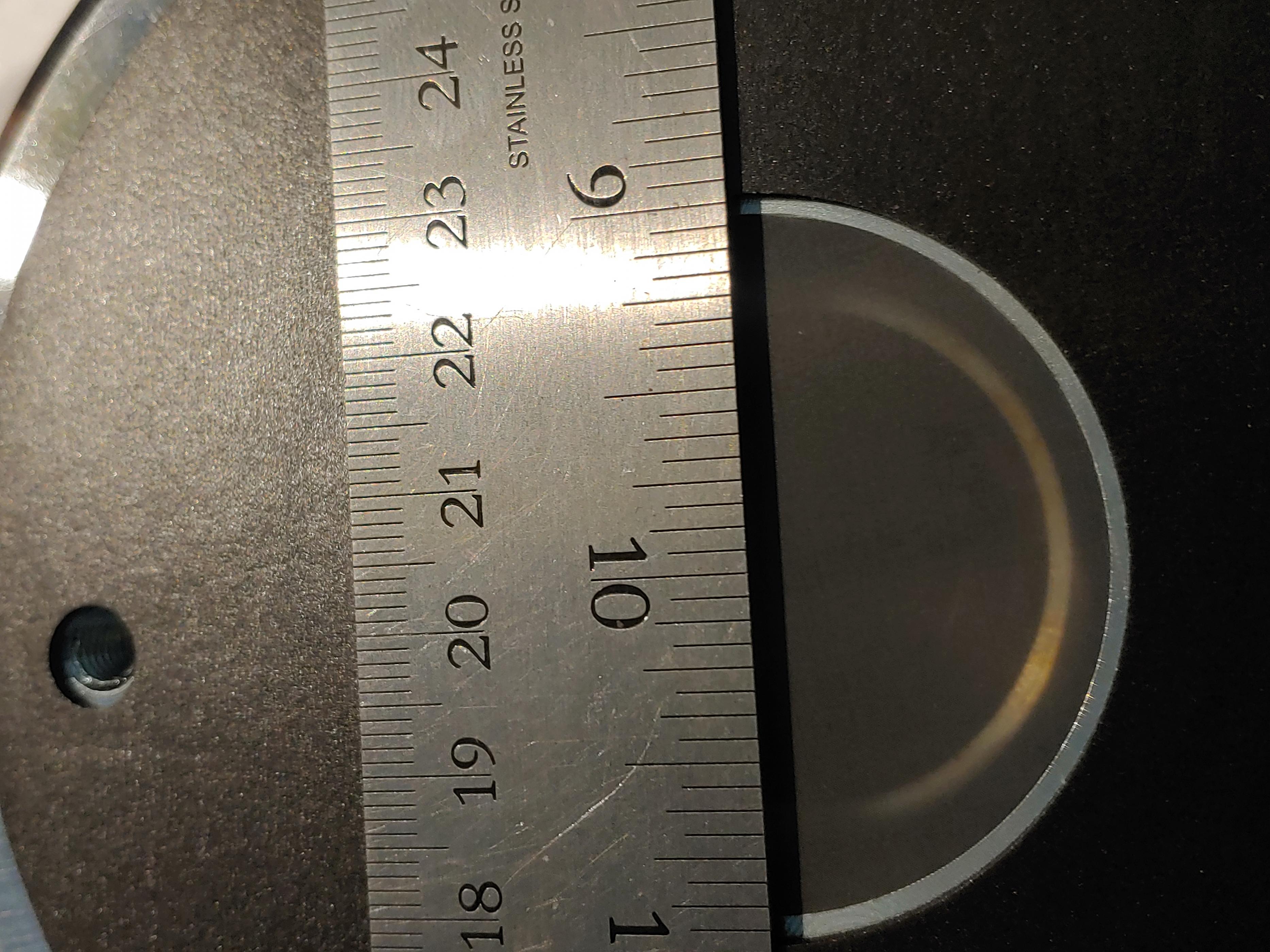

I have had a pair of Radian 950PB (AL diaphragm) for about a year now and have been using them on a pair of Azura 340 horns. I liked what I was hearing and so I decided to upgrade to the Be version. The new drivers arrived today and the throats have a big step in them which is not present in my older 950's.
I have a bunch of compression drivers and I have never seen a big step like this in a throat.
All the other drivers I have are smoothly tapered and I always thought discontinuities in the throat/high pressure region of horns was something to be avoided.
Radian customer service says they have not changed the throat designs but the two examples I have are clearly and significantly different.
Is a step like this normal ?

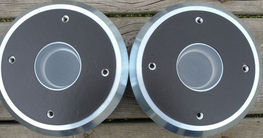

I would recommend showing Radian those pictures.
It appears to me that someone ( in assembly ) forgot to insert a piece of plastic throat expansion.
Hi Berd, yes this is normal.

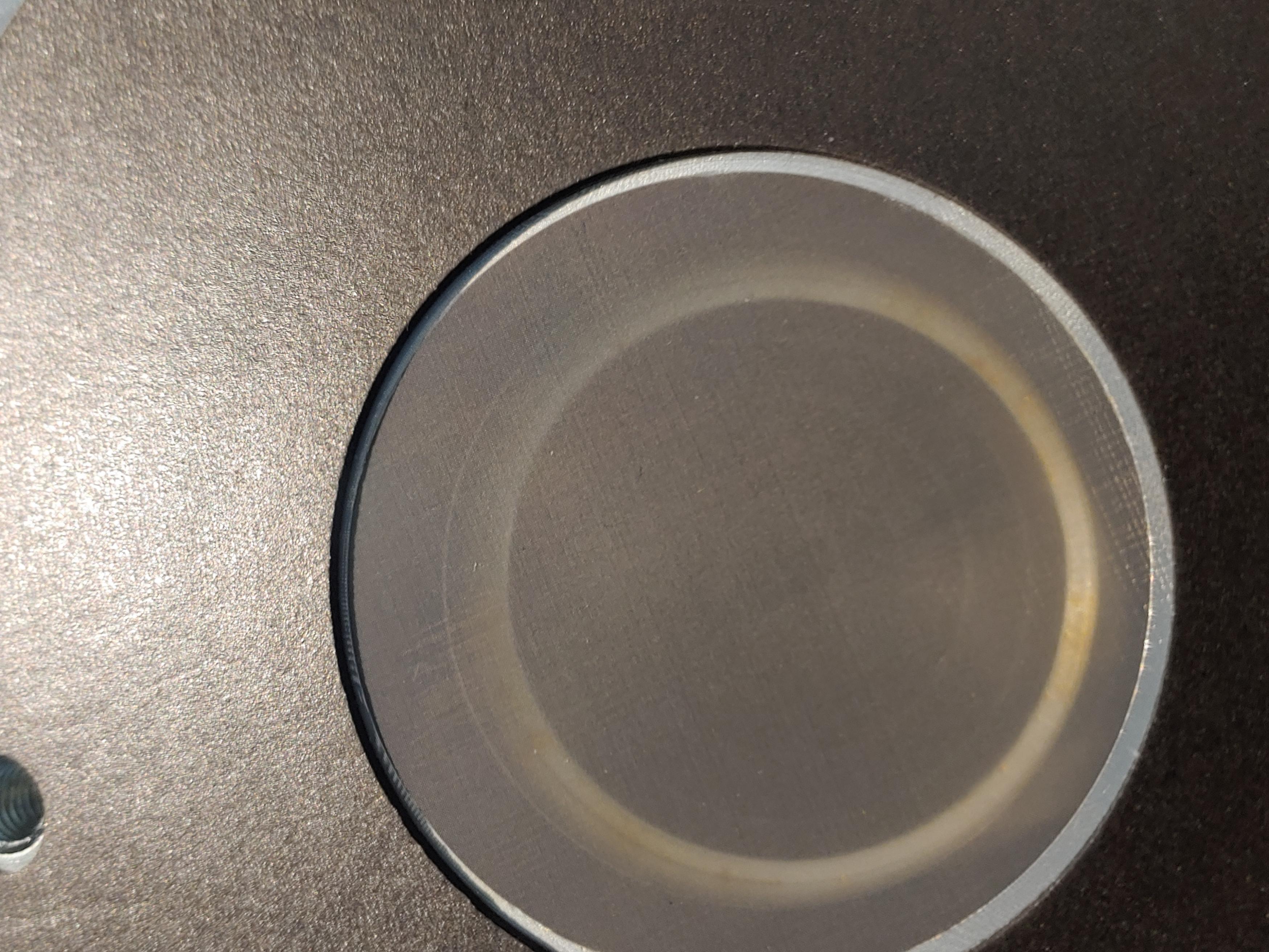

I bought mine in 2012 with AL diaphragm and later installed the Truextent. This ridiculous step was there, first pic. Second pic is from internet, I made a search to verify if this "incorrect" design was normal, and it was. I cannot understand why they did two geometries of the same model.

it may be "normal" for this design but it seems crazy to have a big discontinuity in the throat of what is supposed to be their top of the line driver.
They sent a link to datasheet which show the step.

Thanks for sharing the pictures.
Provides another data point - 2 with the step and one with a taper.
Did you keep the drivers ?
Do you think the step negatively impacts the sound ?

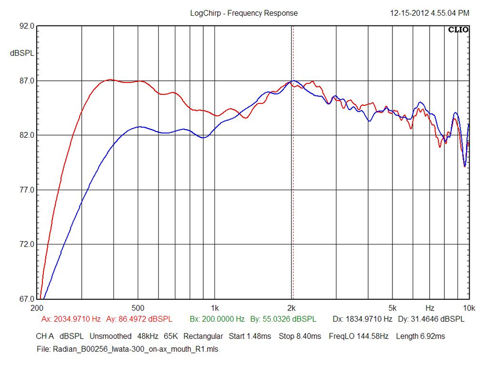

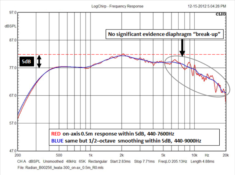

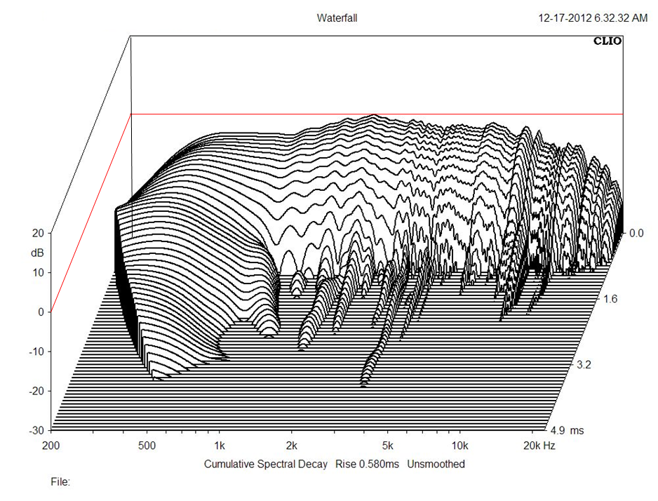

I have no idea if this step could affect the performance, I have no knowledge to determine this. I paid someone to develop the filter for this CD matched to an Iwata-300 horn. I attach the graphics I have. Hope you or somebody else can clarify to what extent such step impact (or not) the sound.
Regards.
After you assemble the driver and horn, I would use Mortite ( ribbon calking ) from Home Depot and fill in that step. You will have to listen both ways and the Mortite can be easily removed without damage. I used Mortite on my horn / driver connections to make sure the connection was smoothe. without irregularities. The throat / horn connection is VERY critical, that step can cause unwanted turbulence. Good luck
