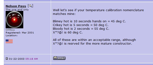

How hot are the heat sinks? See list below:
One side hovers around 47°C and the other around 50°C as measured with a digital oven thermometer with a small piece of foam on top to minimize the cooling effect on the sensor bit. My brother (who has the SA4e at this moment) can hold his hand 6-7 seconds on one side and 4-5 secs on the other.

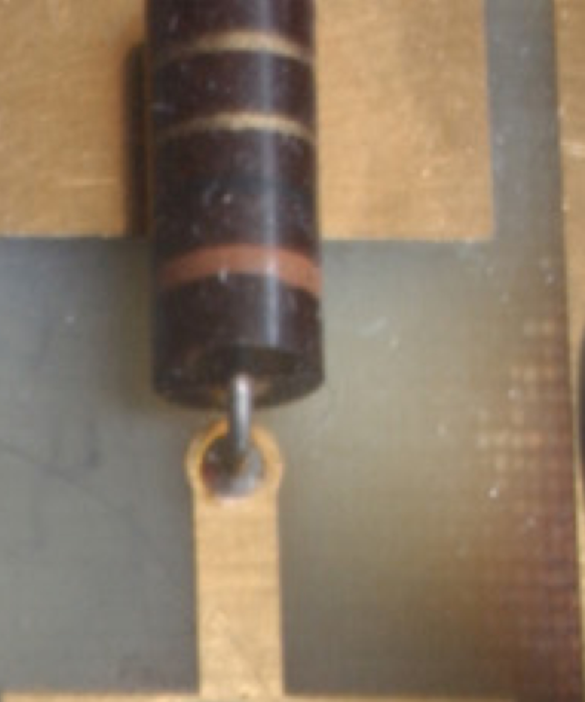

Hello Gulahuset
Maybe you can try with digital multimeter verify if all carbon composite brown colour resistors
ohm value was not drifted too much. Can happen after many years
