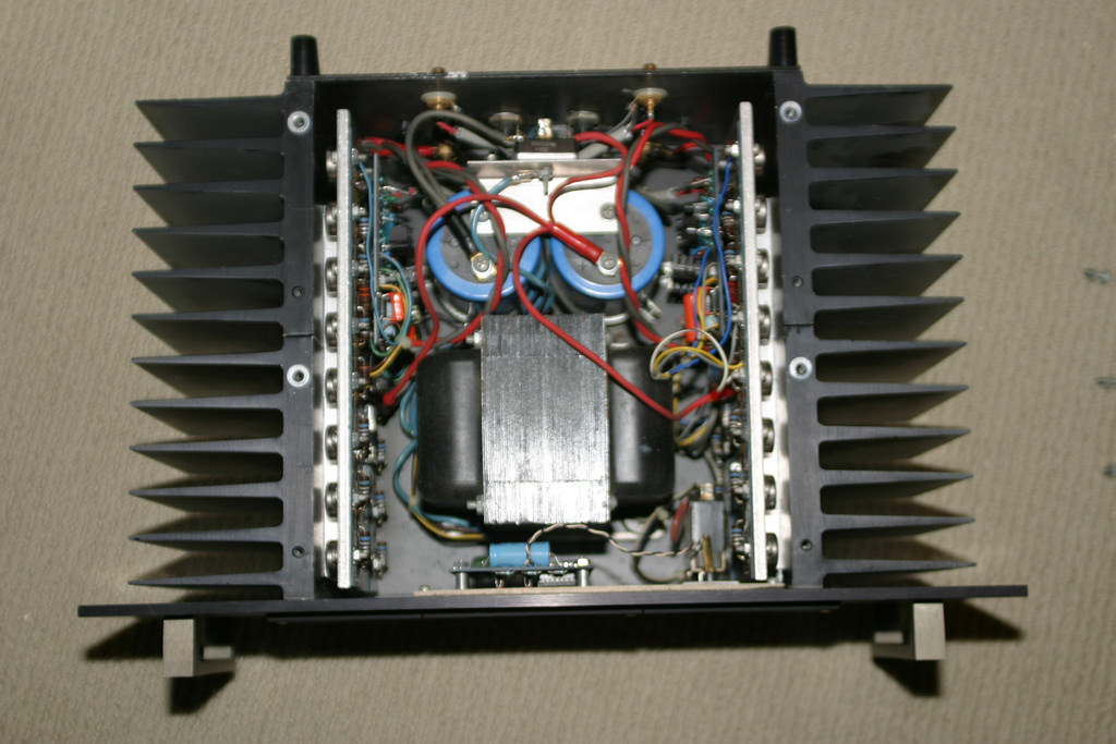

Thresholds Stasis 3 PSU redesign
I am fan of well designed (and well built) PSUs.
The goal is to reduce 60hz (conducted and EM coupled), increase channels separation and provide a big reservoir of current.
Solution1:
I was thinking about moving the PSU (Transformer, rectifier, filter) into a secondary chassis and replacing the capacitor filter with a Pi filter. In this way, only clean(er) DC would enter inside the amplifier chassis.
Solution2:
New chassis + toroidal transformer + Pi filter + voltage regulator.
Is 1 or 2 worth? Am I going crazy with my PSU obsession?

Is this the Stasis 3 in pic?
Why not add more caps in parallel to the 2 main caps in an external enclosure, since there's not much room inside?
Yeah, that's the guy.
I evaluated the idea of adding external caps in parallel, but I am concerned about two main aspects:
1. the stray resistance of the wires wold degrade the performances
2. The AC current flowing trough the wires would generate a lot of EM noise
I'd rather build the whole PSU (transformer, rectifier and filter) into a separate enclosure, so I would gain room and reduce EM inducted noise too. I am quite sure that those red/blue wires are partially concatenated the magnetic flux of the transformer.

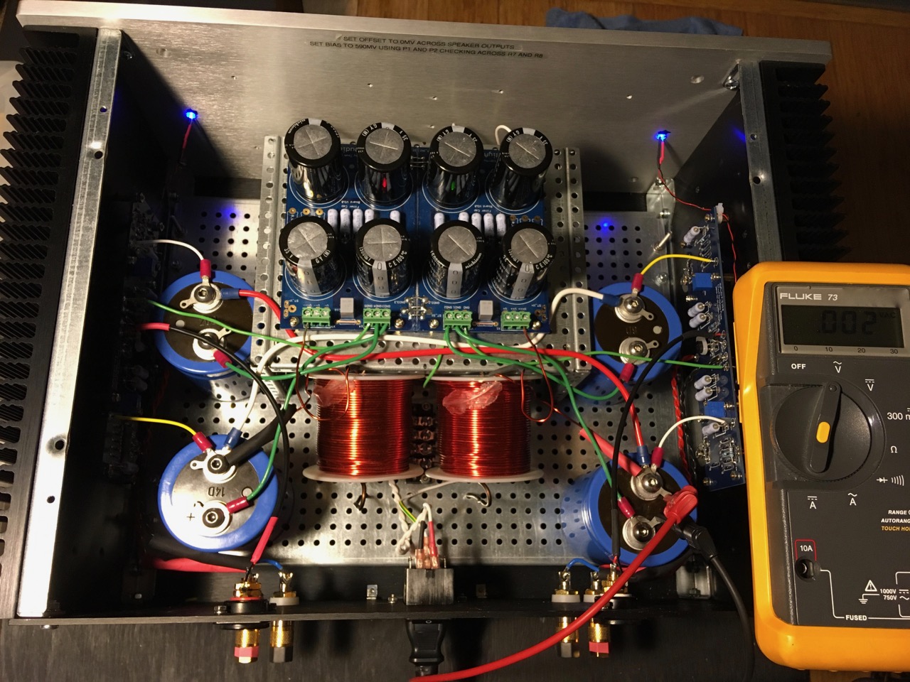

I just added an LC (4mH+ 2x68mF) section to a friend's DIY F5, so it went from 'normal' CRC (30mF-0.1Ohm-30mF) to cRcLCC. Ripple went from 50mV to 2mV (but lost 2VDC at rails). So clean, and now can't go back...
2mV is quite impressive! I am gonna start with a CLC and go from there..I feel quite confident that it'll be quite a good improvement compared to the actual 15mF capacitor only.
I think the Stasis 3 is quite of a fine amplifier with an ok-ish PSU that need improvements.
I am not particularly worried about loosing a few % of voltage at the rails, as long as the ripple is reduced, the channels are well decouple and the rails voltage is stable during the peaks of current.
I guess Papa suggested to install capacity closer to the output transistors in order to improve the slew rate and for decoupling purpose..
