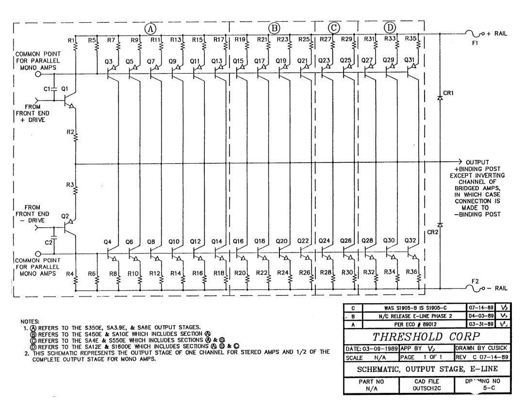

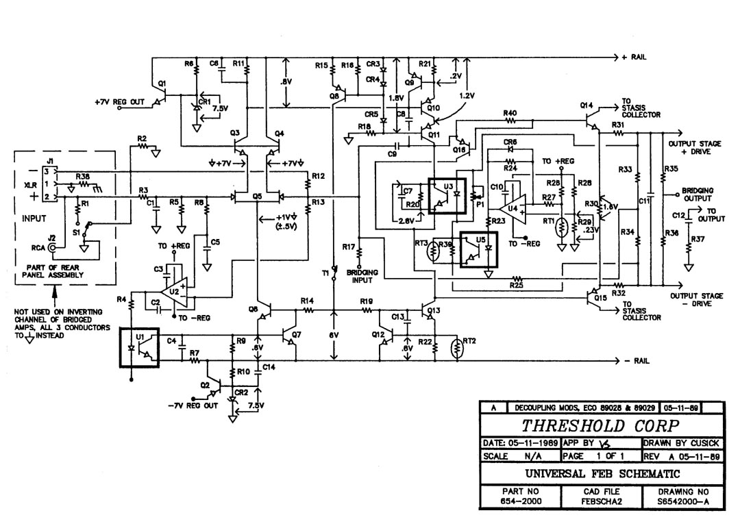

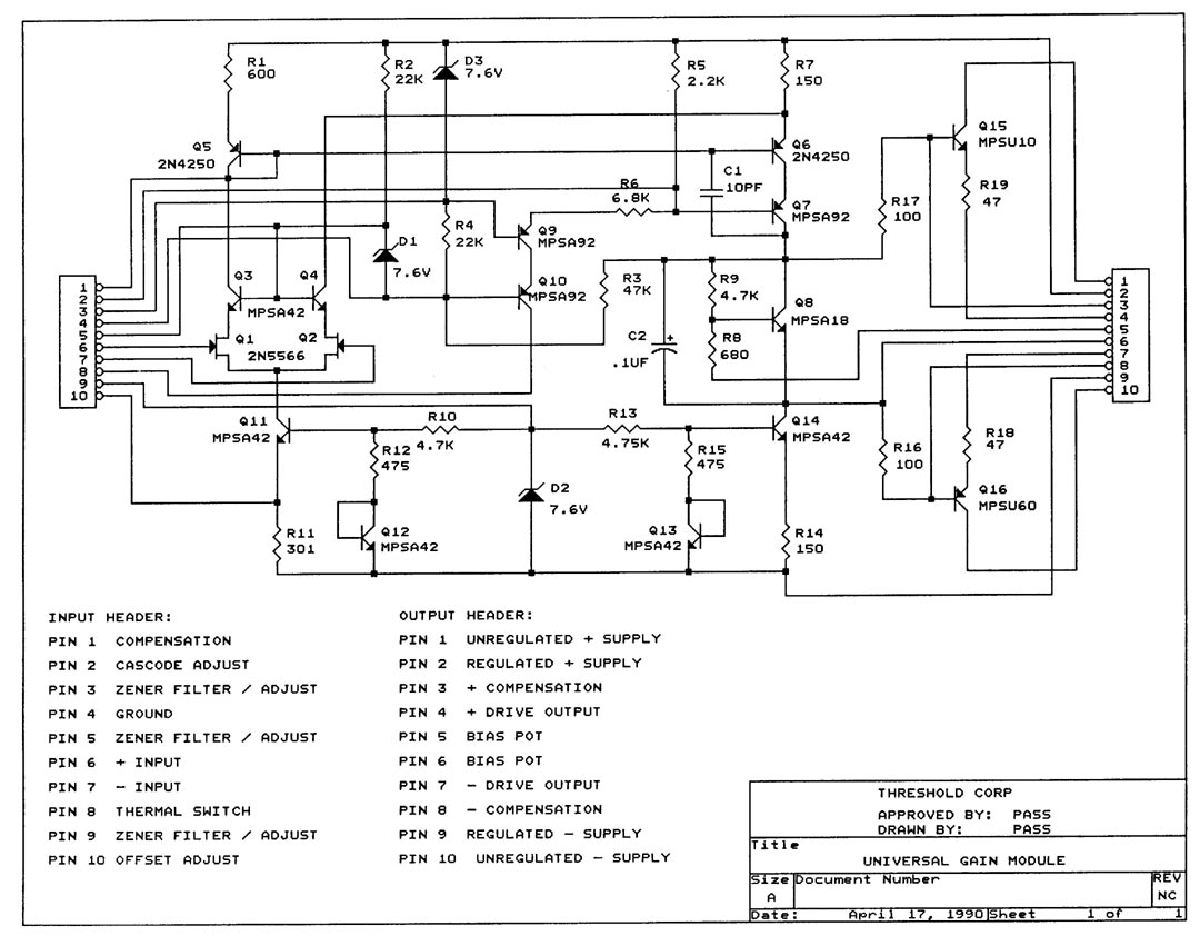

who can help with schematic of Threshold stasis sa-3.9e?
i have an old schematic of stasis 2 & 3, are these a like sa-3.9e?

dear sir,
as said, the one and the only one, you are the nicest person in this field
thanks a lot for the schematics
is a comlex amp, hope i will be able to repair it
