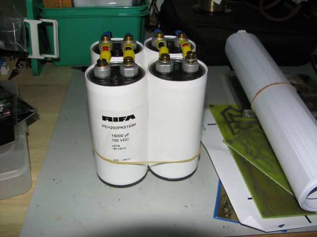

I'm sorry to butt in.. but I have a threshold 400a with 2 9800MFD 100v caps for filters.. any recommendations on replacements? Something readily available and reasonable perhaps? And why does my value seem low to most of your posts here? I cant find this specification on any schematic or I would not ask.
(they are the screw type).
Regarding the original post.. if you cant solder and arent willing to take the time to learn (its easy).. dont touch your amp.. I bet someone on your street can solder.. or just bring it to a tech and spend $$$$..

Barchetta, I wouldnt fiddle with the bias setting if I were you! I would pop in a pair of 100v Rifa's though. I think the 400A used 15.000uF's from the factory and you might just be able to squeeze two of those in there🙂 Funny to see the 9800uF listed!

Okay thanks.. I will look for a Rifa? I take it thats a brand.
By incident (or because I prefer to use nothing else😀 ) I had a few of the Rifa buggers on the table. Yep its the brand and they are swedish. The best are PEH169 but they are nearly impossible to get! The PEH200's are also hard to find, but still possible....😀
They are the best, and the Threshold deserves it😉 Screw terminals to boot at that🙂

Oh those are are so sexy! (Cant believe I just said that!).. lol
Well; if I cant find em' do you know how usefull this is to me? 🙂
I'll start looking.. .. already been to their site.. you saved me a bunch o time by giving me the model #.. thanks.
BTW, those cans look too skinny.. but I could always rig something up.
Not a lot😀 But now you know what to look for😉Well; if I cant find em' do you know how usefull this is to me?
Steen
