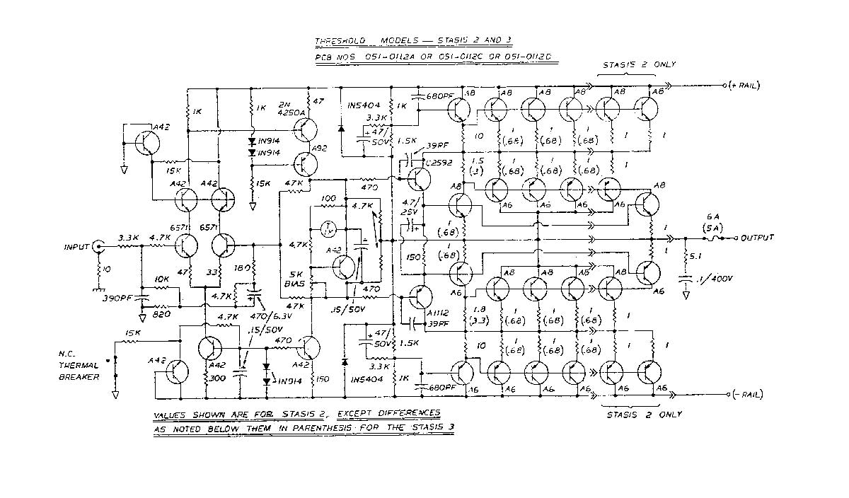

answer is in related brochures
however , Papa can tell you how much it can be biased and what amount of A class you can expect then
OK , that last part anyone can calculate .......
from files enclosed , I can calculate that Iq for Stasis 3 is 3x(75mV/0R68) =around 330mA
so say that we can expect twice that while all output critters are conducting (condition for A class) so 660mA
from P=I^2 x R , for 8R load , that would be 3W5 of pure class A , while rest is AB
entire calculus - counting on fact that current envelope is determining A class region , while voltage aenvelope (rails) are more than sufficient , being determined for AB class amp
conclusion - crank it , to 50C at heatsink , measure what you have across emiter resistors , then calculate what you have ......
