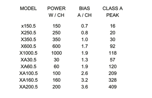

Im going to go with 70 ma's. there's a bais pot and both individual resistors on each transister of 1 ohm as well as a board resister of ten ohms. I can set the board to .7 amps, which directly translates to 70ma's on each transister. .7 is listed for a 150 watt amp. my amps is branded as a 200wpc amp. but as others have suggested, it may actually be less. it runs pretty lke warm at .6 or 60ma's so I have no issues with using .7 or 70ma's. btw, the author of the article I clip the below from, is the designer of the amp.

you know, I was coming back to post a concern. My test speakers say that they are 8 ohms, but you know how that goes. so now I need to understand, what bias should I use at 4 ohms. if the speakers really are 8 ohms, whn I go to 4 ohms, my bias will jump pretty high. According to some white papers I read, it will double. so in theory, I might be frying eggs after all.

the amplifier bias is not affected by the speaker impedance.
Set the bias to a value that minimises the output distortion.
Most ClassAB with EF output stage do this by biasing to a set Vre. The voltage across the emitter resistor of the output device. Usually <=26mVre.
ClassA bias for a push pull output stage is set to half the peak output ClassA current.
If you want 1Apk of ClassA current then total output bias is set to 500mA.
If you want 2.4Apk of ClassA current then total output bias is set to 1.2A.
Note changing the load impedance does not influence the bias setting.

I got sent down this path after reading a paper by Nelson Pass about a DIY class A amp build. His check out steps goes over bias adjustments. He indicates 175ma for 8 ohms and 220ma for 4 ohms. So perhaps only in this particular project was the impedeance a factor.
I'm getting that Nelson Pass designed the Threashold line of amps, so I assumed that the basic bais concept was consistent.

No impedance will not change the bias , it will change when the amp transitions to class a/ab. Do you know what size transformer? very important to know when biasing for Class-A.
Its fairly typical in the marketing world to call Class AB class A.
(In my book optimally biased Class B is class aB).
For pure class A load impedance affects the required bias current.
For Class AB load impedance affects the A to B transition point.

Why is this amp called class A when it obviously isn't?
I notice that quite a bit in the home consumer line. Seen many class A amps with class AB looking internal heat sinks.
I guess if you assume that the average consumner probally runs less than 15 watts during normal listening, then manufactuers are comfortable calling their amps class A, if the amp can produce 10% of it's power in class A mode.
I think, from all the info exchanges about this, if you don't have any tech data, the best bet would be to bias the board as a very warm class AB.
.7 at the board bias resister or 70ma at each transister bias resister is working pretty well.
