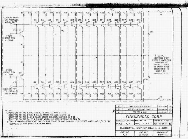

I would like to know why the "Output Stage" of Threshold SA, use the "C" output instead of "E" ?
Pls see the attachment !
Thanks !
