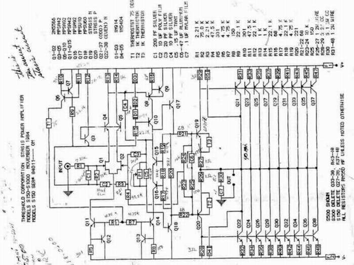

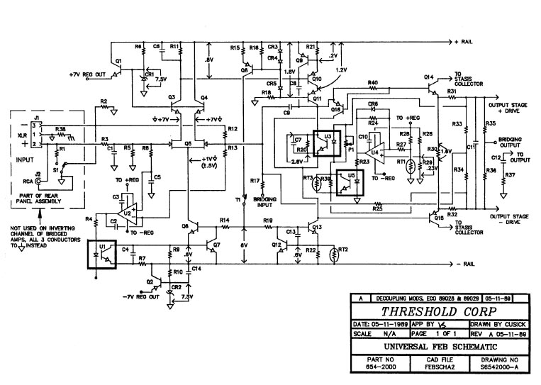

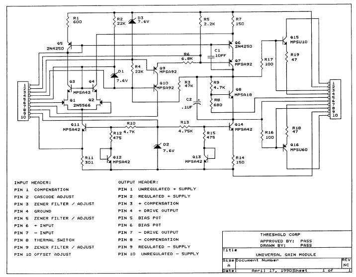

Attached are the last sets of front end schematics. FE89 saw production,
FE90 represents some improvements to that. As to how you alter your
existing circuits to implement this is a DIY project.

Dear mr Pass, thank you for the fast reply and schemes!Would you happen to have this scheme also for my production line which uses the front end board with single ended input only and optical bias, I suppose 1987 production run? thank you!
I would leave it as it is.
You have already the last SA/2 Series 'optical bias'.
The only thing you could consider is an update of the electrolytics.
I would not tamper with a 'Nelson Pass' Original.

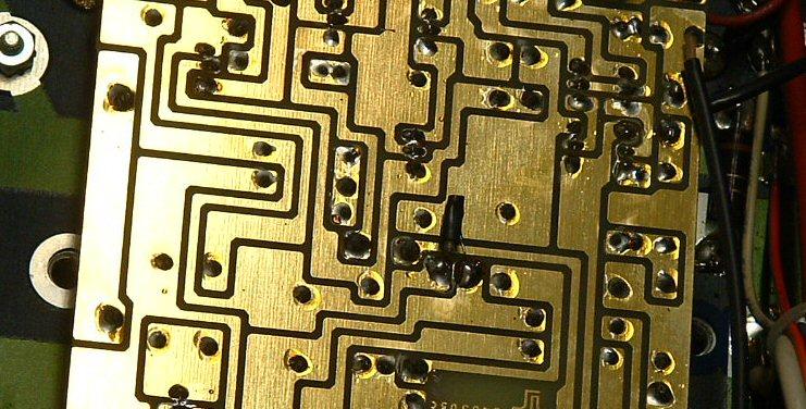

unknown frontend
Hello all,
recently got a S/500. It had DC offset 3 V in one channel and distortions at higher levels.
Found defective device 2N5566. Have ordered replacement already, hope it will work...
I noticed that these both previously posted schematics (Thanks, Nelson!) doesn't match with the PCB in my S/500. A matching schematic would have been very helpful. So I had to find the defective device by swapping with the good channel...
Does anybody (Nelson?) have knowledge of this specific version? Seems to be an early version (or stripped down)?

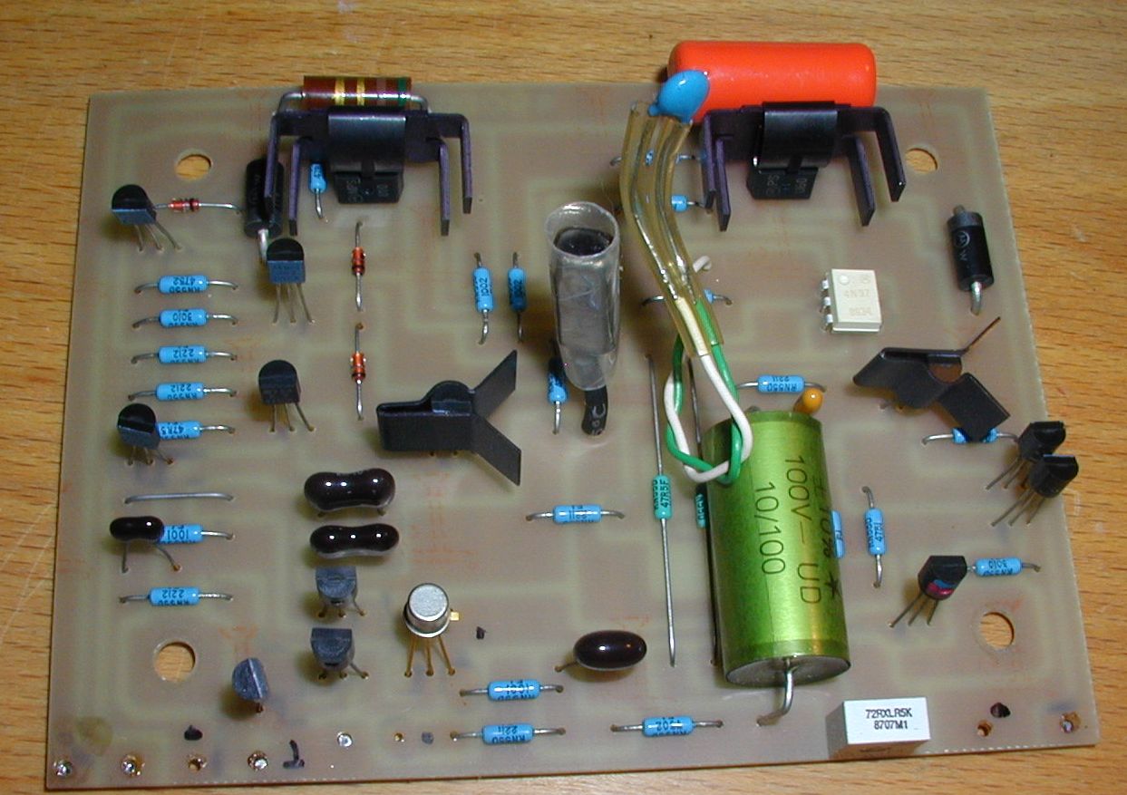

Here is a picture:
Hello Nelson,
thanks for the quick reply!
The schematic doesn't match, unfortunately. On the other hand it was pretty helpful as it's similar, input stage is identical (I suppose..).
The board has an opto coupler 4N37 plus one transistor PN 4250A not contained in the drawing and I can see only one thermistor.
Any idea?
Cheers, Gerhard

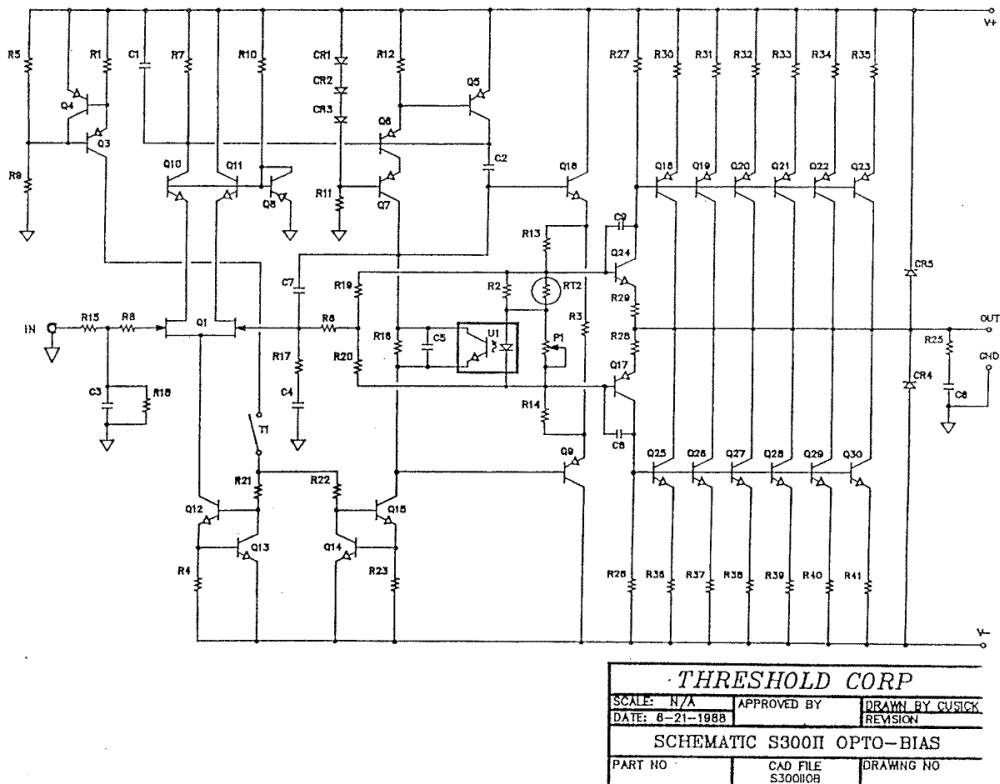

It looks like the optical bias version to me because there's a blue thermister that pokes into your heatsink. The black one is for the thermal shutdown provision.
The last Schematic Nelson supplied is from the Series II versions.
The first one he supplied is the most correct one because it has the IC's and thermistors on them.

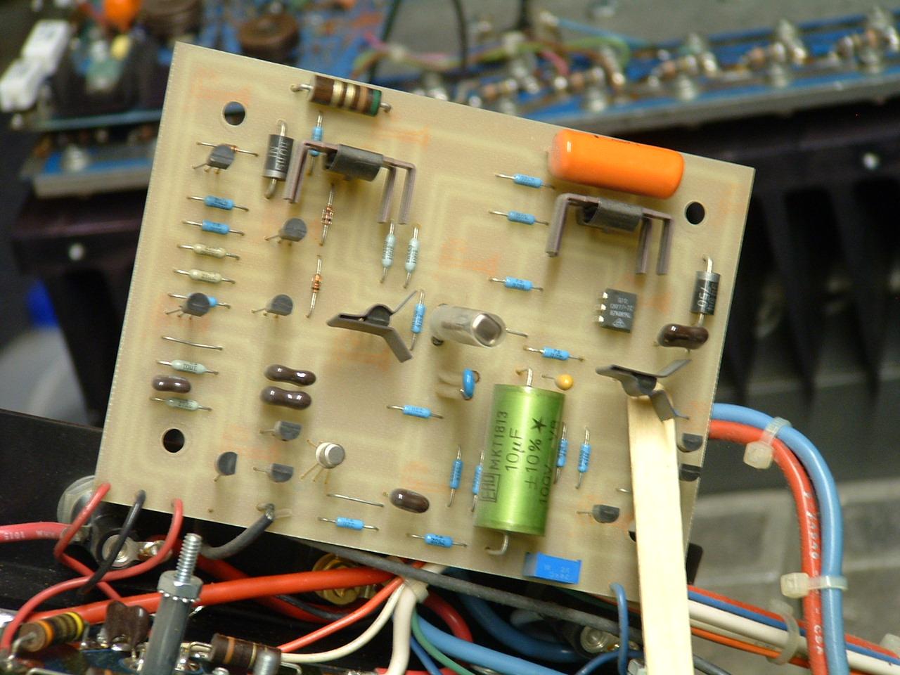

I will also attach a frontendboard from a SA/1 optical bias version which seems the same to me as your version.

Hi SL10
This must be the right one:
It's a drawing from a S/300 but the frontend is the same as all the SA and S Series with optical bias before the 'E' series of 1989.
