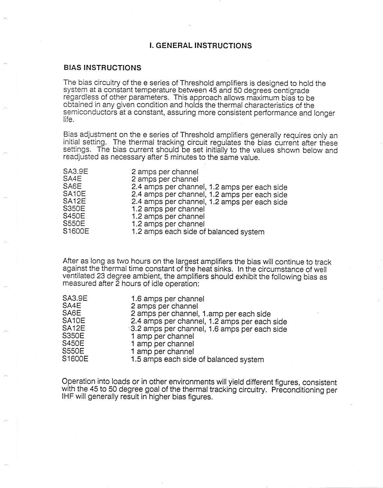

I've pick up a pair of Threshold SA/12e mono blocks which will arrive next week. My plan was to listen to them for a while and then decide if they could us any sort of tune up / rebuild as they are all original from 1992. After contemplating their weight and where they will rest (not on dollies, but on shelves), I'm wondering if there are some basics I should consider before getting a friend or 2 to get them where I want them?
-Power supply caps?
-Caps on FEB?
-I remember years ago when I was tinkering with Sansui equipment, they had issues with what everyone called "Black Caps" that were prone to failures. Anything like that on these amps I'd want to address sooner rather than later?
-Any advice would be appreciated ... and might save me a trip to the Chiropractor down the line!

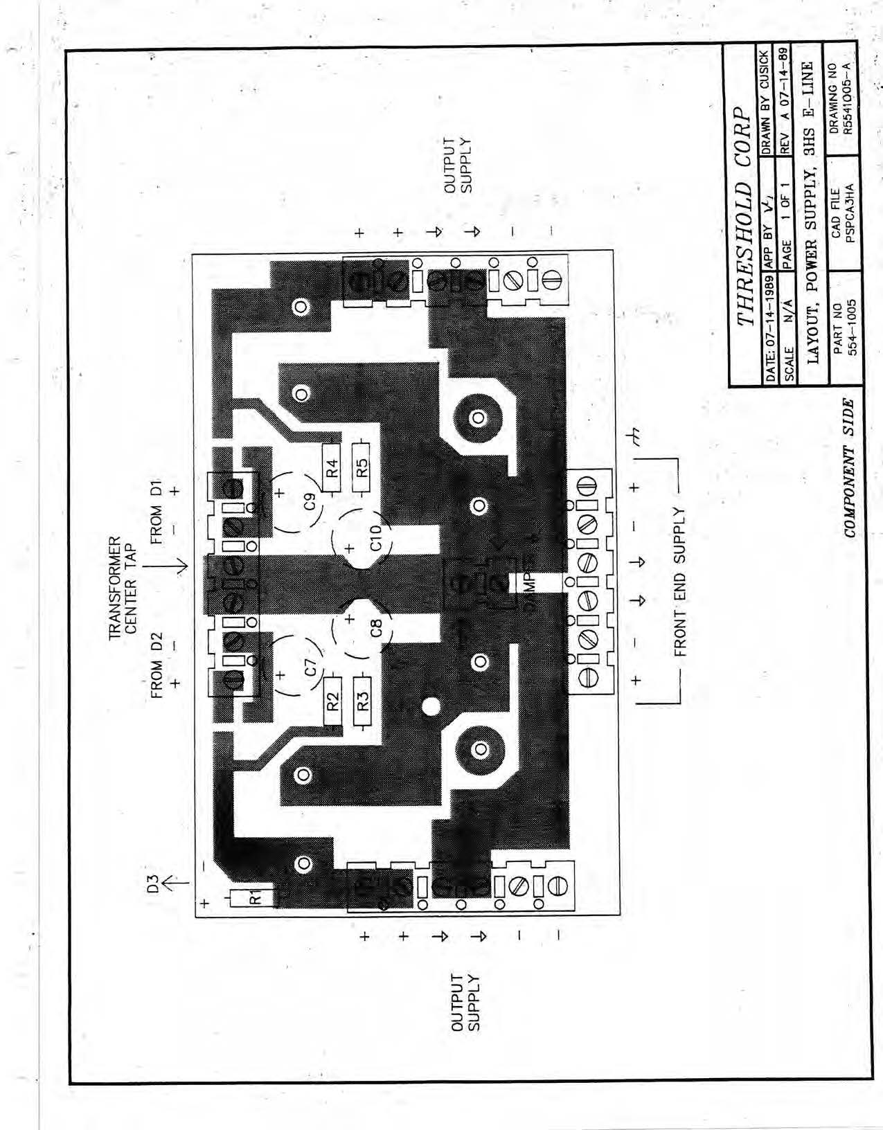

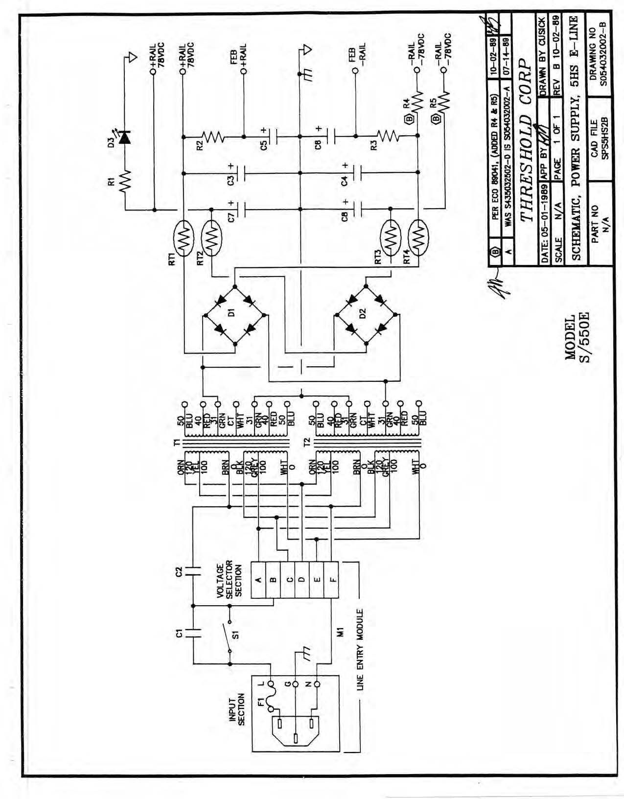

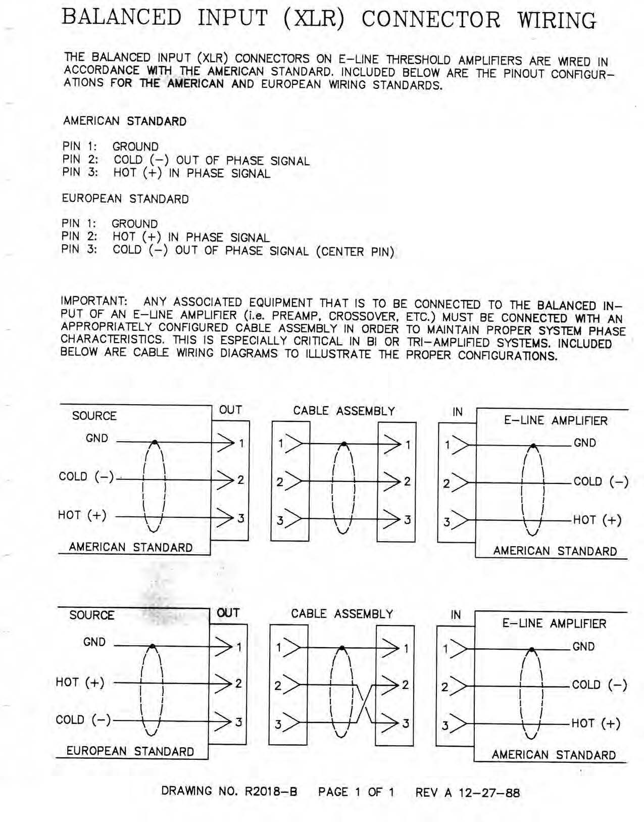

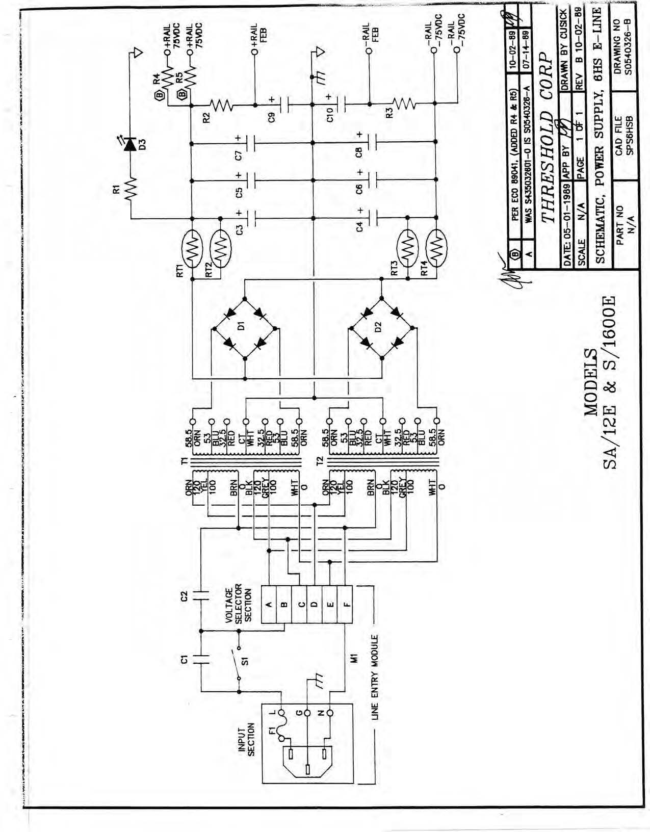

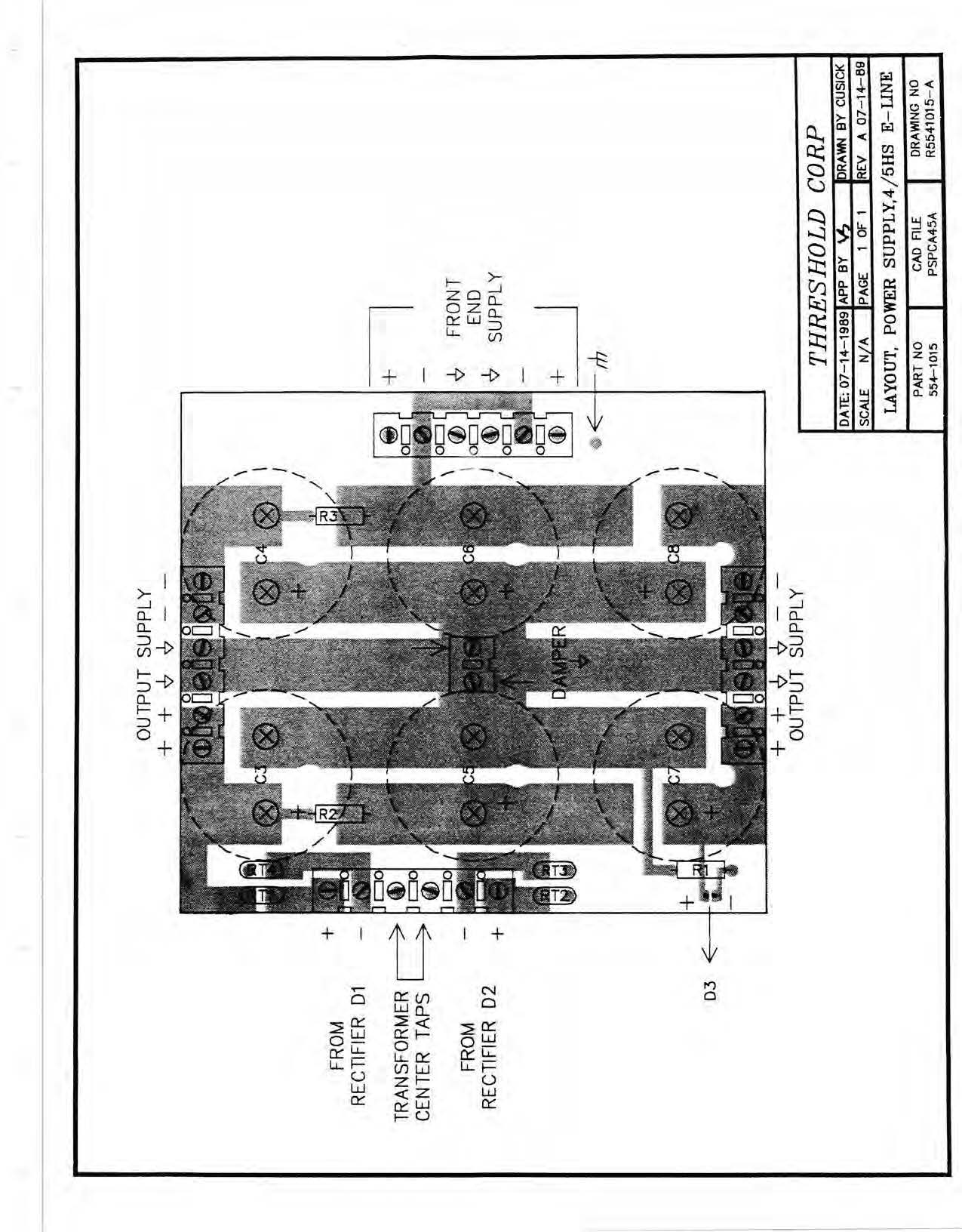

Thanks. I got them the other day and took the tops off to give them a good blow with compressed air to rid them of dust. I also took lots of pictures and decided to put them to use before fooling with them. I nice little bonus that came with them was 2 copies of the Service Manuals for the S/350e all the way to S/1600e and SA/3.9e to SA/12e. It lists values for all parts as well. I've been going over the schematics.
If the SA/12e is a Parallel amp design, would the S/1600 be a bridged design using the same internals as the 12e but with 2 FEBs?

fell free to do that ..... Treshold schmtcs are routinelly posted here , same as on my blog treshold | Search Results | Zen Mod Blog

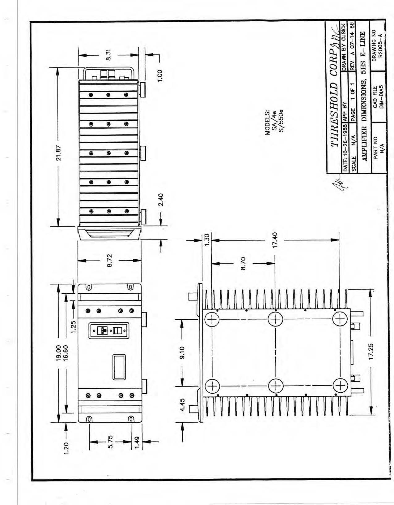

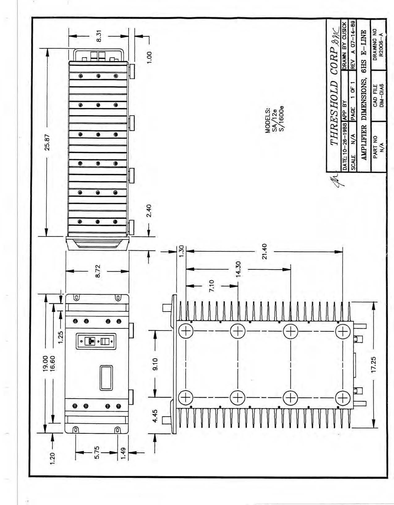

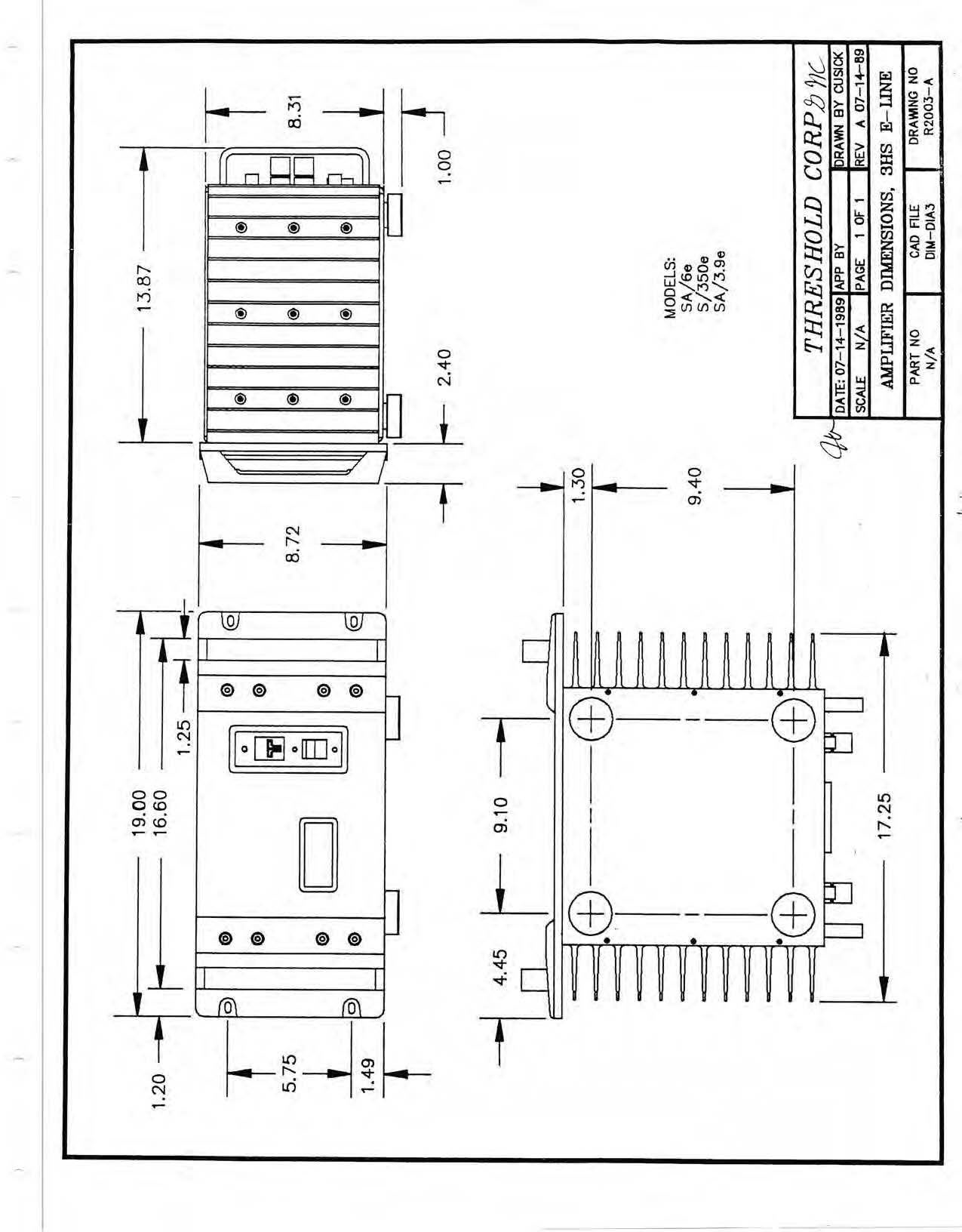

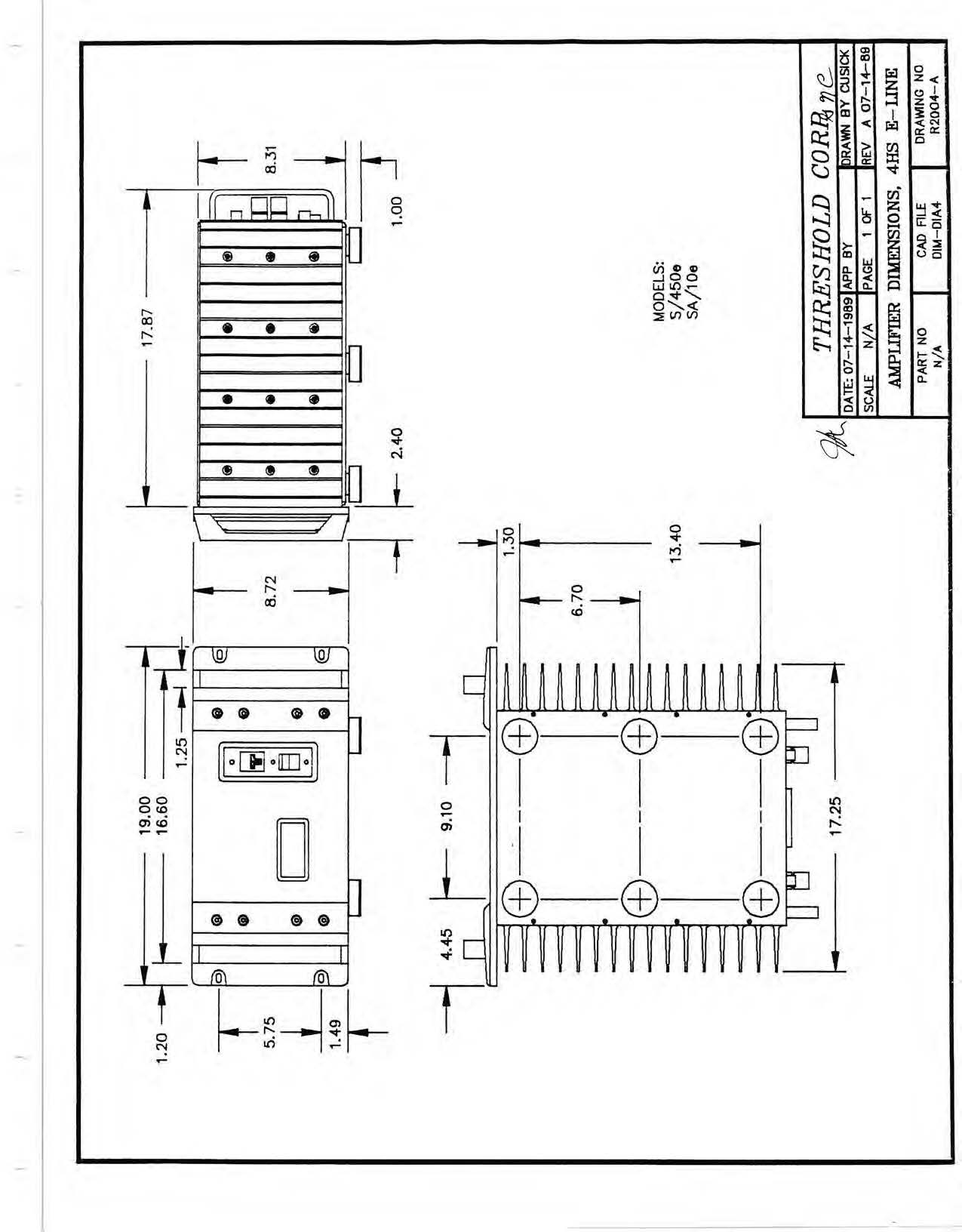

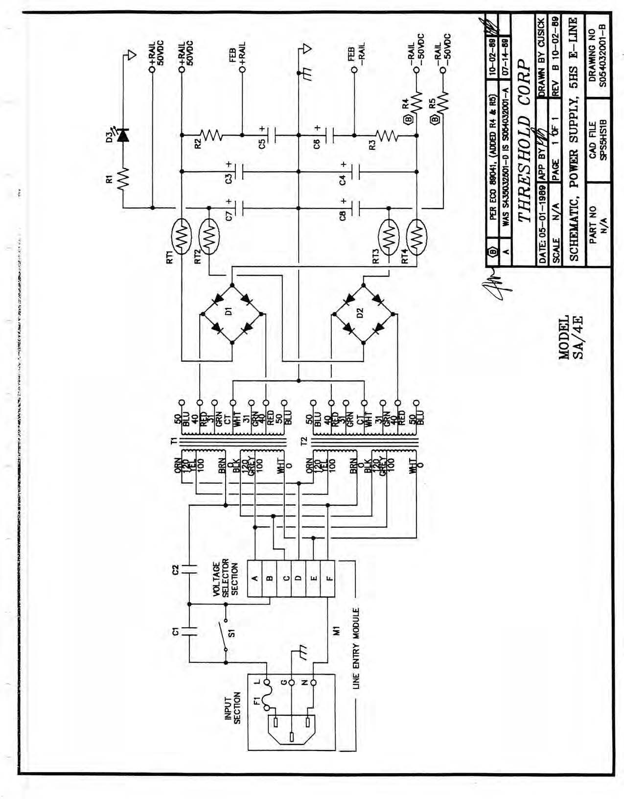

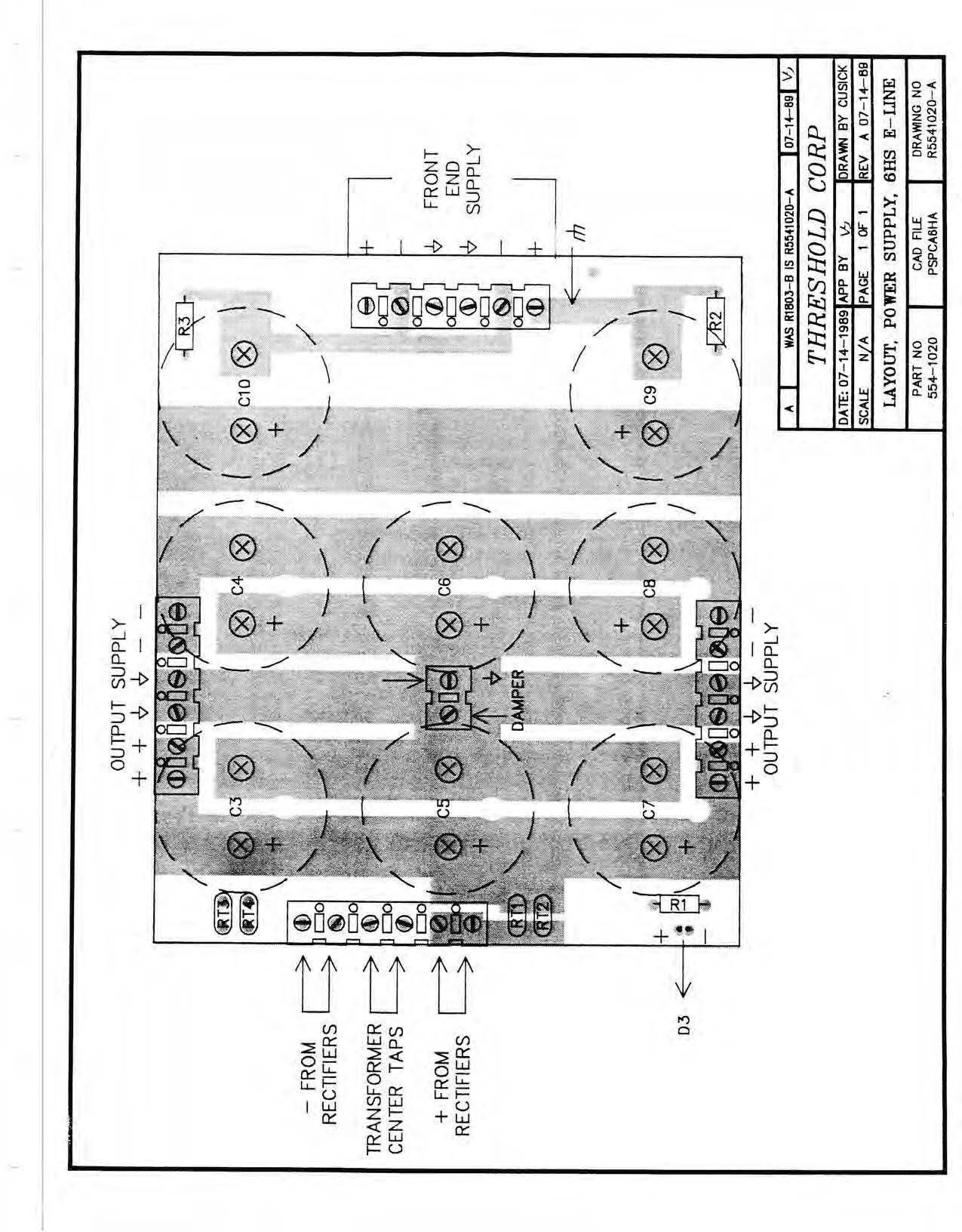

Shrunk PDF and converted to JPG and am posting 10 pages at a time .....

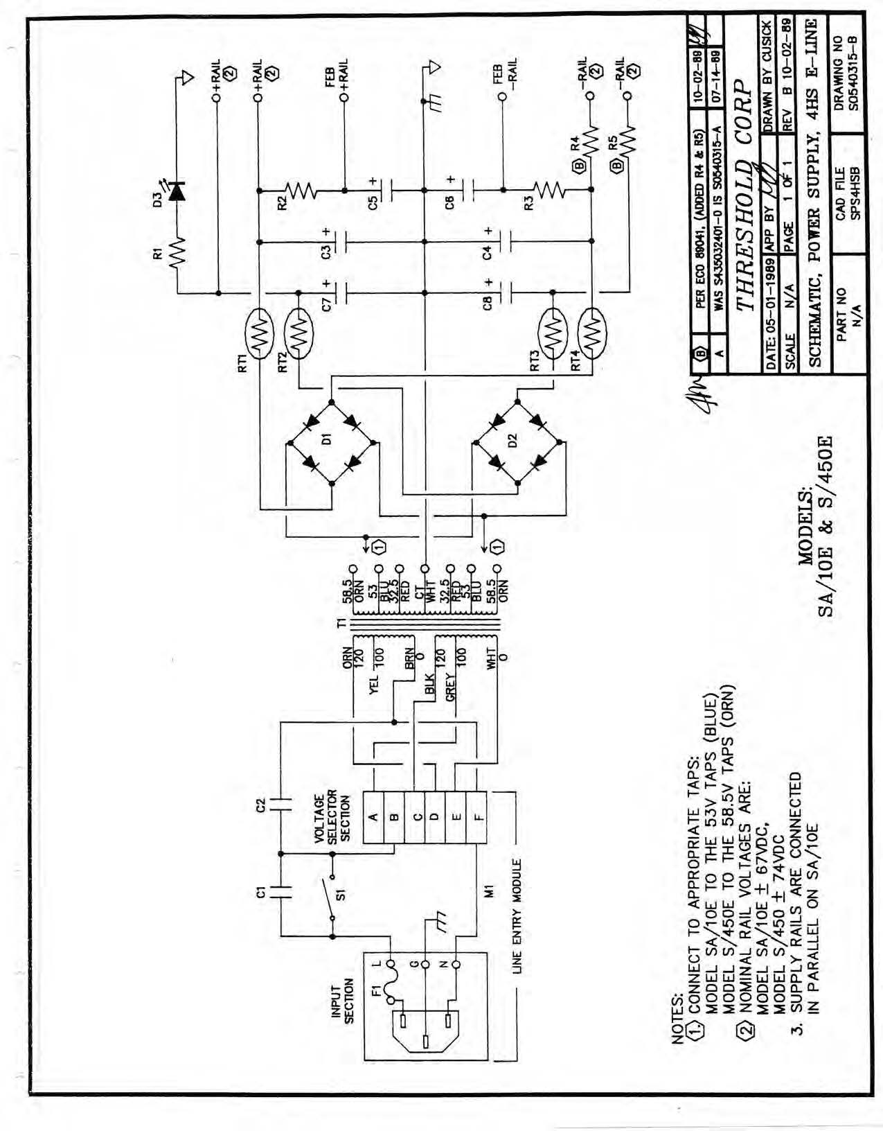

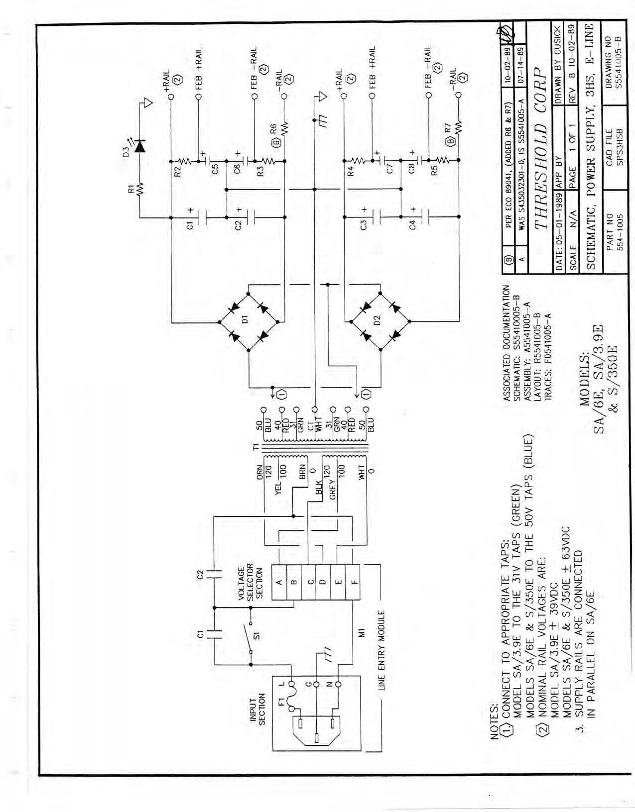

11 to 20

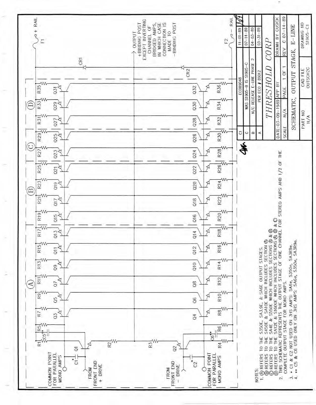

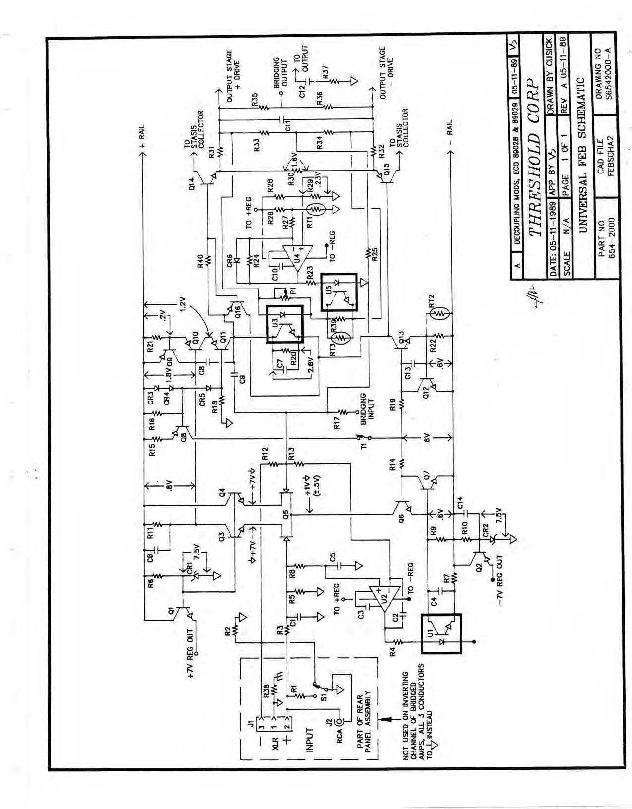

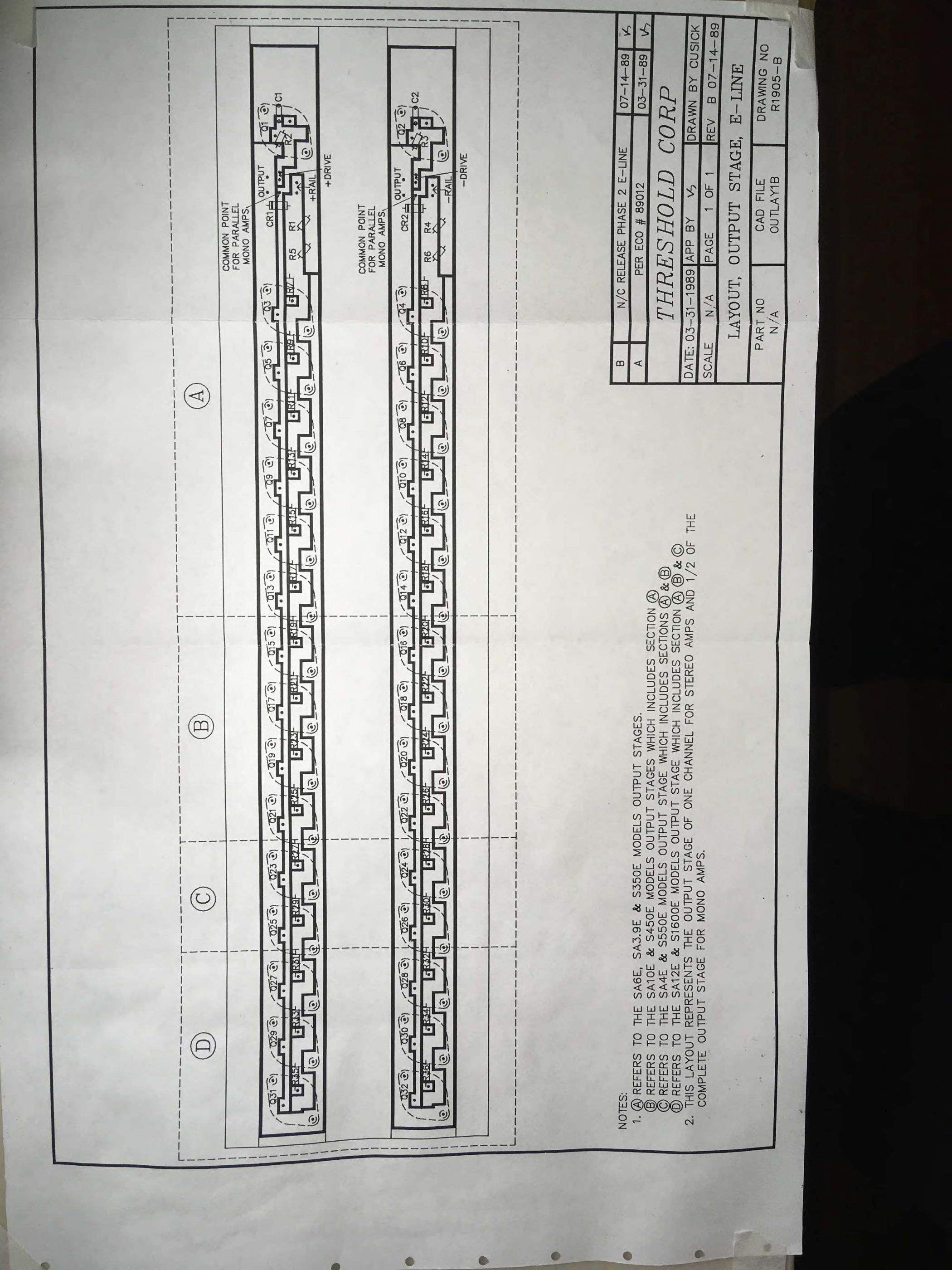

Dear forum members, first of all thanks to the mods for reopening this thread. i studied the contributed schematics of the SA12/e, i'm dreaming about this amps since years. now to my question, its about the wiring connection of the FEB to the output stage. Drive and rail is marked on both schematics, but what's about "to stasis collector", i can't find the counterpart on the output stage. may be someone can help. sorry for my english, it's not my mother tongue. A few words about myself, i'm a hifi enthusiast since many years, now retired and living in Thailand, other interrest aside of music and hifi, vintage cars and electronic selfmade projects. Kind regards Peter

thanks for your reply, i've read the whiole trhead you mentioned but could not find an answer, just found out that others had the same question. using the search function i found the same question in a very old thread too, unfortunately no asnswer. seems to be a mysterium
