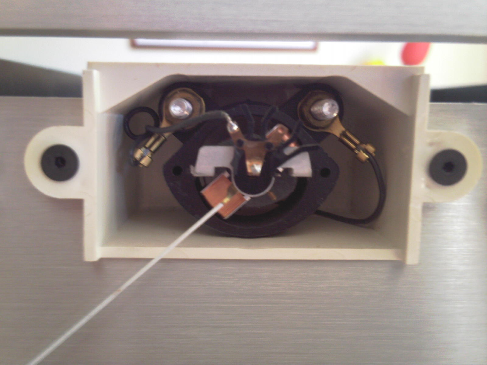

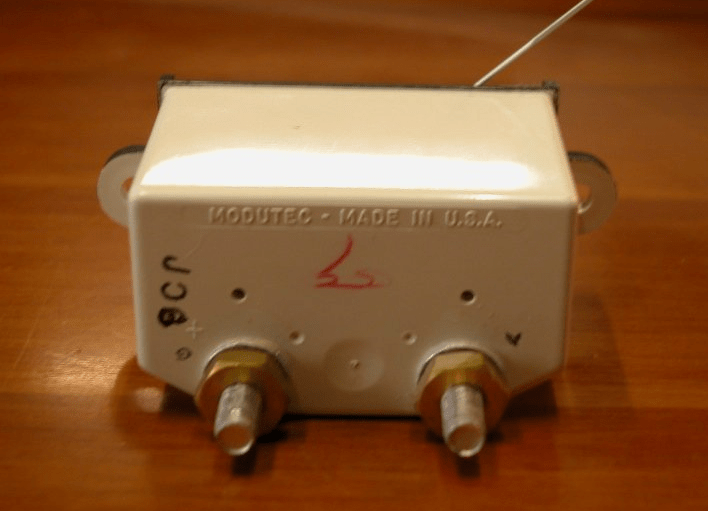

Many years ago I replace a broken stasis 1 meter.
I disassembled a Modutec 4S from its round case and place it in a Modutec "L" or "V"case (the same used by Stasis) with excellents results.
It fits perfectly.
The meter is a 4" DC 1mA.
The modutec/jewell was a 4SDMA001
So I replaced the broken stasis 1 meter. The needle is black (the white one was custom made) but at least it works.

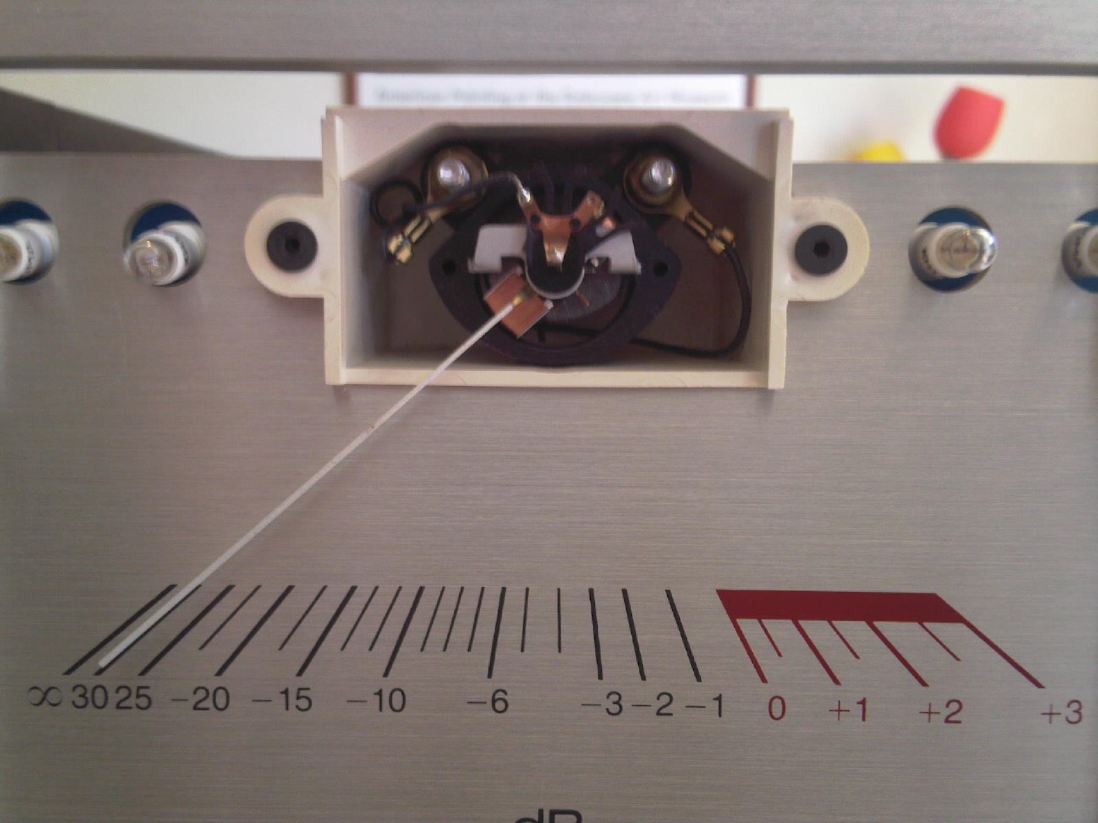

The problem with the SA is that the meter is a custom series and moves from Right to Left and not Left to Right
It fits perfectly.

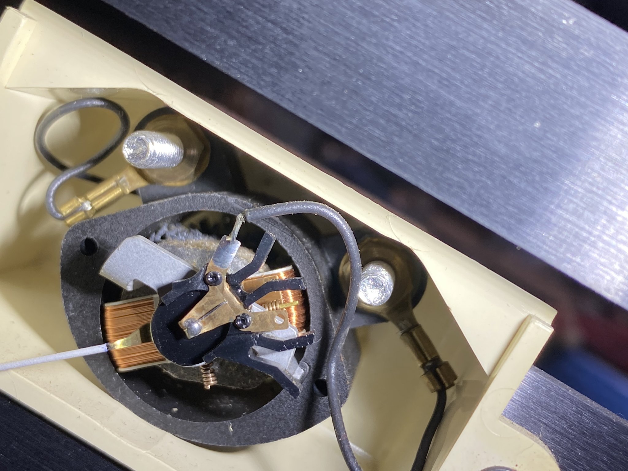

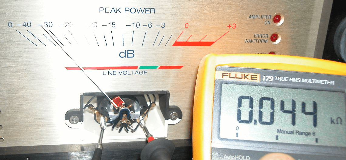

I've got a black and a silver set of SA/1's and one meter of the four gives a much lower reading as the others.
At first I thought it was static due to the perspex cover in front being static pulling the meter to the left corner but after spraying some ant-static spray as I did with my S/1000's I once owned where it helped, it did not in this case.
This afternoon I measured the Ohmic values with the two leads to the Modutec case removed and the one with the lower wattage/dB readings measured at the leads (so not the meter itself) was significant higher as the other three. So probably a resistor gone bad on the accompanying PCB where the 4 lightbulbs are also in.

Maybe the adjustment screw is on the back?

I think the front measure you have done is useless with meter connected to pcb.
more resistence = minor amperage so your meter moves slowly.
To make sure your meter is not bad you need to disconnect it and apply to it 1mA DC current.
You can use AA 1.5V battery with 5k or more potentiometer connected in series.
You start with highest resistence and slowly decrease till you reach the end of meter scale (+3db) .
You can also use a voltmeter to check the amperage directly or check the final resistence of the pot applying the ohm law: 1.50V/0.001mA = 1500ohm.
if you measure about 1mA or the pot is 1.5k then your meter is ok and you need to look to the pcb.
Don't apply 1.5V directly to the meter, you risk to burn it.
There's no adjustment screw on the back. Only small zero adjustment could be done rotating the plastic "spider" in the front.

Thanks for your broad answer, Very well appreciated.
I did measure resistance with the meterleads disconnected from the PCB.
Three of the four meterboards measured the same 15 Ohms and one 23 Ohms.
That's why I think a resistor on that particular PCB has gone bad.
