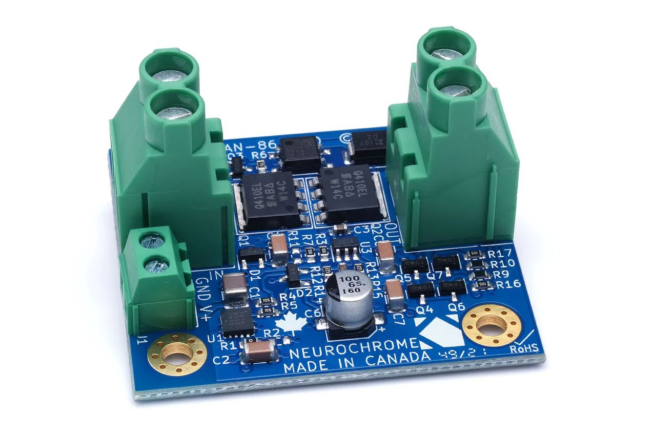

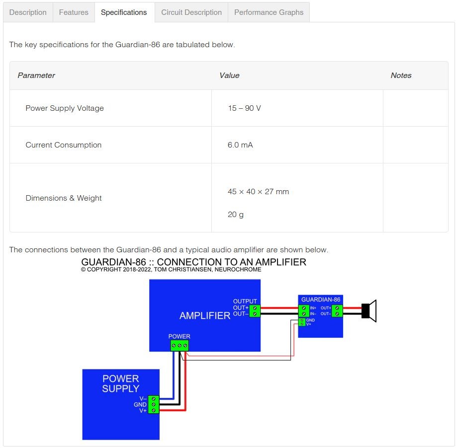

Apart from the awkward mistake I made to address a well regarded former member that has passed away, I still wonder if a DC protectioncircuit like this Canadian made Guardian-86 module: https://neurochrome.com/products/guardian-86
would be beneficial for my Threshold SA/1 also in due of the 35 years of service they already have?

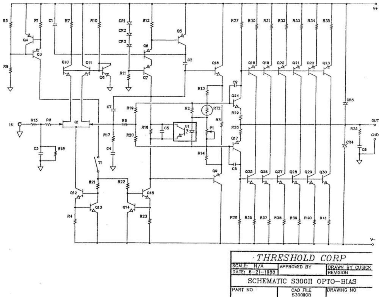

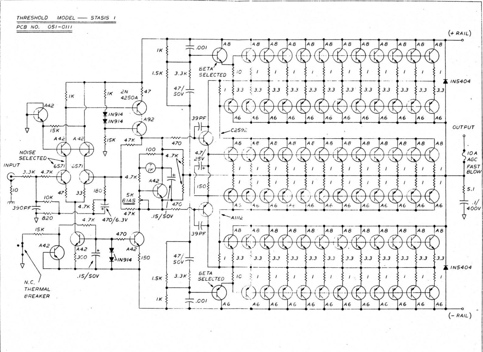

Interesting, do you know what are the main design differences between SA series and older Statis 1s/e ?Hi Karl,

also what’s are the differences between SA1es and SA1s? Only the balance section?
Usually it’s suggested not to use additional protection circuit as it “could“ affect the music itself, but apart from that if you are concerned about the speakers it’s not bad to implement it. I would always stick to the process of turning on sources first and the power amp last and vice versa for turning everything off by starting from the powers, also stick to volume at min for the preamp, this would put away the risk of damaging the speakers. And never remove any cable in the chain while the system is on, even when pre is at min volume while turned on.Apart from the awkward mistake I made to address a well regarded former member that has passed away, I still wonder if a DC protectioncircuit like this Canadian made Guardian-86 module: https://neurochrome.com/products/guardian-86

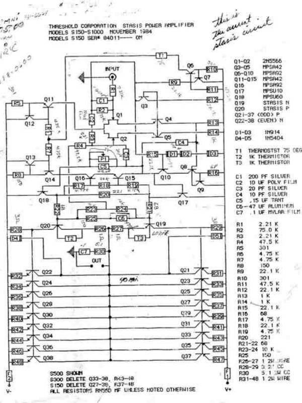

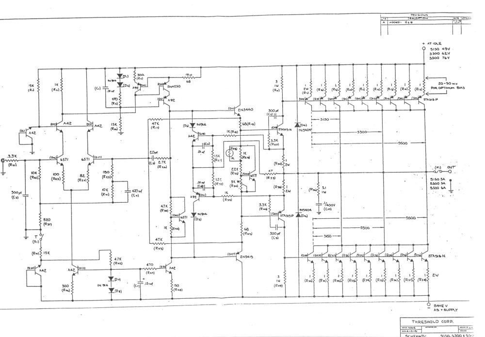

I believe that the frontend of the Stasis 1, 2 & 3 had an extra amplifierstage compared to the later versions.Interesting, do you know what are the main design differences between SA series and older Statis 1s/e ?
'e' series for the SA/1 meant balanced provision with a switch to choose balanced XLR input or RCA.

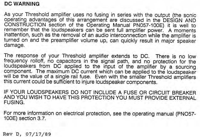

That's of course standard practice but it won't help if your amp has an internal misfunction and puts out 40 Volts of DC on its speakerterminals...Usually it’s suggested not to use additional protection circuit as it “could“ affect the music itself, but apart from that if you are concerned about the speakers it’s not bad to implement it. I would always stick to the process of turning on sources first and the power amp last and vice versa for turning everything off by starting from the powers, also stick to volume at min for the preamp, this would put away the risk of damaging the speakers. And never remove any cable in the chain while the system is on, even when pre is at min volume while turned on.
Threshold did not write this warning in CAPITALS for nothing I reckon.
