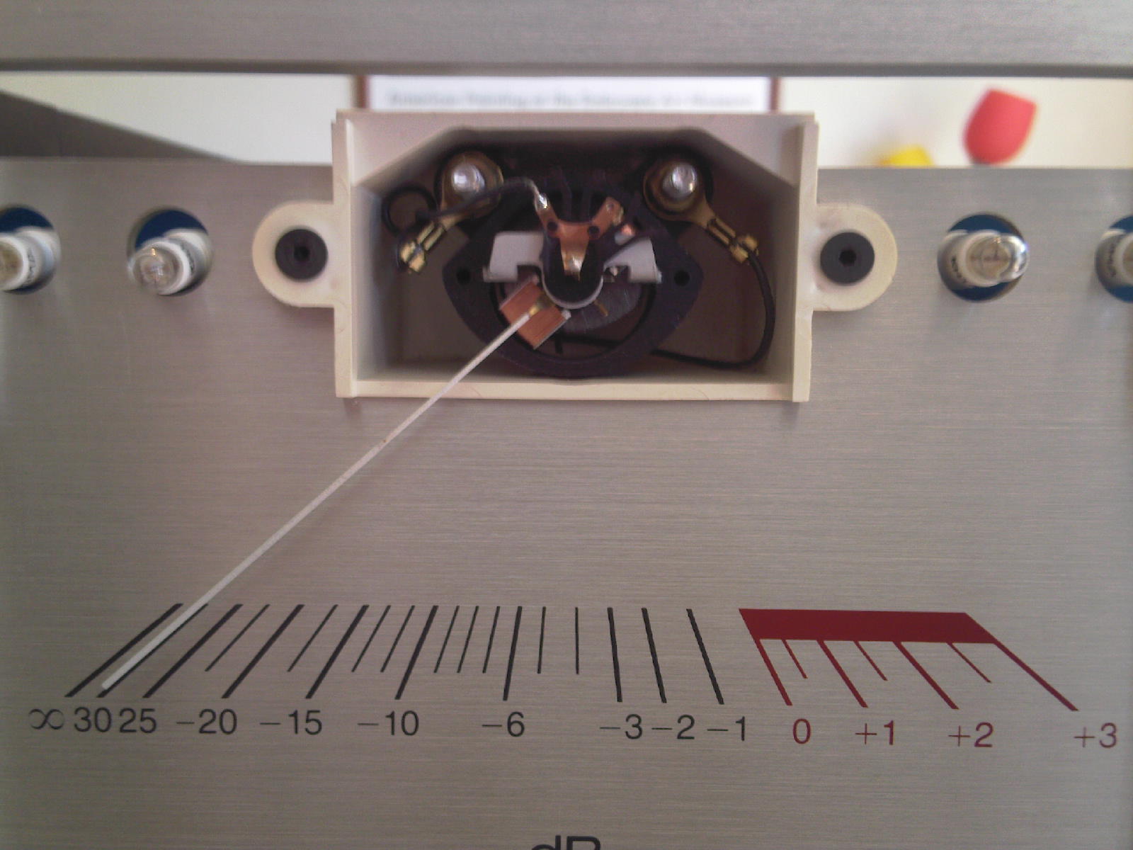

Have the S/1000 Series II. One of the monoblocks VU meter failed. Anyone got an idea on how i can fix it ?
Apart from replacement, some of the failed meters have been found to simply
be rubbing against either the window or the plate, so you might check for that.
