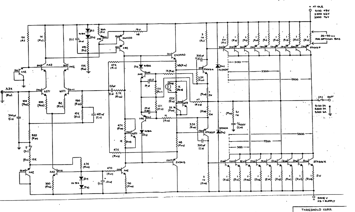

post pictures
also , use some graphical editor (with file I'm attaching again) , and do some measurements and write them down , either clearly as text or clearly in schmtc itself
as you can see from schematic , Iq you measured is in specs
check function of S1 on board
The S/500 I purchased had low or no gain in one channel.
Of course I knew the electro caps were past their life, and that the
tantalums were risky.
When I replaced the 420uf (470?) electro cap the gain was back. Subsequent testing of the old cap showed it was dead. The 420uf (470?) on the still working channel tested OK. (replaced anyway of course). Then replaced the tants with film.
I would start there, get it working and then worry about the bias - Unless it's too high right now!

Mpmarino, thank you so much for your valuable hint, it seems that I have similar issue, as soon as possible I'll check those damn tantalums with the hope this fix the issue. My serial number says that my S500 II was built in 1986 so can't actually complain if sometingh start to show its age.
Luckly I'm able to replace them on my own, any suggestion about the best replacement I can use for these caps?
I read the above as it was the 420/470 uF e-cap that was the real problem so you should probably re-cap both types (e-caps and tantalums) so be sure amp will run without problems for the years to come…….

Mpmarino, just checked my caps, tantalums and some e-caps found dead!
Now I'm in the process to find the best caps on the market to replace them and bring back my S500 to life.
