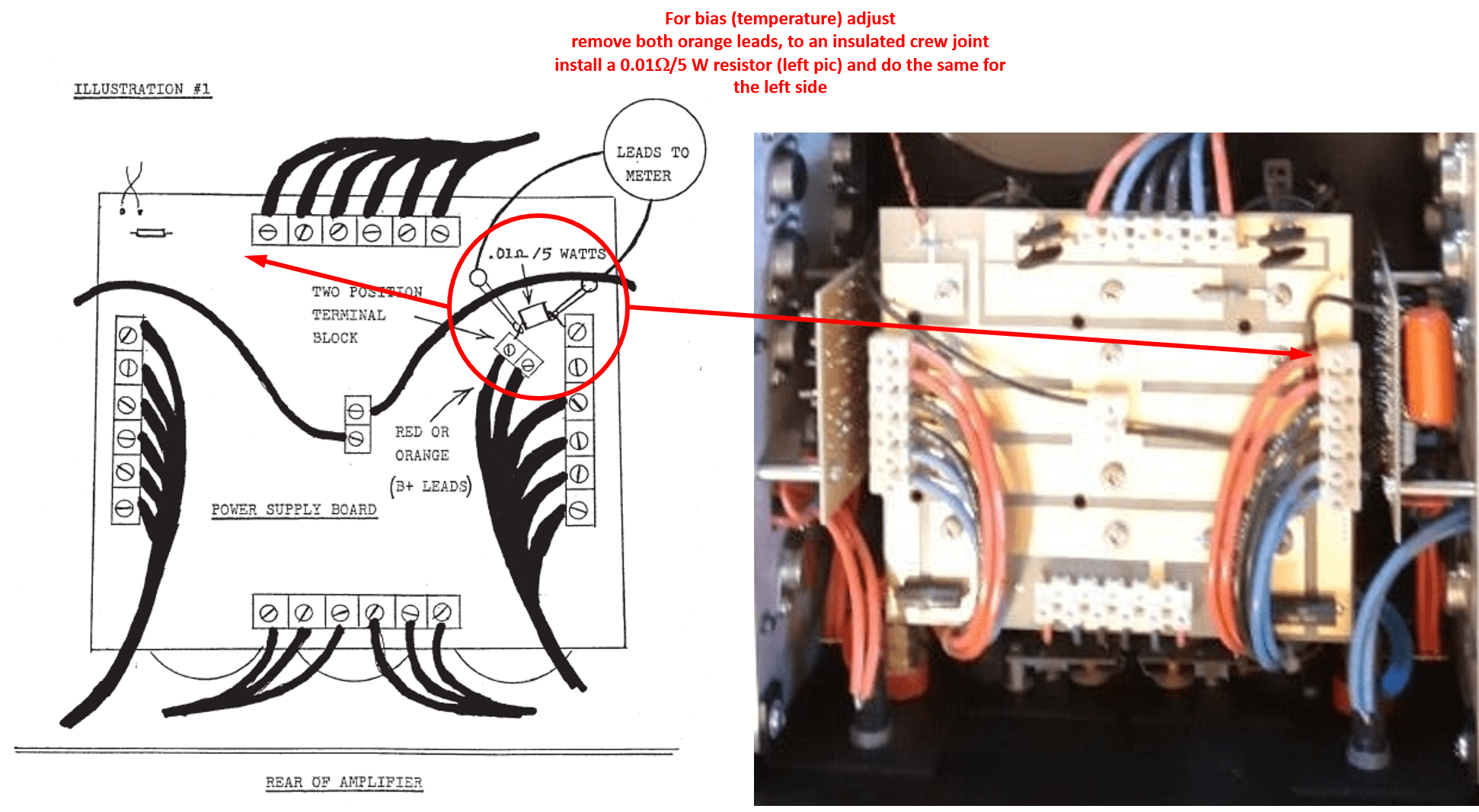

Looking back through my Threshold info, the biasing info is as follows when measuring the B+ DC rail current, using a 0.01ohm 5 watt resistor in series - measuring DCV across that and applying ohms law. Obviously you could divide that DC rail current by the number of output transistors in the pos leg and measure that corresponding mV value across the OP transistor emitter resistors. I do not have any info on what the DC rail volts was for each model - maybe Zen Mod might have that info for you.
S/550e = 1.2 amps DC with a final heatsink temp of 49 deg C
SA/4e = 2.1 amps DC with a final hestsink temp of 49 deg C
I believe both models had 12 OP transistors per rail - so the S/550e would be running at 100mA per device and the SA/4e would be running at 175mA per device.
As Nelson has said in the past, adjust bias to get 50 deg C on the heastsink with the lid on after an hour or more.

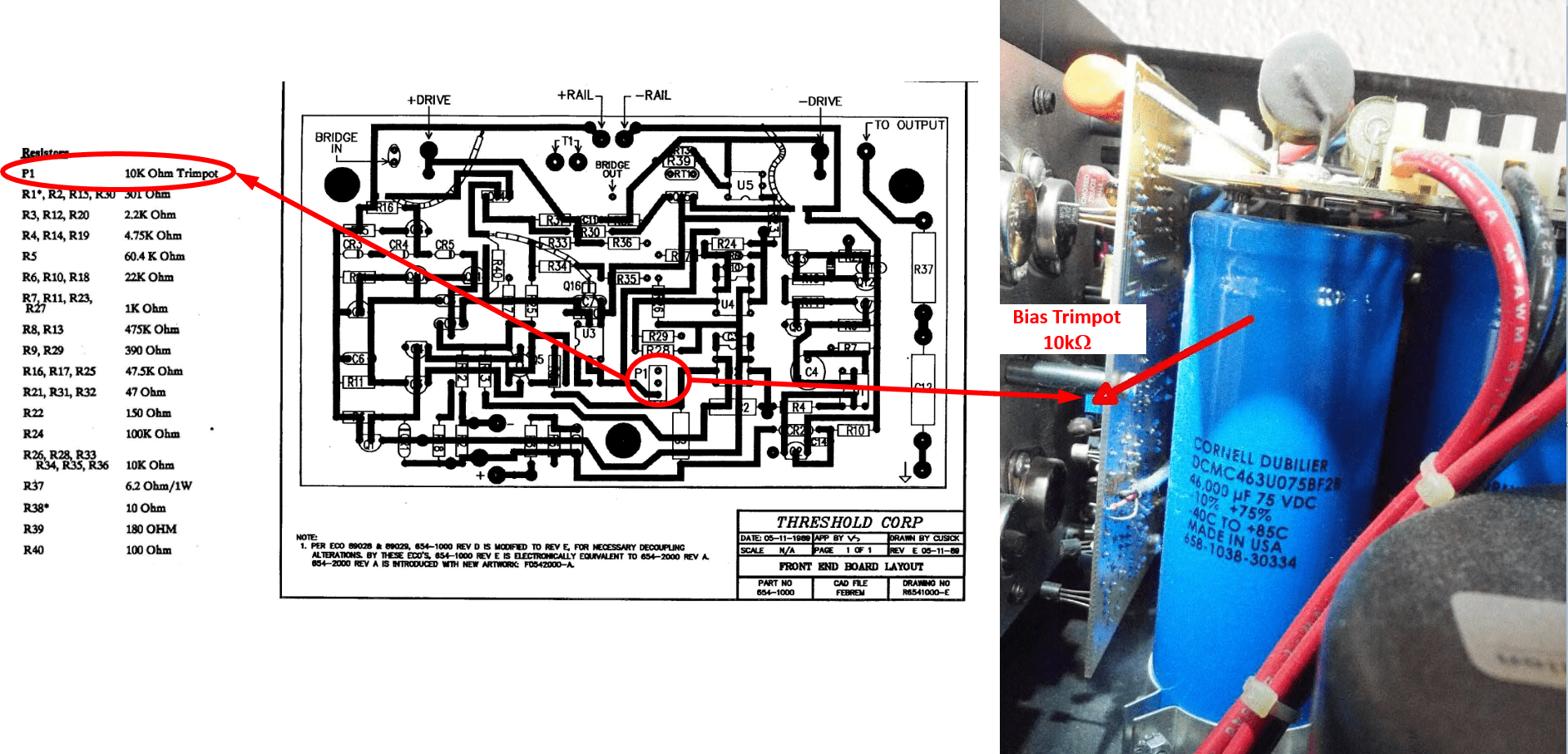

If you post the schematic of your front end board, there will be a trim pot that you carefully adjust to adjust the bias while looking at the mV across the resistors. You need to do this with the lid on and monitor the bias as it warms up. You should also make sure the ultimate bias point gives you a max temp on the heatsinks at 50 deg C. Do each channel at a time.

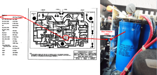

Hello Garry,
thanks a lot again.

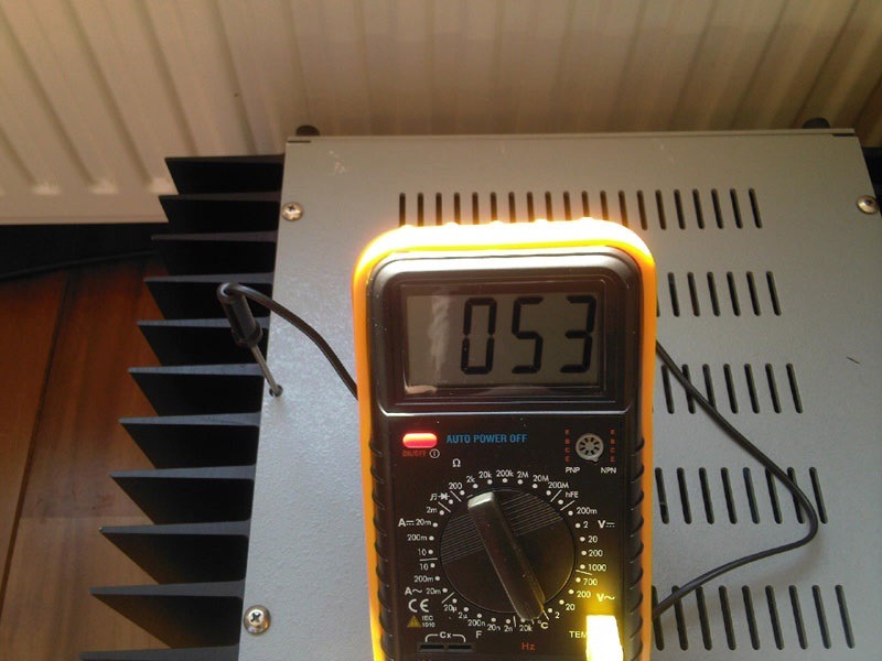

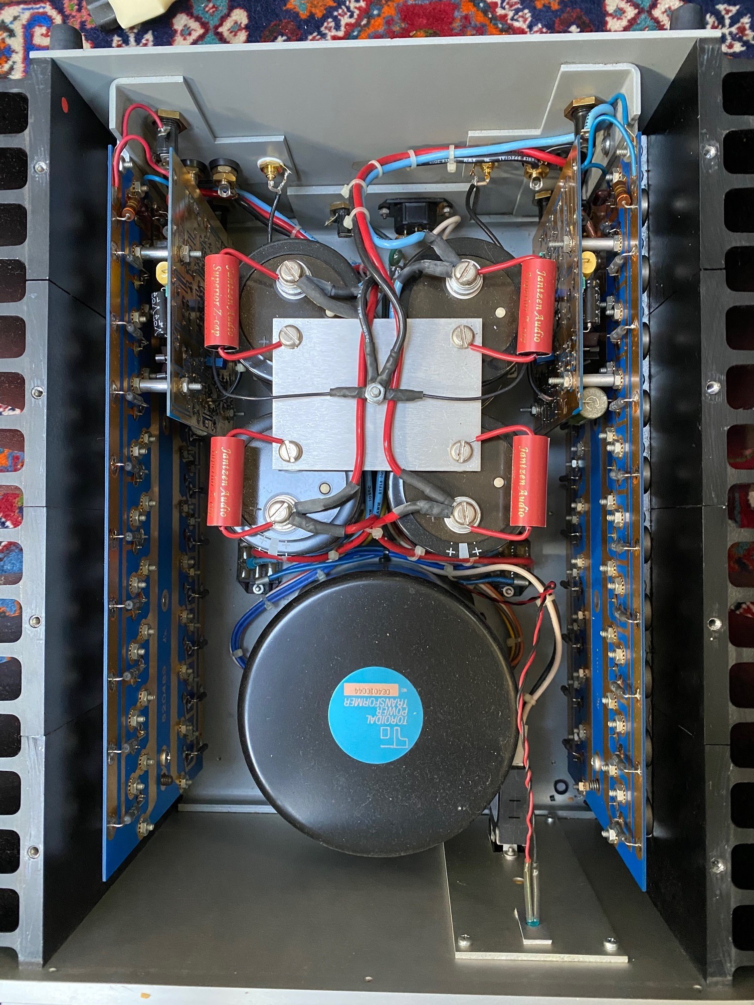

I've tried to find some more information and compare also pictures of the older Thresholds (e.g. S/500 II) and my SA/4e. I've found the emitter resistors to each output transistors in the older series (S/500 II) as can be seen in pic1. At my e series I can't find any of them (pic2). According to that I've read the a threshold technical paper about biasing these type. They pointed out to measure this type on power supply board (pic3). I guess I found the trimpot for adjusting (SA/12e service manual) on the front end board pic4. But I've no idea how to reach it. The service manul mentioned to use a insulated screw drive - no idea from which side... dismanteling necessary...?
About temperature measurement I found pic6 but remembering that I've read in the past (forgot the threat) about last screw to rear plate: There was also the idea to measure in the vertical middle between 3rd and 4th coolig fin from the rear. Any idea what's cthe best way?

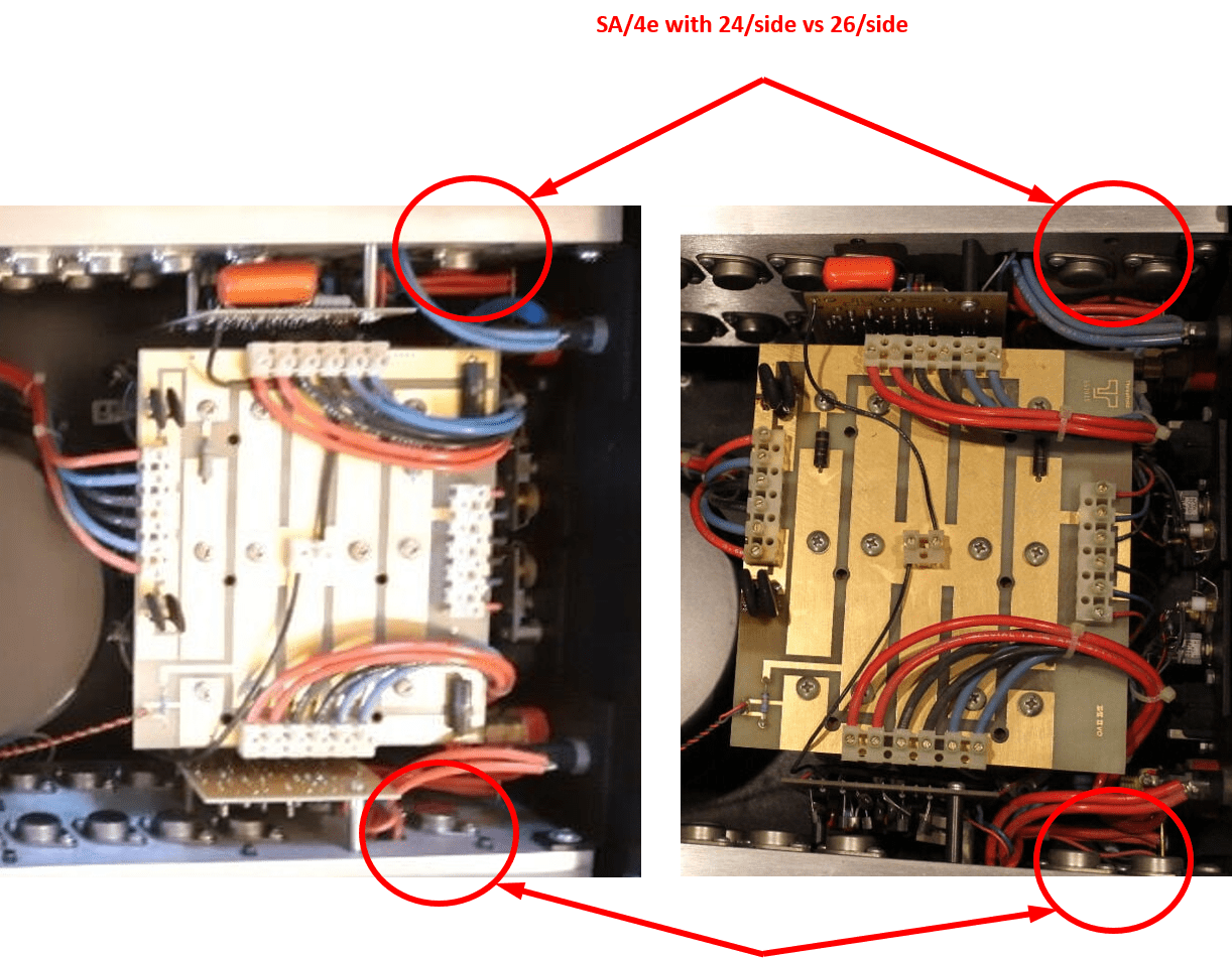

Another point is my SA/4e's have different numbers of transistors - last a transistors the rear panel (pic5). One has 24/side the other 26/side. I found in the net many SA/4e's with 24 and also with 26 transistors per side. I also find SA4/e versions with faceplate of the older Threshold series like S/500 II. In the service manual they also differ between SA/4e for Non-Opto-Bias and Opto-Bias - guess the Opto-Bias is with the new faceplate version...? Any ideas about differences regarding sound?
thanks a lot again.

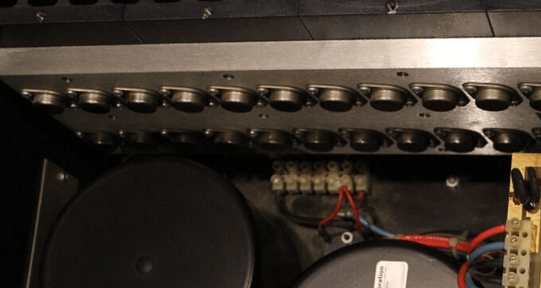

Your emitter resistors must be hidden behind the aluminium heat spreader in your pic 2 , hence the measurement for bias with the method shown in pic 3 reading mVDC across the 0.01 ohm resistor . You might need to pull the sides of so you can get to the front end board and perhaps change the bias pot to one that has the adjust screw on the side so it points to the top of the amp for easier screw driver adjustment. The schematics I have seen for your amp show 24 transistors per channel.
The temp measurement shown in pic 6 is fine - near the centre / top of the heatsink is ideal.
The biasing document is correct, important points are the final bias level, with regards to heatsink temp after 2 hours or more with the lid on.
