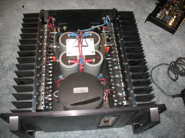

I have a S/500, s/n: D87090454, that has an issue. Specifically, the middle of the right side heat sink gets much hotter than the same section on the left side. I saw there were schematics for the S/550 posted and I'm wondering how different the two units are. The one I have is an 'Optical bias' unit. I have to check the offset to see if there is a glaring difference. Going to open it up and test the outputs and resistors to see if they are all ok. Anyone have any other suggestions?

Ok, here's what I have so far, and I promise pictures will follow.
Output offset L: 2mV
Output offset R: 19.2mV
Voltage drop across L emitter resistors: all in the range of 72-80mV
Voltage drop across R emitter resistors: all in the range of 126-146mV
It looks like the outputs are being driven hotter across the board so I'm now looking at the small input circuit board as the source of my troubles.
Diagram anyone? Or suggestions?

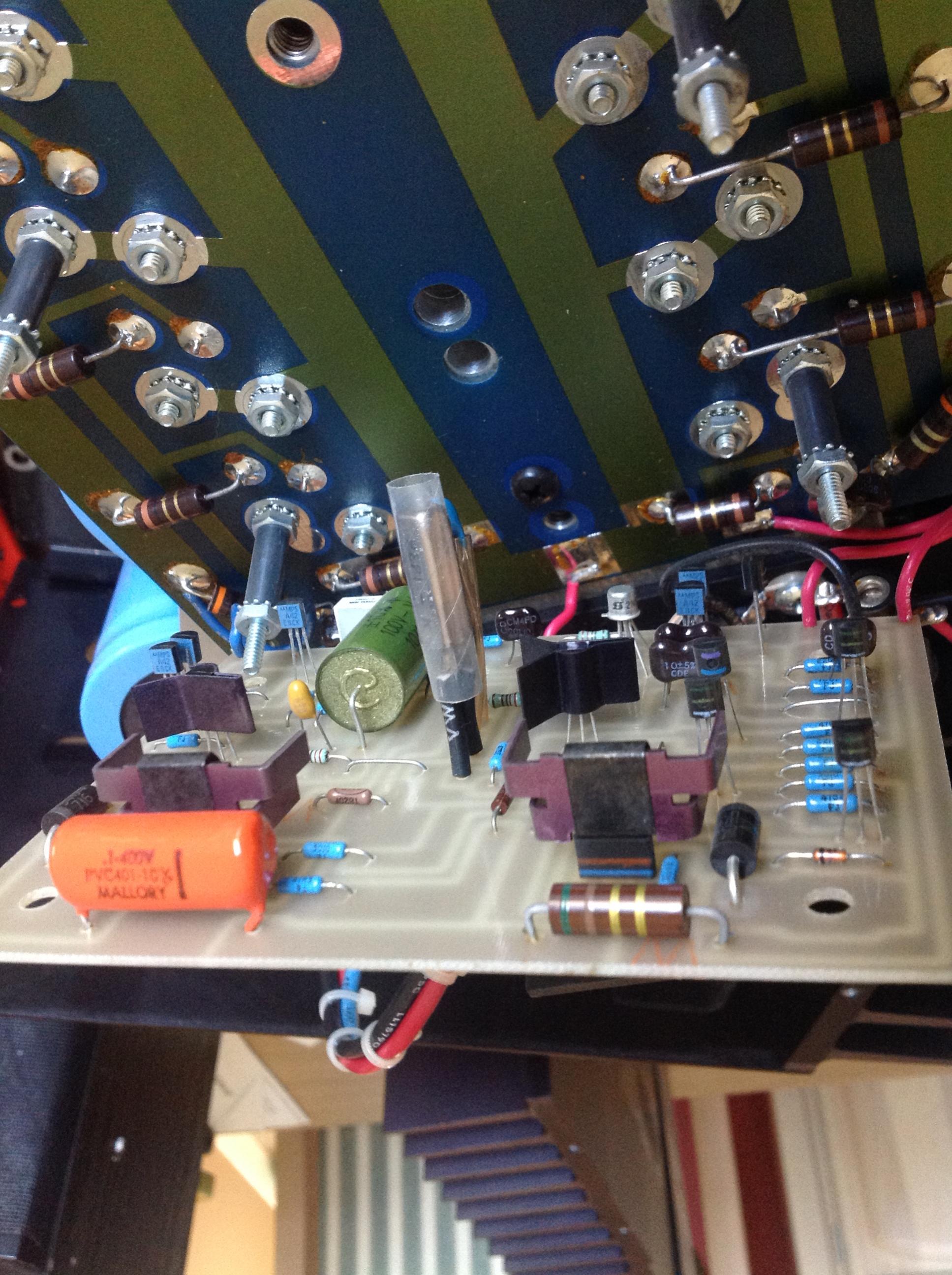

am I blind , or I can't see where pot is .... ?
however - it must be for Iq , what else .....
easy to test - one DVM across output terminals , second DVM across one emiter resistor , fiddle with it slightly and you'll see what is happening

It's a small square white trim pot in the back left, behind the green cap on the input/bias board.
After I clean and lightly re-goo I'll fiddle about with it.

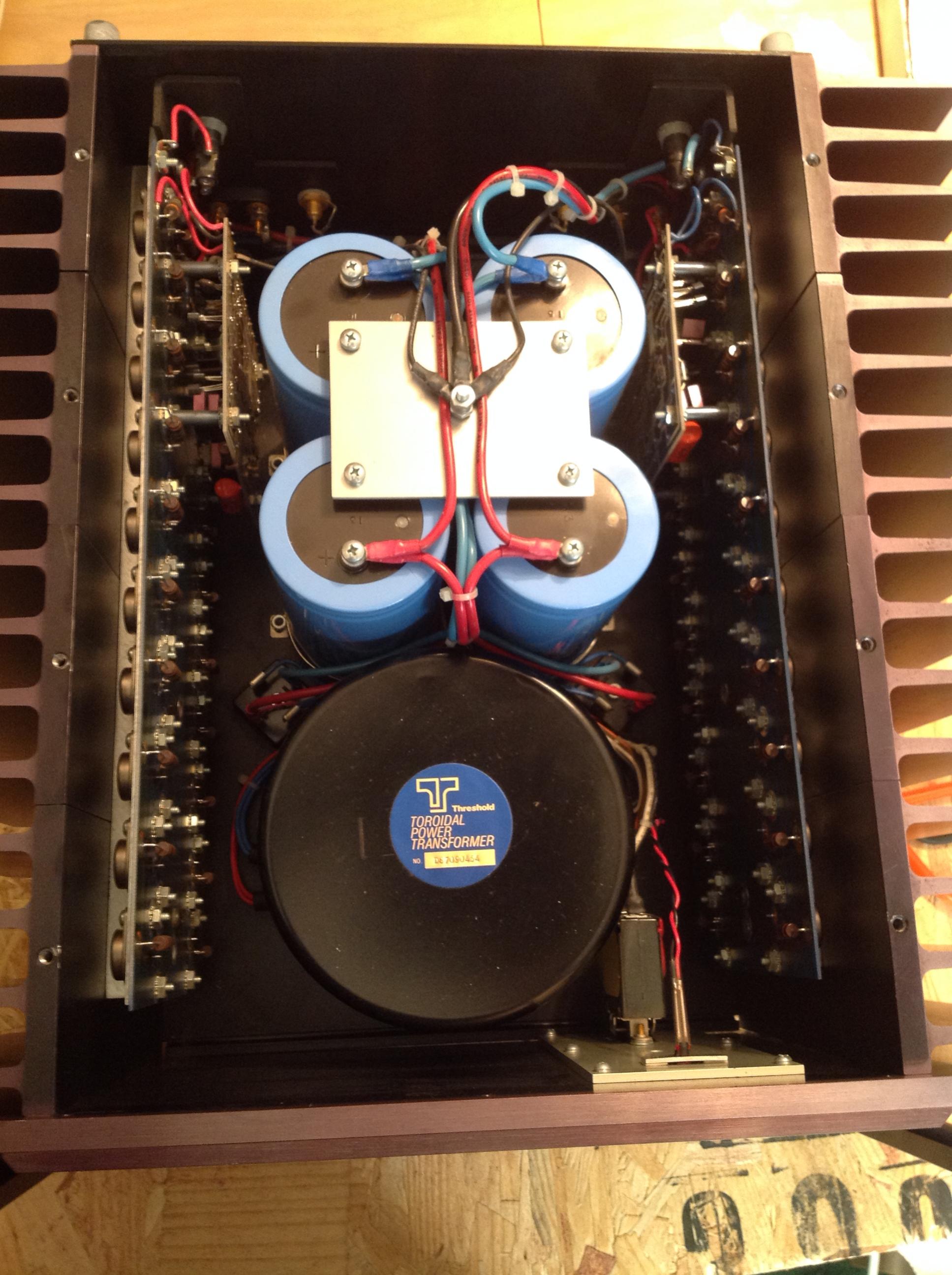

Hi all,
I know it's been a long time that I've checked in.
I reseated and resoldered all the output transistors on my S/500.
New development. It's popping Negative Rail fuses on the side I worked on.
All the transistors test good. All the resistors test good.
I'm at my wits end because I can't seem to locate the problem and I'm chasing my tail.
