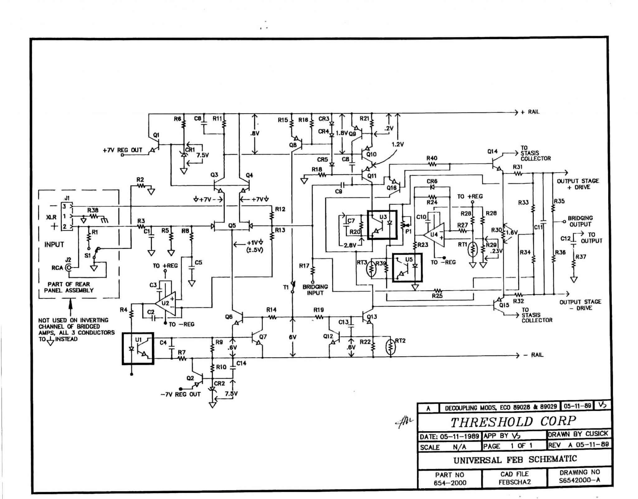

OK, I’ve been reading and gathering as much information as I’ve been able to first, prior to posting. This is having come across a Threshold S/350e power amp locally, for sale.
Due to the age of these amps, I know it’s de rigueur to replace the power filter caps, change the tantalum to an electrolytic cap on the FEB, check (de-solder) and/or replace any output transistors that may have failed and replace the carbon composite resistors due to drifting for something more appropriate… amongst others !
However, before I effectively go ahead and purchase this superb amp and “go to town” on it, I’m by no means an electronics “guru”, but I know enough to refresh these amps and perform upgrades etc. So, would appreciate as much feedback or suggestions as possible from others members on here… and perhaps, if the man himself, Mr. Pass, would be kind enough to provide some additional enlightenment.
The following is what I plan to do, so far…
  • Replace power filter caps; any recommended value… or is it just a case of the largest value, lowest ESR and highest ripple relative to correct voltage and physical size that will fit ?
  • Replace base emitter resistors with Dale NS Series (non-inductive) 1% 2.5w wire wound; any alternative type recommended ?
  • Replace (C7) 4.7uf tantalum with electrolytic; low ESR recommended or alternative type for stable and long life ?
  • Replace (C4) 220uf electrolytic; low ESR recommended or alternative type for stable and long life ?
  • Replace (R37) 6.2Ω 1w carbon composite; any alternative type recommended ?
  • Replace (T1) trim pot with multi-turn type for easier adjustment from top of amp; any thoughts on this ?
  • Replace (C7,C8,C9,C10) power supply pcb (small) electrolytics with low ESR types; any thoughts on this ?
  • Add bypass caps to power filter caps; any recommended value and type ?
  • Fit a soft start circuit; any recommended brand ?
Also…
  • I’ve read somewhere on the internet but it wasn’t explained how, the balanced input impedance can be raised from 600Ω to approximately 50kΩ; any thoughts on this ?
  • Replace (Q5) 2N5566 with IFN2N5566 I’ve read it is/can be beneficial to replace this JFET; any thoughts on this ?
  • I understand a matched pair of IFN2N5566’s is required for the above point; any thoughts on this ?
  • I’ve read about one member; kevd having significant trouble some time ago trying to bias his amp which eventually turned out to be an incorrect CNY17-4Z optocoupler instead of a CNY17-3. I understand the FEB on these amps have (U1,U3,U5) three (3) CNY17-4Z optocouplers; do all three (3) need to be replaced as per component list, or just U3 adjacent to the trim pot ?
  • I’ve seen pictures of the (C12) 0.15uf/400v replaced with a WIMA polypropylene; any thoughts on this ?
  • Considering the idea of replacing the rectifiers with pcb modules utilising SiC Schottky diodes mounted on heatsinks; any thoughts on this ?Based on experience working with PA systems, I know all too well in general it takes more “energy” or power to drive the LO end, compared to the MID’s and HI’s. So this is what I have in mind at the time of refreshing this amp; my plan is to keep this amp as standard and run it Class A/AB @ 150w per side for the moment. Then, if I purchase a second amp, reconfigure it to an SA/3.9e and run it Class A @ 60w per side for driving the MID’s and HI’s, while using the first amp and run it Class A/AB @ 150w per side for driving the LO’s… this is to allow for “headroom”.

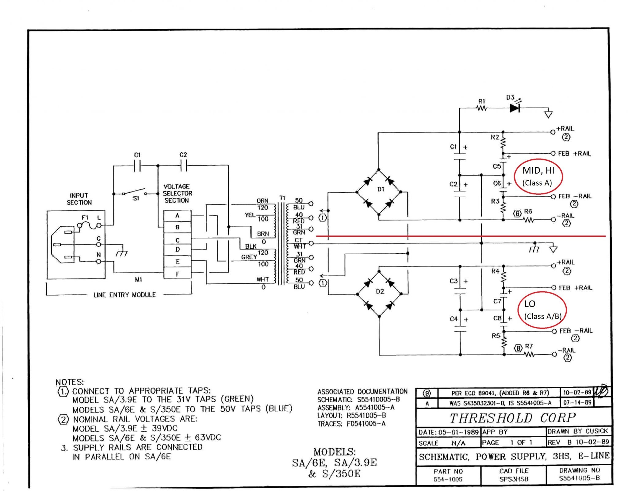

Perhaps an additional thought to allow closer location of each amp to each speaker without having to cross any of the cables etc., a more intriguing or adventurous idea would be to create a pair of S/350e “hybrid power” amps, using the existing double bridge rectifiers in each amp.
Looking at the schematic, mount a second transformer in each amp with a centre tap (how would this work with both 31v & 50v taps ?) two split the power filter capacitors using a custom sourced pcb then reconfigure and bias one side to run in Class A/AB @ 150w for the LO’s and the other side to run in Class A @ 60w for the MID’s and HI’s… would anyone like to enlighten if this is doable somehow ?

  • that tonight, will have more time
  • if amp works and DC Offset is OK, do not touch them
  • if changing, and you're using single JFets, you must use matchd pair for LTP
  • if amp works, do not change optos
  • read comments above for (all) caps
  • if that rattles you cage in appropriate manner, replace them

What did you think of my idea of creating a pair of “hybrid power” amps… doable or laughable ?

hybrid amps - everything is doable, even Wooden Stove; if that is fun for you and you know why you're doing it and you don't care to change Relics ...... go for it
simply, everything is up to you

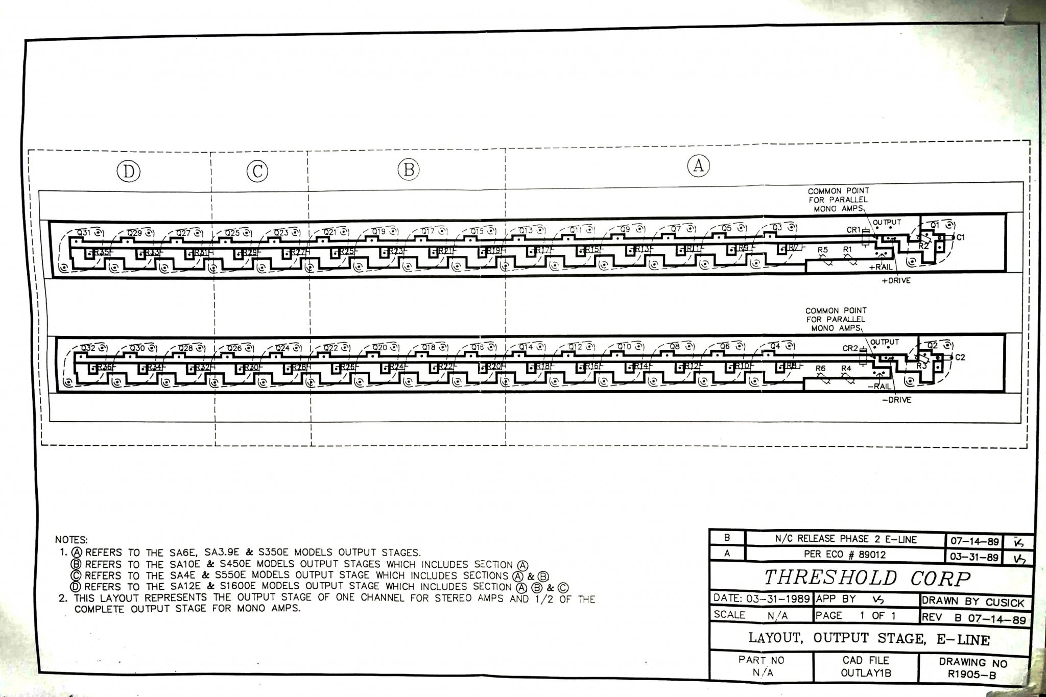

The Emitter resistors are 1 ohm right?
Add a snubber circuit for the transformer to the list. Quasimodo, cheapomodo are two terms to look up regarding that. Regarding the discrete diodes, you could probably mount all of the rectifiers to a piece of 3/8" aluminum bar or something and just mount the bar to the bottom plate with two holes, one on each end of the aluminum.
No, according to component list for output stage; 0.68Ω 2W 5% for S/350e... but measure first to confirm.
