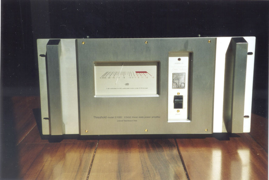

Just acquired a pair of Threshold S/1000 Series II.
1. Know that it has a bridged topology to get the rated 500 Watts at 8 Ohm that's why I wonder if it's stable at the lower loads? They have to drive Acoustat 2 + 2 Electrostatics.
2. Should I perform any prefailure mods with these 25 years old amps?
3. Does anybody know the difference between the initial Series and the Series II?

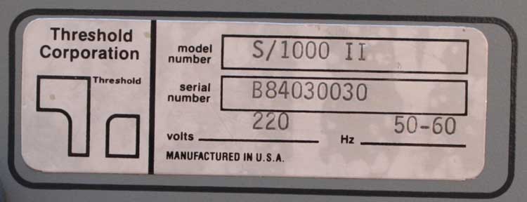

I have some pictures of these Series II designation.
The first Series II S/1000 amps were produced in 1983 according to the serial badge at the back.
According to the serials these sampels I own are produced in januari and March of 1984 and are designated as Series II also on the Threshold stylish T badge in the front it says Series II.
Can you recall the difference between the first offerings of these amps and the Series II.
Do you think the bridged topology is stable enough to drive low efficient and low impedance Acoustats. I know J. Gordon Holt got good results with the massive parallel SA/1 on the SoundLab A1 or A3.
The picture I attached says: 84030030
Probably means April 1984 number 30?
Frankly, I don't recall what was meant by Series II back in 1983.

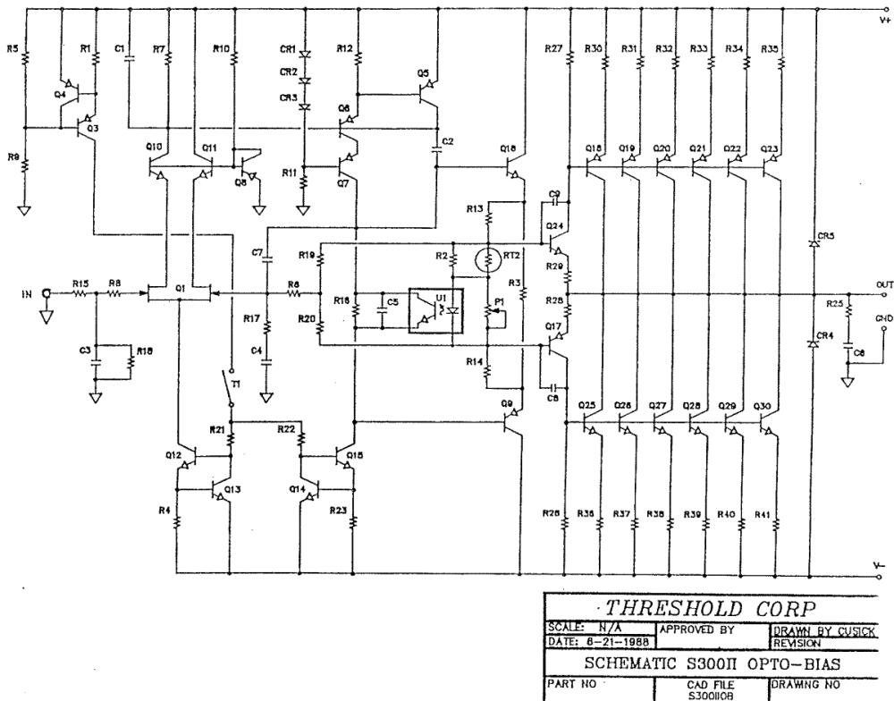

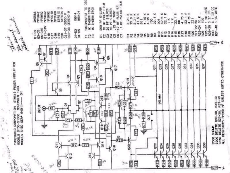

Thanks George,
Off course I did some homework and scanned every thread which came up with my Searchquery 'Threshold'.
so I was pleased to find your schematics and copied them to my disk already yesterday. Don't want to bother you guys with questions that could be answered by reading this information on this Forum. So thanks again.
