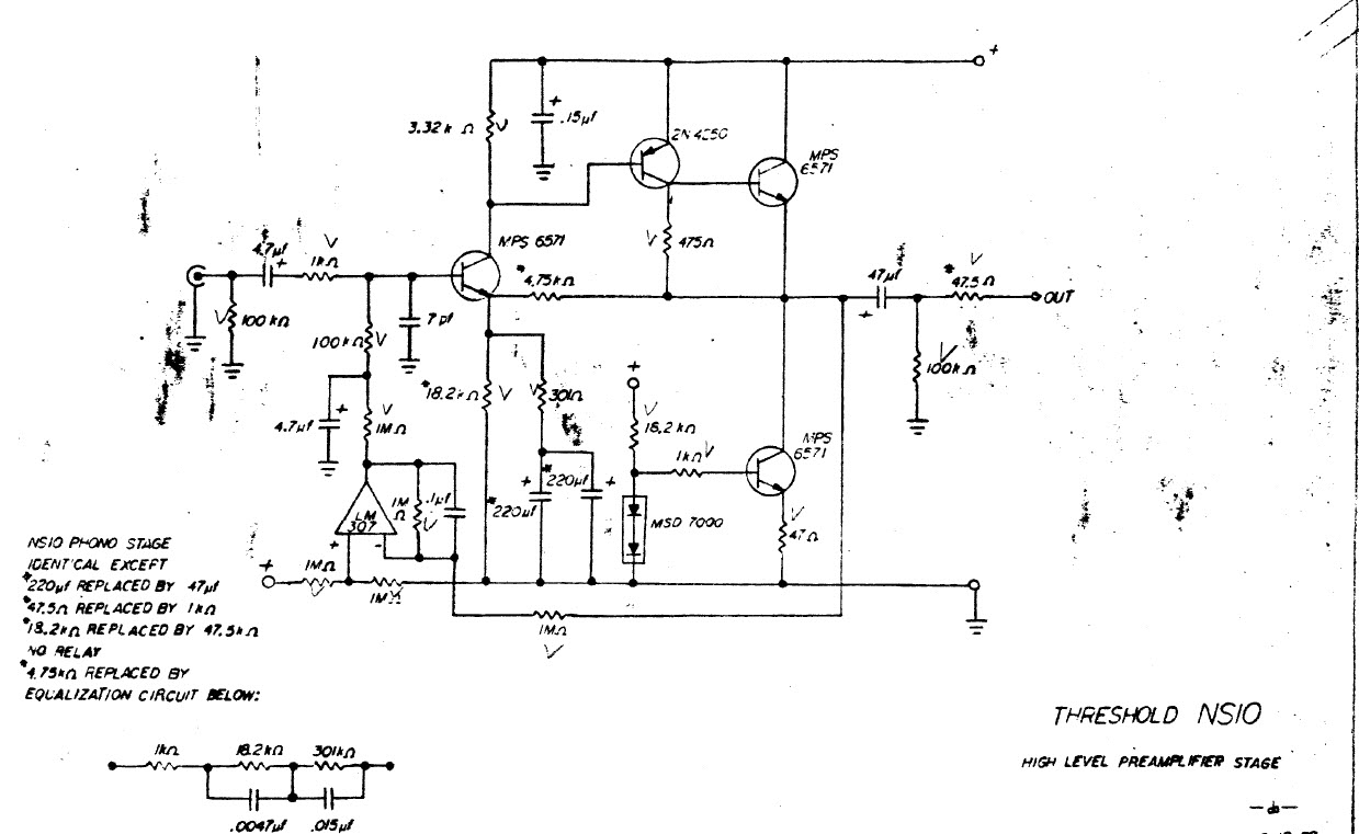

I purchased a NS10 recently and have spent a few hours reviewing all of the threads about this preamp, renewing it, modding it and cloning it, etc.
I'm going to the the 'renew' route but I really need to lower the gain. The spec for the line level section is 20dB and I want to lower it to 10dB. I'm using external -10dB bullets for now but is there something better I can do with a circuit mod?
either replace 4K75 ( connected from output to emiter of input transistor) - with 2K2, or solder another 4K75 across original one
