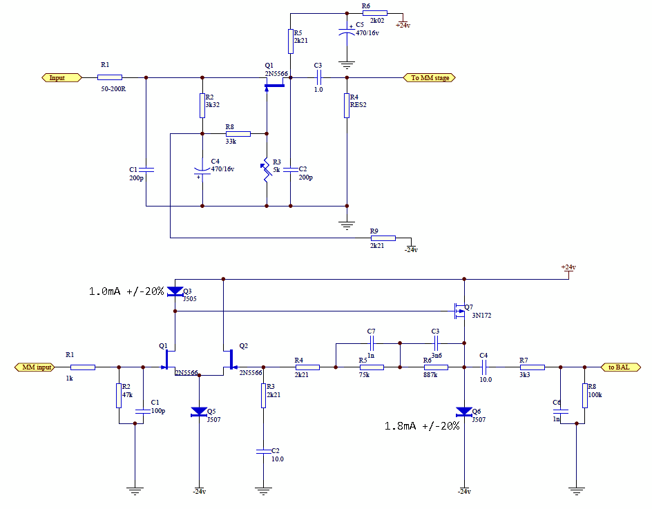

More seriously, the FET two has a loud "hushing" noise in the right RIAA channel - the line channels are OK, it's only using the "turntable" input (and by the way, the turntable input sounds really capable (despite the noise) judged by the limited listening I've done so far.
Anything I might be able to do my self? I know how to use my Fluke multimeter, and can build stuff - but am a novice in troubleshooting - and I have no schematic...

Unfortunately I don't have the schematic - anyone with a copy is welcome to post
it here. I would look for bad connections in the noisy channel first, especially at the
connectors. Play with any internal switches, and maybe you want to flip the channels
feeding the inputs and see what happens. If that doesn't get you any results then
try re-soldering the parts on that channel. If none of that works, then you take
down the numbers of the transistors involved, especially the input fets.

Thank you all for your replies. The noise is present on the MM input (when the rear switch is on one of the two "xxx pF" settings - I have not tried the 1K setting yet, which I assume will be MC?
Judging from the description, my unit seems to be an earlier model - I think the one shown in Analog_SA's thread is a Series II? Mine has different layout on the front (no power rotary switch) and also on the back (only one switct for RIAA settings).
Don't know if there's difference in the schematics between the two series..

Thanks for your help so far guys - I'll remember to keep you updated!
I've packed it down for shipment, the seller kept a warranty, so it's going away to his tech today. Don't want to start messing with it myself due to the warranty.

Preamp is now OK again and on it's way back to me.
Fault was a bad coupling cap - so sometimes the standard reply (Have you recapped it?) from "keyboard warriors" on WWW foras to what do do with a faulty amp was actually true
