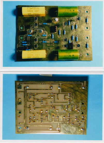

This's original pcb
But I don't use it's power supply because I have specially supply more than which one.It's use voltage error correction by reference voltage of 78L12/79L12 flow through UA741 for compared voltage IN:OUT and used 2N3055/MJ2955 for variabled current output 🙂 (this concept come from hi-end DAC power supply)

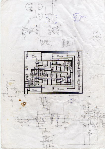

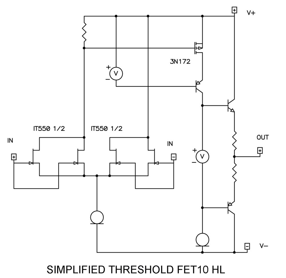

This's schematic of Threshold Fet-10HL
After I asked Mr.NP he told me that 2SK389 can instead of 2N5566 then I just to do it for a project.
Input of them are 2SK389BL (jfet) in parallel mode cascode with bipolar transistor for reduce capacitance and use transistor ccs.
BS250 (mosfet) used for matcing impedance of 1st stage & 2nd stage, output stage is normally push-pull bipolar transistor such as KANEDA & JC2, I think a perfect matched parts enough for set sound quality & stability.
Now I used this circuit & Aleph P1.7 in different case so don't ask me for compare both them

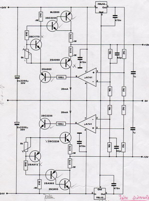

This's my power supply schematic
I can't remember I got this schematic from...?
But it's can use with several circuit such as phono stage, preamp, DAC, etc.
Now I got some problem with output capacitor filter because original supply from www.diyzone.net don't use it or they're use 1uF on preamp board ?!?

OK, I just understand
At my first question why not FET-10HL doesn't used mosfet for an input such as Aleph P1.7 ?
