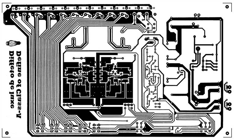

My first project is Threshold Fet-10 in a new name "Diffeto Deluxe"

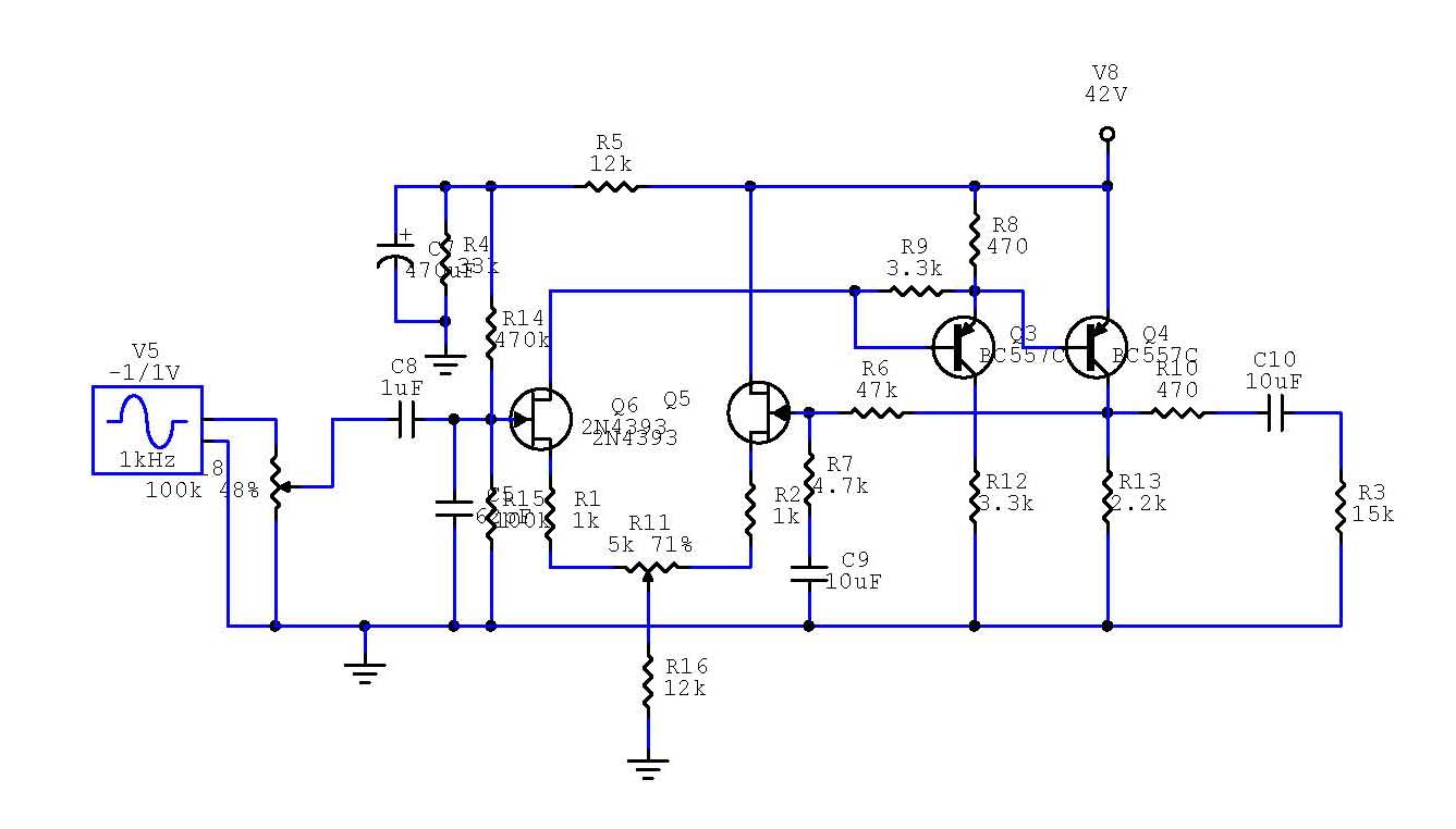

my website has created in Thailand sorry with Thai language. threshold Fet-10 has an easy designed and it operated in a following method.
1.In put with differential J-fet and ccs by resistor
2.Second stage with common collectorfor for matcing high to low impedance with 1 transistor run with class-a
3.Out put with common emitter in 1 transistor run with class-a
4.Schematic coming soon

Values of C5 and R15 overlaps in the circuit. may i know what is the value? What is the trimpot R11 for? What adjustments to i make to get what readings?

Ok...following value
62pF & 100K every value you can change for the best result. If anybody use circuitmaker2000 can email to me for a simulated file. My new project is AlephX100 in another patent of Passlabs + Aleph P1.7 preamplifier if you want some pcb files can mail to me too.

I have trouble obtaining 2N4393 over here. Is PMBF4393 an equivalent? if not, can anyone advise on a substitute?
Substitue
2sk170*2 / 2sk389*1 can substitue them.

Are you sure it is as simple as that?

following address
http://www.aht.8m.net/AHT DIFFETO DELUXE/DIFFETO DELUXE.htm
The other schematic is regulate power supply & muting output relay & volume control

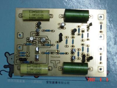

This is a photo of FET10/HL line nodule.
The input stage is two dual FETs diff-amp and VAG is p-ch mos-fet and output stage is mpsa42/mpsa92.
For you refer.
aht said:I'm sure it's HL.
You can ask any question to Nelson for sure model
For you refer.
