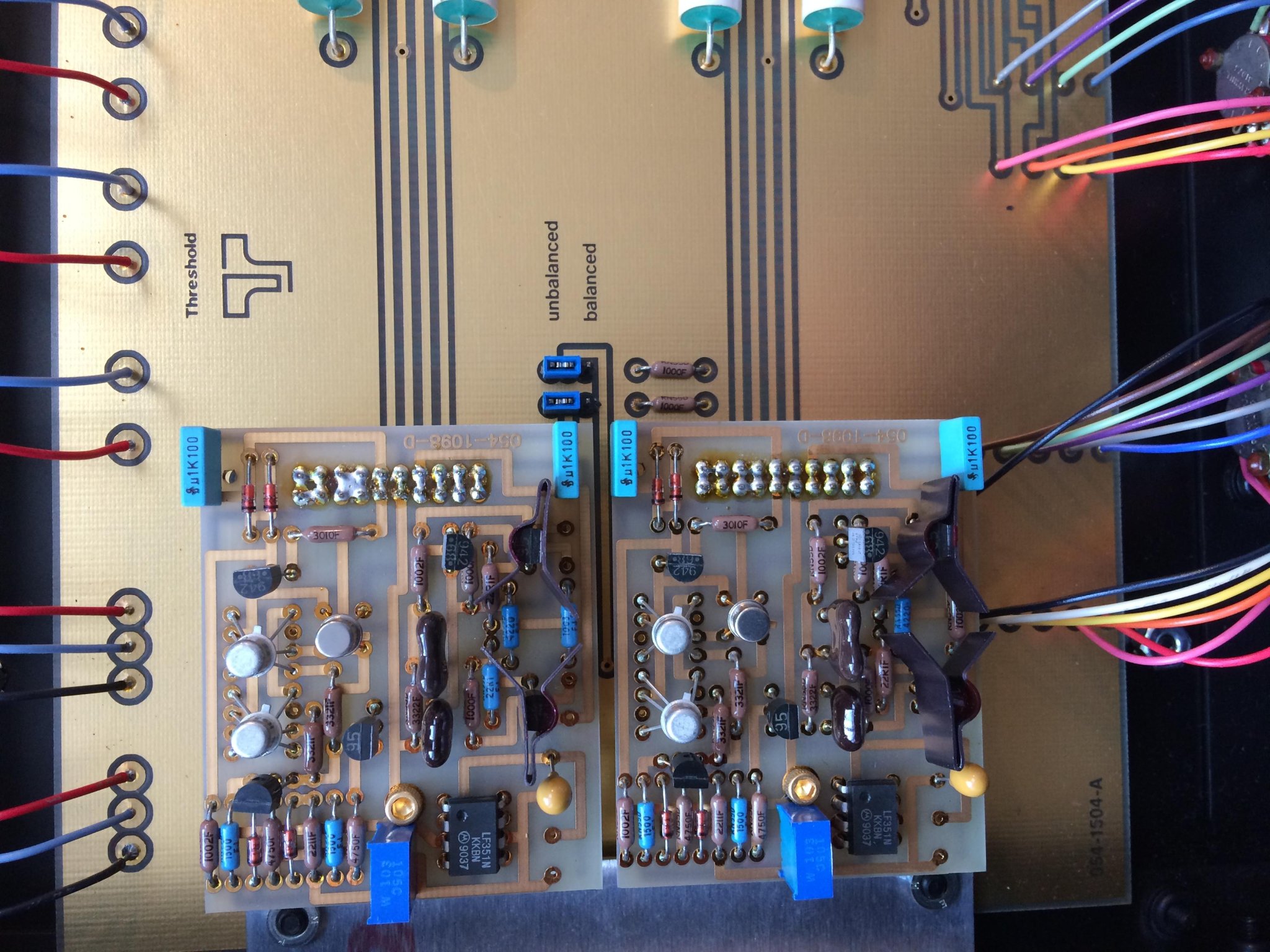

I found this information on the Internet about 5 versions of FET TEN 'e' Series preamps.
Is this correct (Wayne?):
For reference, the variants of the FET-10E are listed below:
My unit inside:
Any idea which version I have if these versions exist?
Is it possible that the Noble Black pots (used for Volume and Balance) can get dirty and scratch a bit?
- FET10 E -T special end of model, super version with hand selected and tightly matched parts, upgraded power supply, heavier gauge power supply cord, unique control knobs, ... .
- FET10 E v4 - most highly evolved FET10 E production series with DC servo pot, polystyrene stacked film bypass, metal military package input FETs, etc.
- FET10 E v3 - Same as V4 without the metal, military package FETs.
- FET10 E v2 - Same as V3 without the DC servo pot.
- FET10 E v1 - Lacks DC servo pot, polystyrene bypass caps, etc.

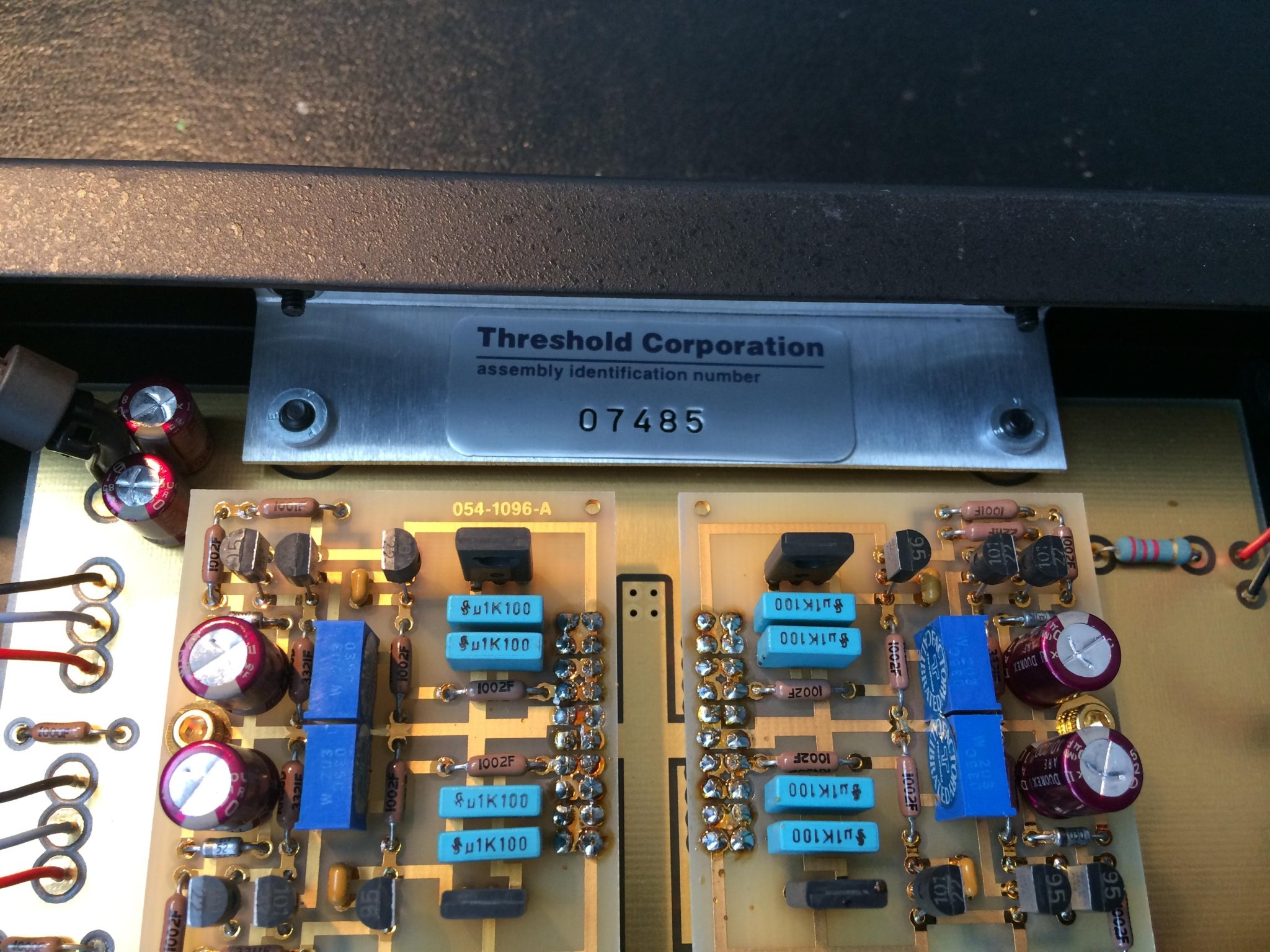

My unit inside:
The pots can get noisy but a little deoxit will fix that. Based on the capacitors that is towards the end of production or the electrolytics have been replaced.
