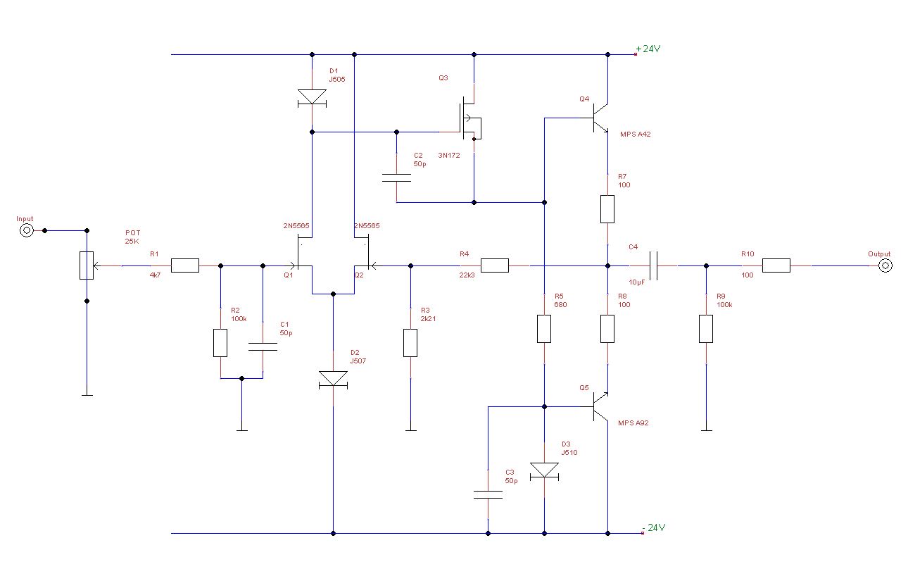

well, I didn't even look for details, replying about role of output bjts
I think it is OK as edited

The MC input will remind you of an existing Pass circuit. https://www.firstwatt.com/pdf/art_zen_iv.pdf
