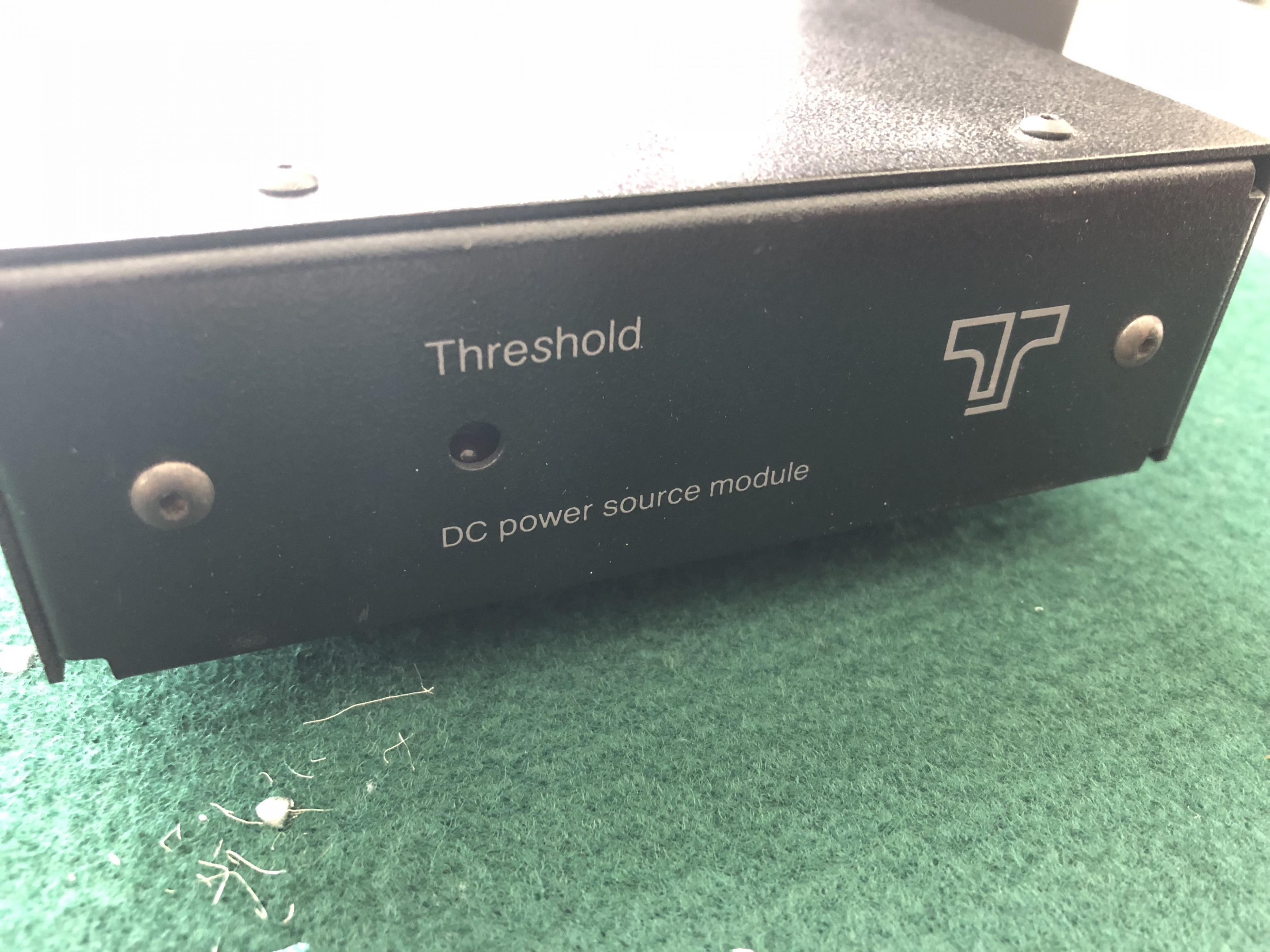

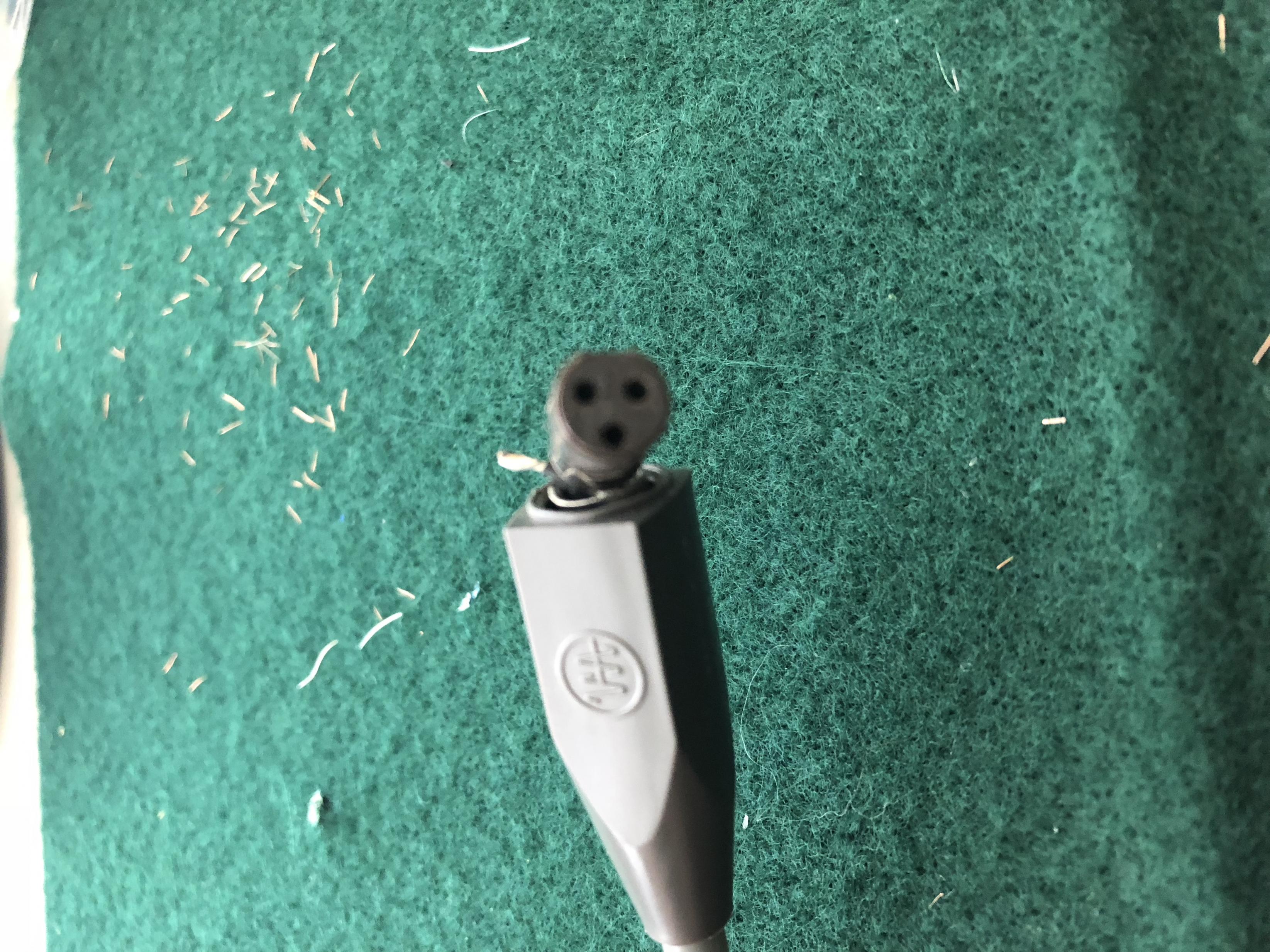

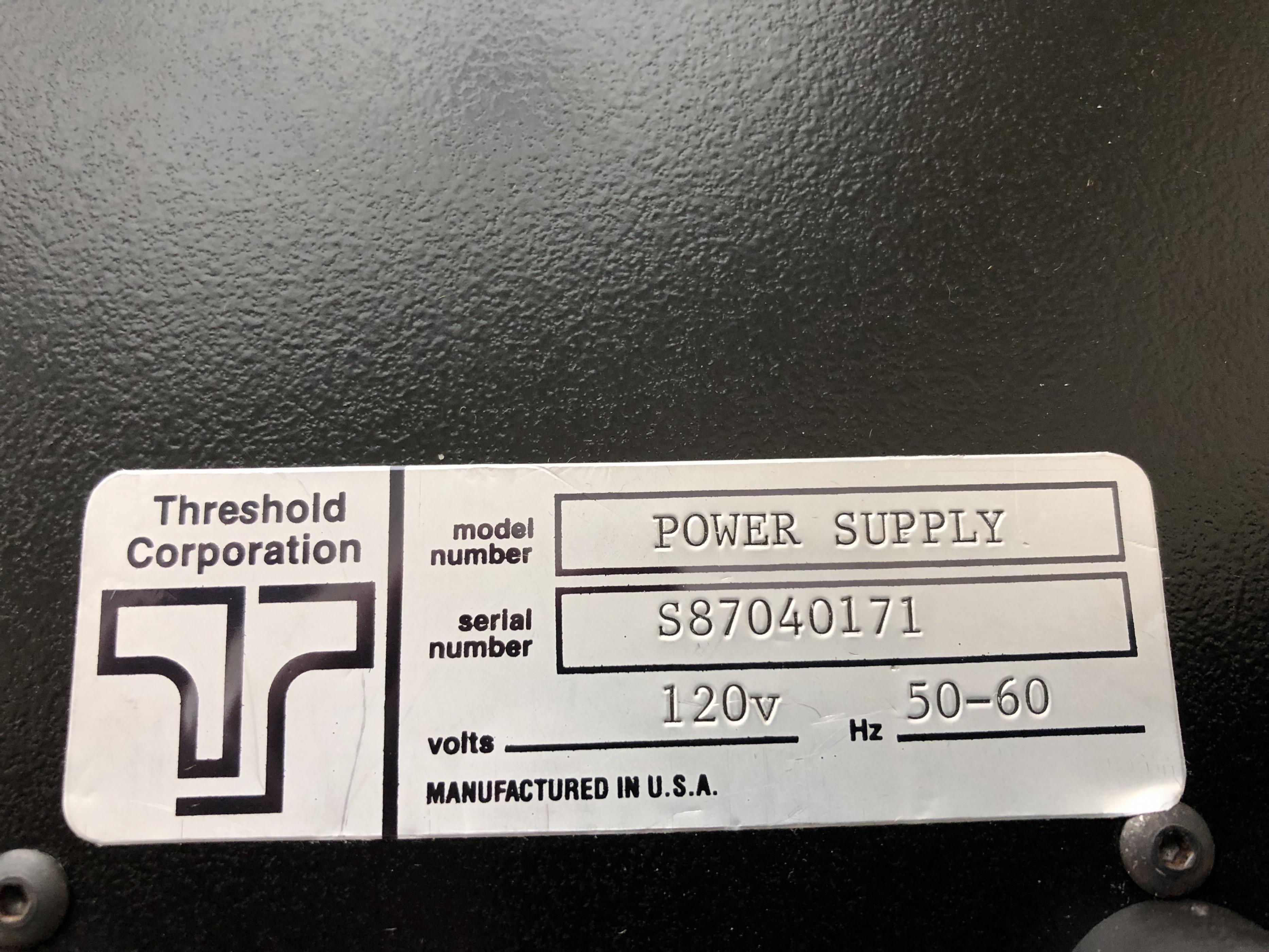

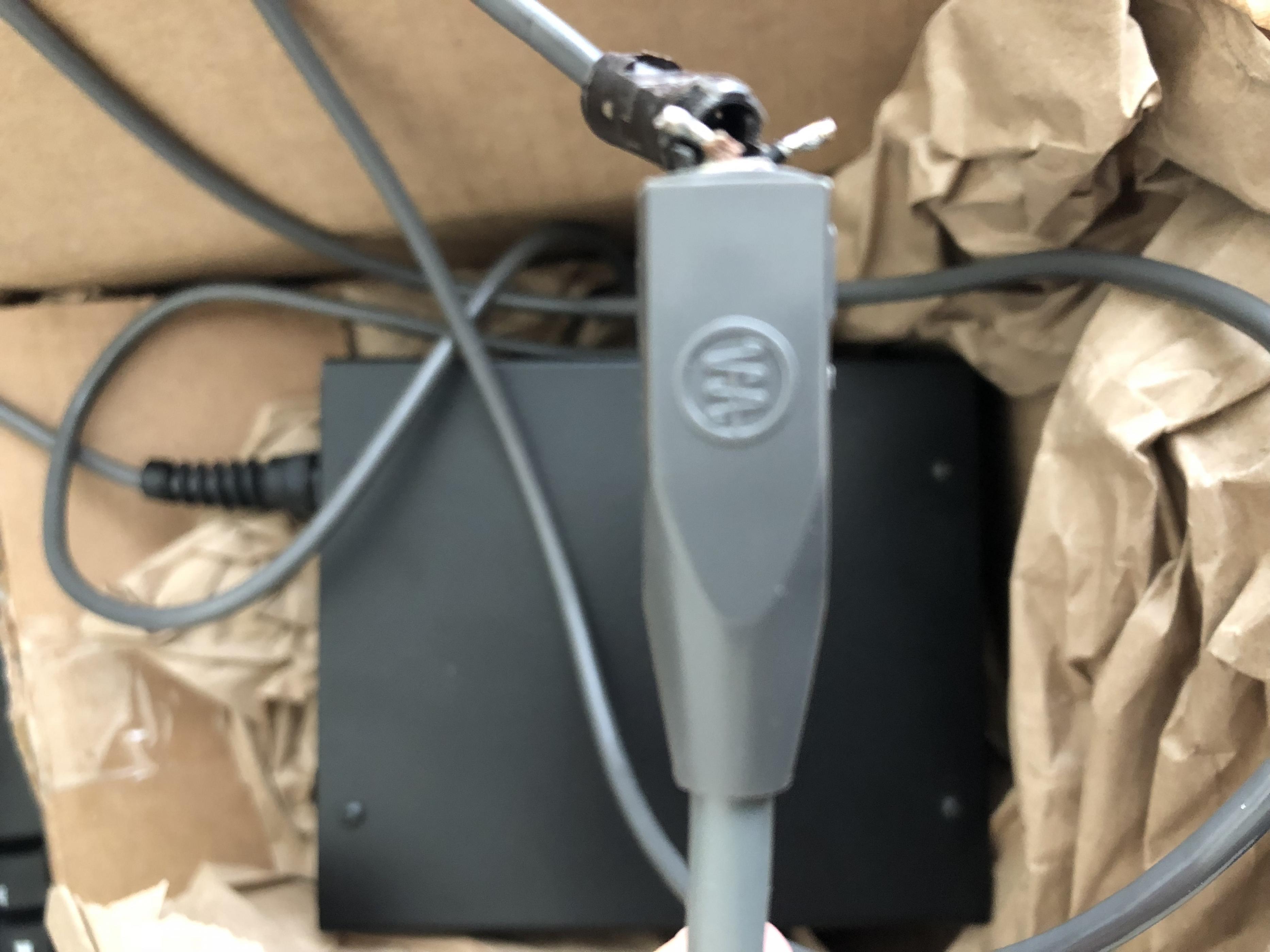

I'm trying to help my dad get his Threshold Phono Stage (Fet 10e) back up and running. The DC connector is broken but I have no idea who the manufacture is. Can anyone help identify who and by some chance know the model #?

Looks like mini-XLR Switchcraft TA3M (male) and TA3F (female) connectors. Used with wireless systems quite a bit. Huge pain to solder due to small size and goofy design.
You might consider something easier to deal with like full size Neutrik XLR connectors and jacks. They'll take up more panel space, but your box looks like it might have enough real estate to work with. I'm sure you already thought about simply hard-wiring. 🙂
The power supply picture that you've shown looks like the power supply for the FET 10hl, not the 10he series.
The 10hl series (and 10pc phono) has a power supply with an umbilical cord that plugs into the line or phono stage. It uses mini-XLR connectors - female on the umbilical cord and male on the line or phono stage.
The 10he series and (10pe phono) has the umbilical cord on the line or phono stage and with a male connector on the cord and a female connector on the power supply. The connectors are made by Tajimi.
Are you sure about the model you're working with? Perhaps pictures of the phono stage would help figure it out.

That power supply came with my dad's Fet Ten PC phono stage when he bought it new. I emailed Tajimi and it's not their connector. 🙁The power supply picture that you've shown looks like the power supply for the FET 10hl, not the 10he series.

Not sure why you're not accepting the answer that both Langston and I have given you. If you're looking for a connector for the 10pc phono stage then you need a mini-XLR connector.
