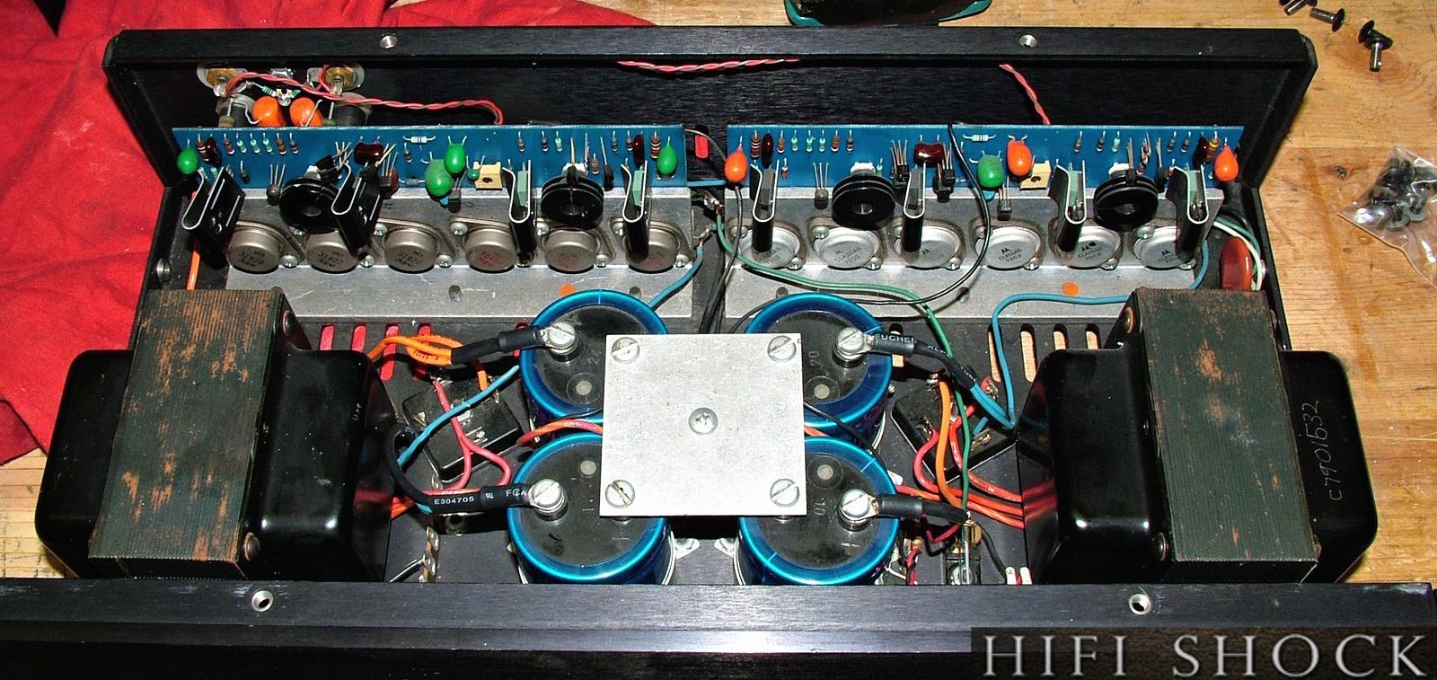

I've looked into it; meaning I've spent 45 minutes fooling around with digikey.com and a calculator. I think I believe it's possible to emulate/duplicate/improve-upon with modern parts. BUT fire up your most potent Google-Fu and look at the Images of the original. It was dual mono with two transformers. That might be the most time-consuming, money-consuming, chassis-volume-consuming part of the whole project.

Thank you for the reply. As you recommended, I foo'd a picture and have attached it here for the sake of discussion.
it looks like dual mono power supplies with a common ground between the channels.
The striking thing to me is that it appears that the output transistors are sinked (sunk?) to the bottom of the chassis along with the bridge rectifiers. I see no actual heat sink anywhere. The drivers have clip-on heat sinks. This amp must be super efficient if it can produce 75 watts with virtually no heat sink.
I agree that most of the cost will be chassis/power supply/heat sinks. Same for many power amp DIY endeavors.
For bench development for this project, I have a pair of Kikusui bench supplies that are capable of 35V @ 20A continuous. I will not need to purchase any power supply parts for the initial what-if stage. I also have several sizable heat sinks that I can use.
For the front end and VAS, I have devices that I think will work. My question is what devices will work for the final stage?

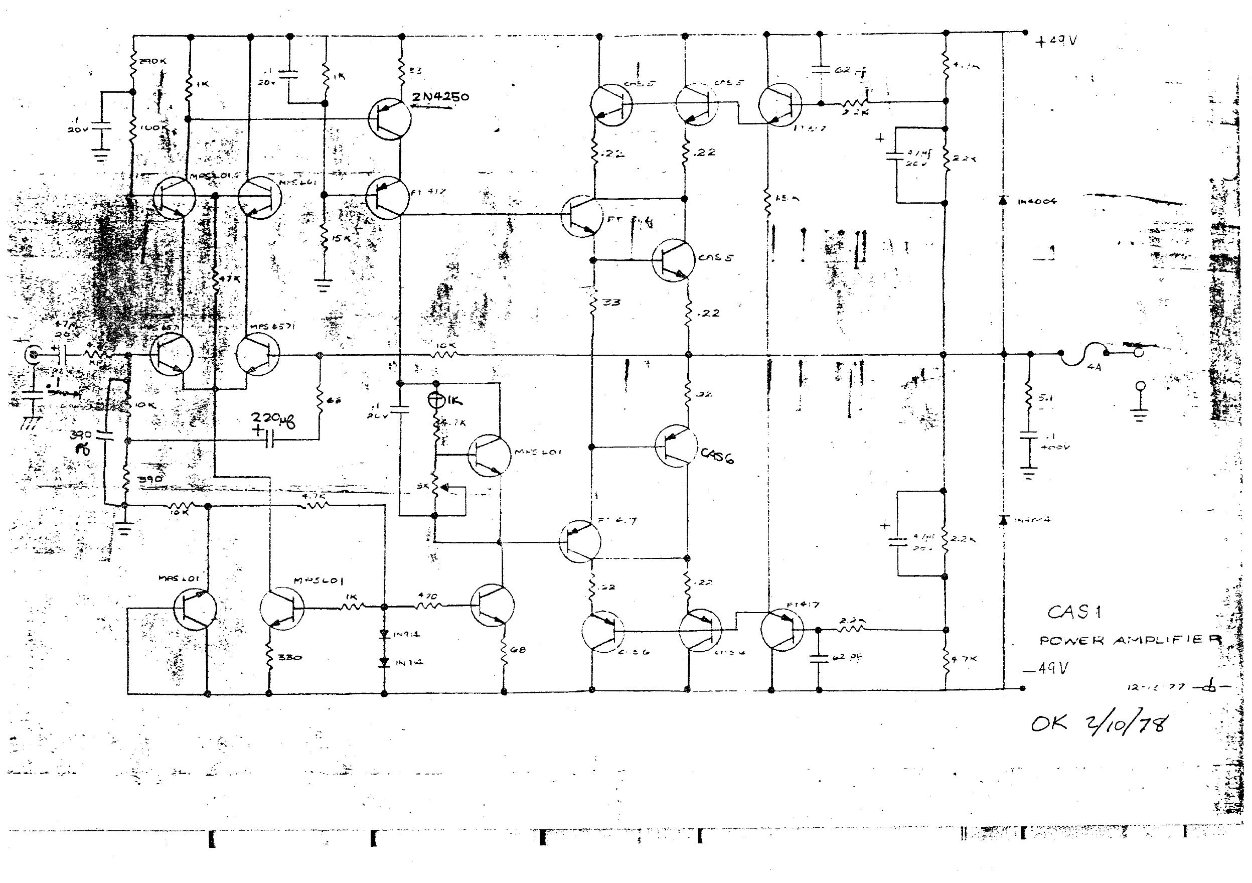

The schematic that I have is attached. I am looking for input as to the correctness of this schematic.

No and no; sorry.
Perhaps it might be possible to abandon the quest for "equivalent" components, and instead begin a search for "best possible choice among today's available" components. In other words, think of yourself as a designer and not as a purchasing agent.

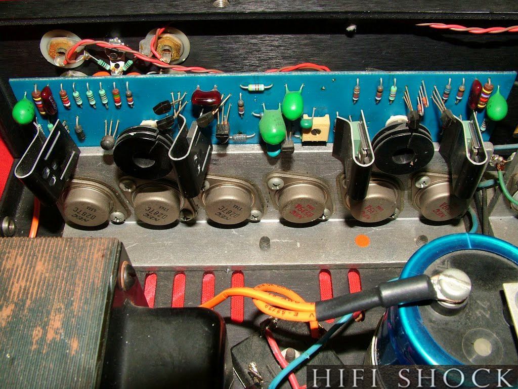

Attached is a picture that I found. The output transistors are NEC 2SD287C and 2SB539A.
The NEC datasheet is attached.
I will start looking for TO3 plastic equivalent parts. If anyone wants to chime in with suggestions, that will be welcome.

That's the left half of the photo attached to post #3. The right half of the same photo shows six TO-3 transistors, all with the "Bat Wing" Motorola logo. Which suggests that the amplifier may have been repaired and the output devices for one channel were replaced. But which is the original and which is the replacement?
Very good catch. Here is the photo of the other side. The fact that the transistors are marked CLASSA6 and CLASSA8 just as in the NP schematic would lead me to believe that the Motorola devices are originals.
