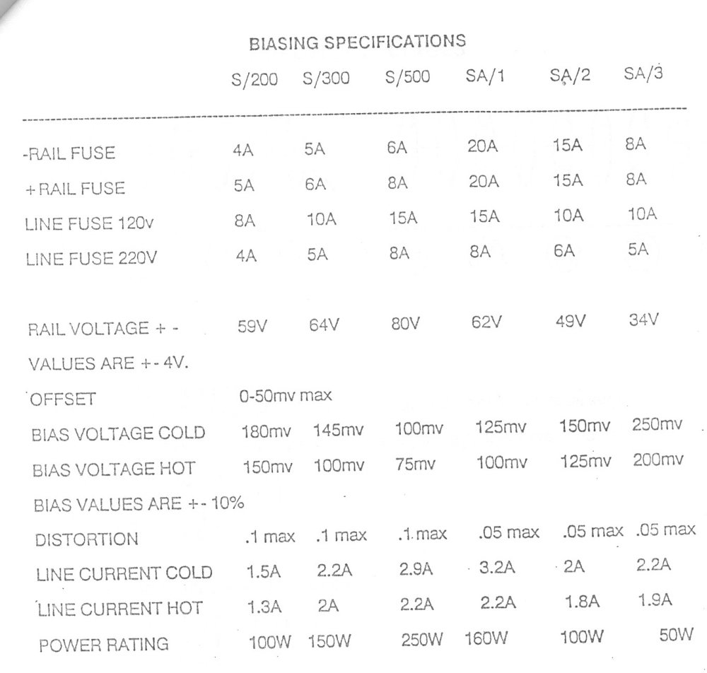

And next post is the operating parametters measurments.

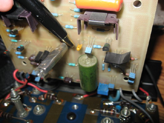

Yep, that looks familiar, that value is .22uf 35v, change it for a .22uf 100v plastic and hope it was the problem, it's good to chage it anyway as tantalums have a definite use by date and that one is a time bomb, for that amp.

Well, I changed the cap, but still have the click. If this matters when it clicks my speakers move in.

It was good to change the cap anyway, it can safe a big blow up later on (do both channels).
