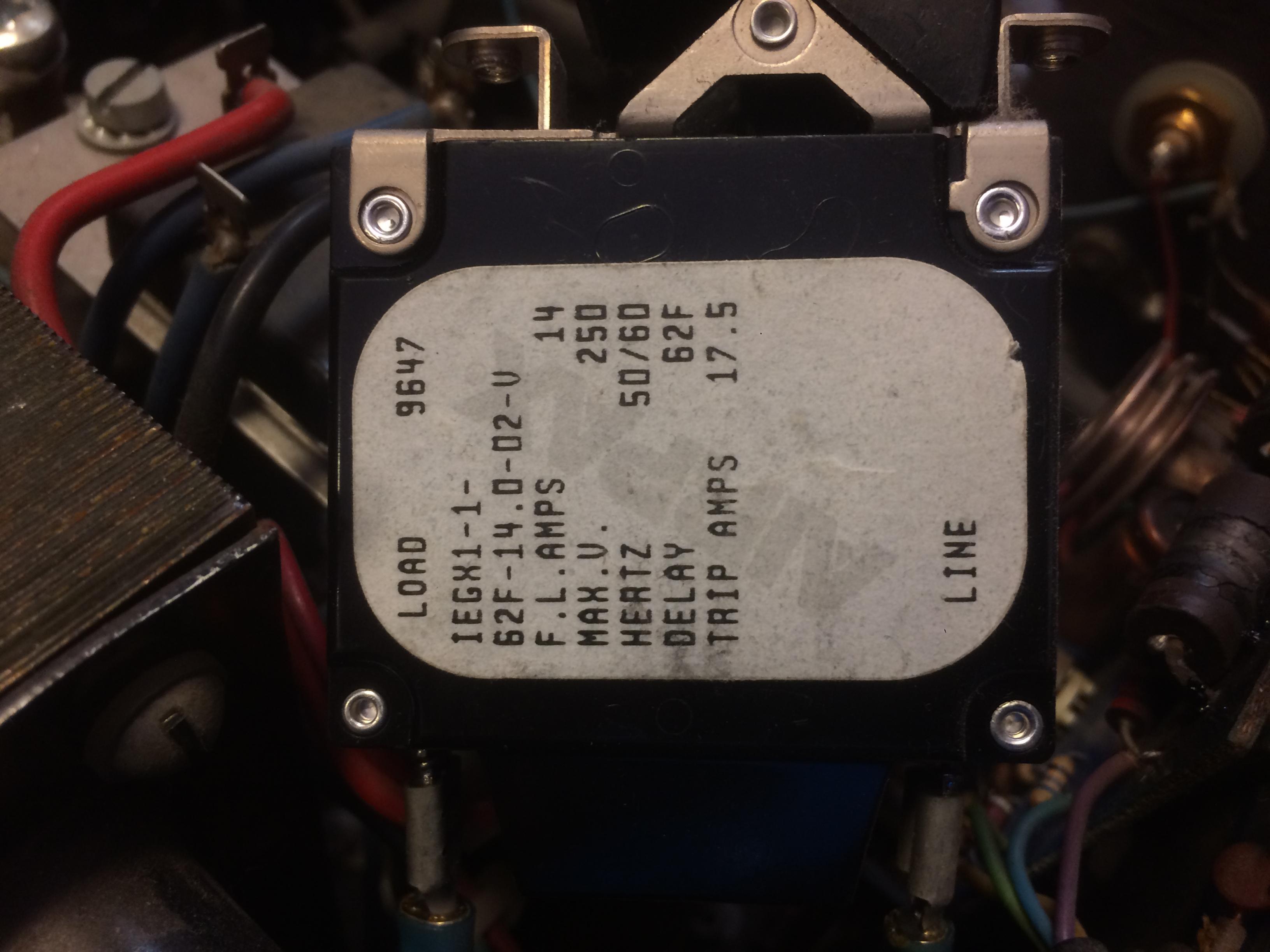

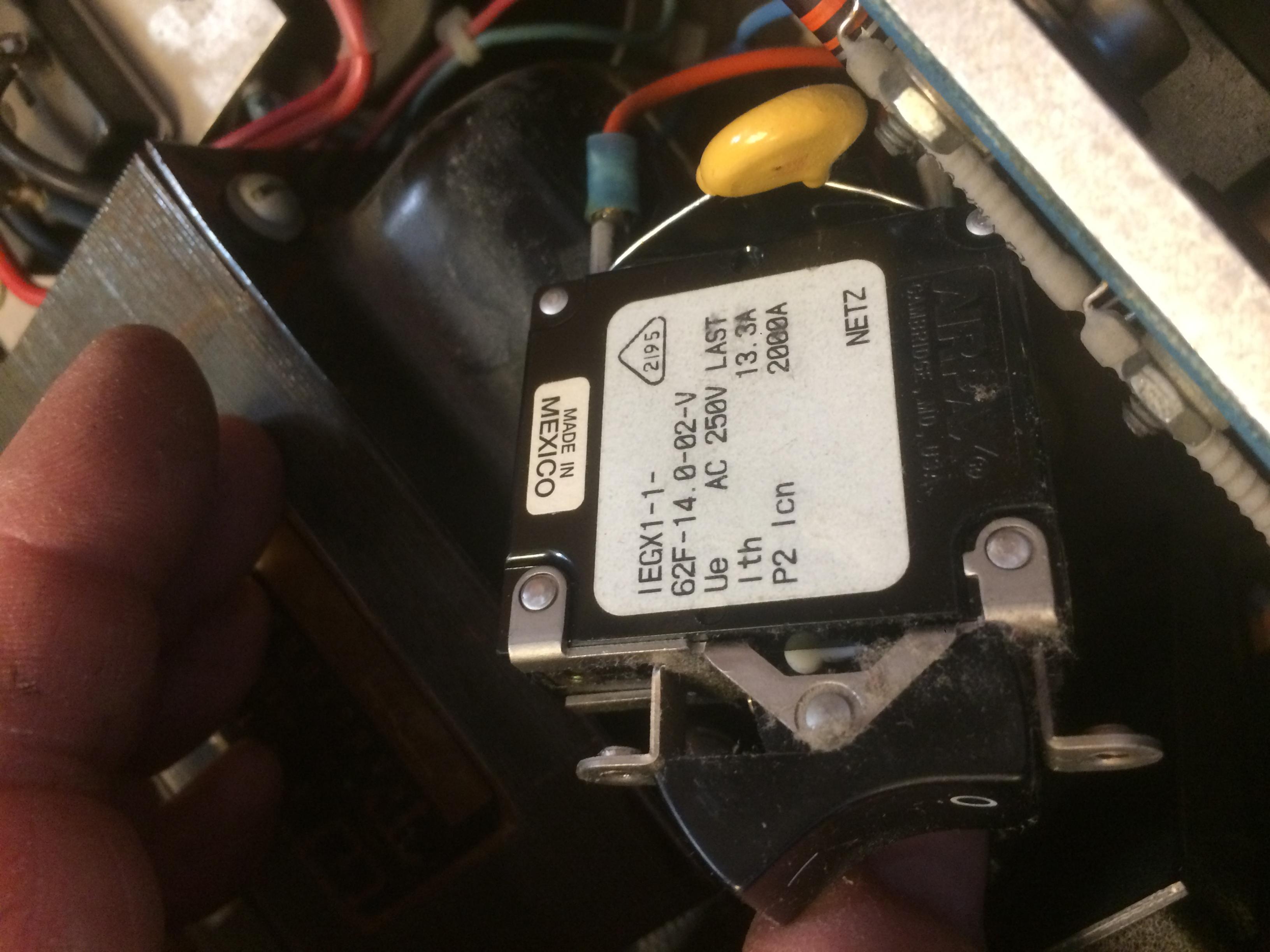

I purchased a new mains switch for my 400A many moons ago from Jon Soderbergh. I promised member Eric M almost as many moons ago to find out about this switch, and he reminded me yesterday, so I opened up my Threshold 400A, removed the two bolts, grabbed the switch and took some pictures of it.
I am pretty sure this switch from Digikey will work perfect in a 400A:
https://www.digikey.com/product-deta...2-V-ND/5084008
Digi-Key Part Number IEGX1-1-62F-14.0-02-V-ND
My switch is labeled Airpax IEGX1-1-62F-14.0-02-V
Please double check, but this seems correct.
/RK
Threshold 400A mains circuit breaker pictures
Here is the pictures of the gircuit breaker I purchased from Jon Soderbergh many years ago.
