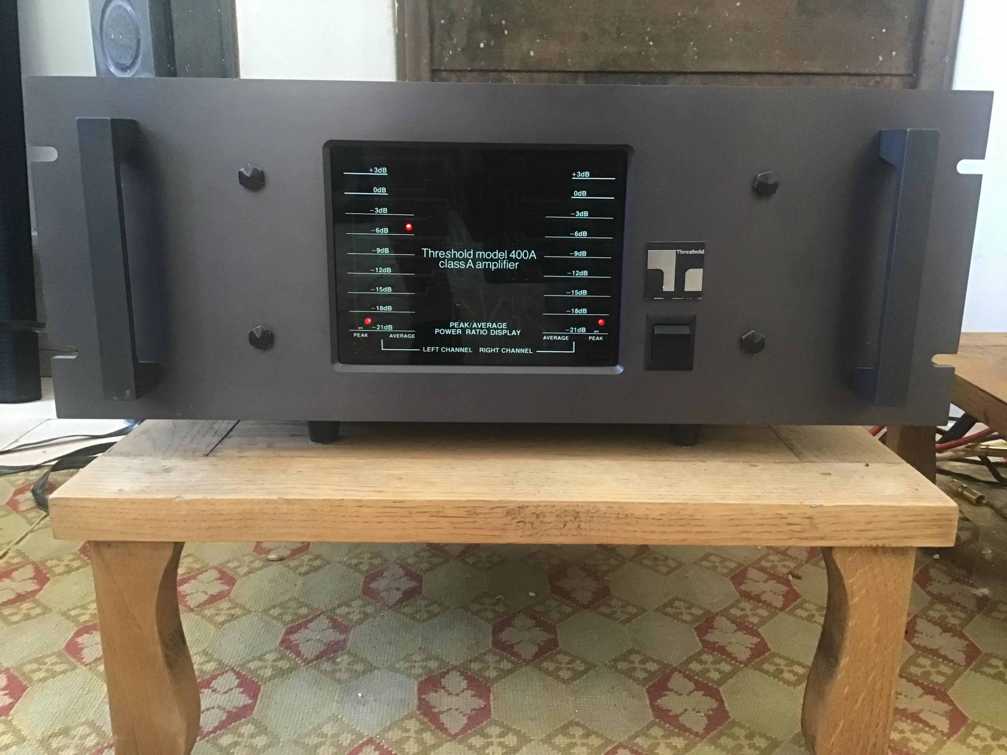

I just took delivery of a 400A and on setting it up noticed that a LED on the left rail at -6db is permanently on…see pic. Any one else encountered similar and a fix? Also, there’s a slight humm from the transformer (not through the speakers). Is this normal?
Otherwise, I’m delighted. The amp sounds wonderful.

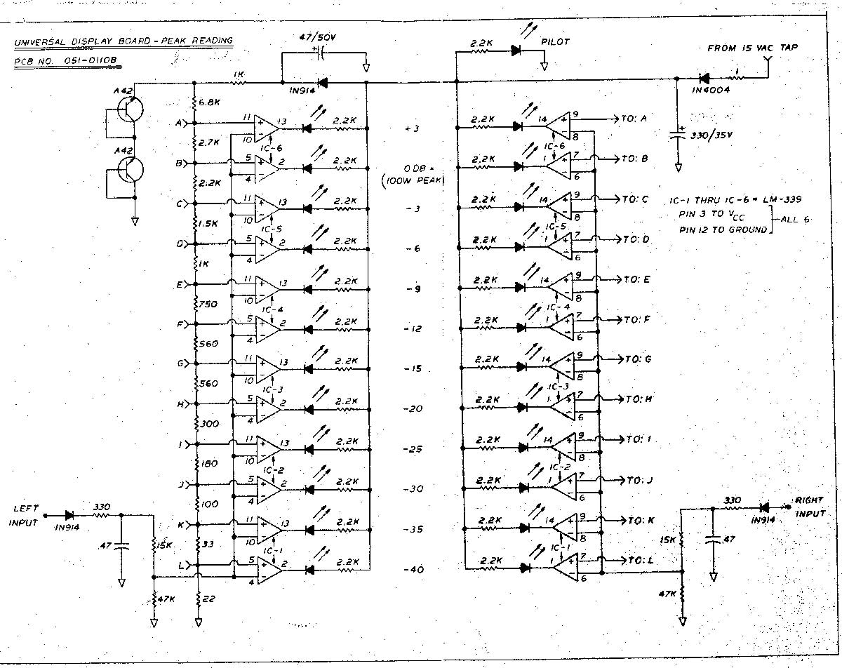

display - I believe enclosed will help - mater of changing one OP ........ in fact - first check all connections and solder joints
xfrmer buzz - try tightening bolts of xformer itself ....... maaaaybe it'll help
if not, just chill
