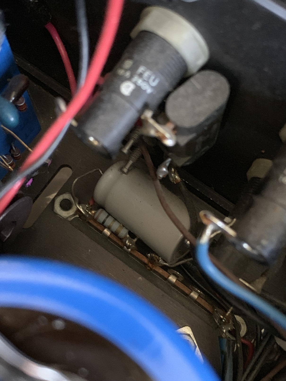

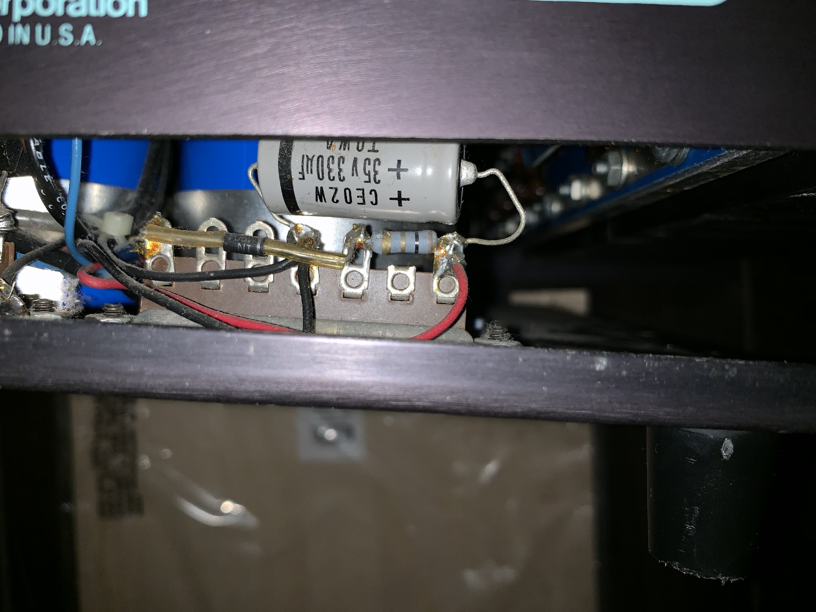

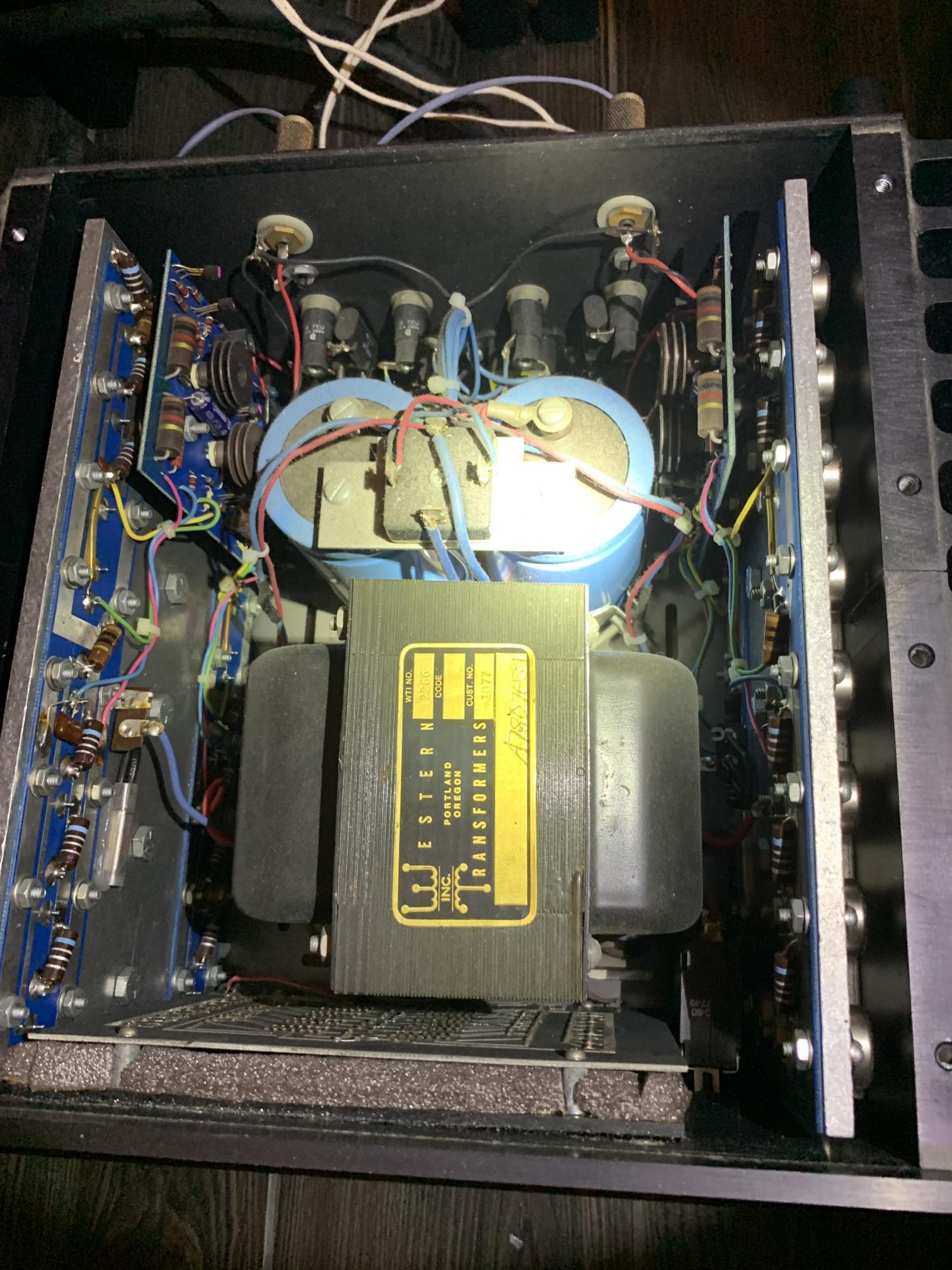

Thanks for your response! Here are some photos:
The first two is before any work was done.
The third photo is the squashed cap.
The fourth after I straightened the cap and checked for loose connection.

If one channel works and one not, see if there are separate fuses for each channel. One may have given up the ghost.
If you have a multimeter, check that the power supply lines to the bad channel are OK.
