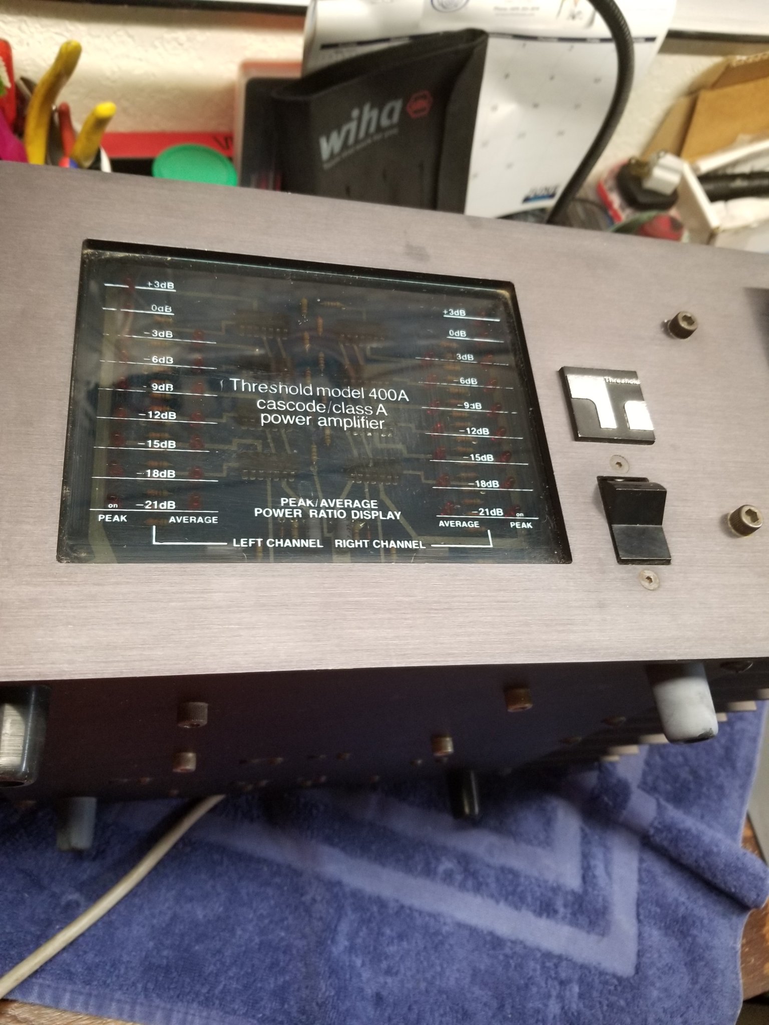

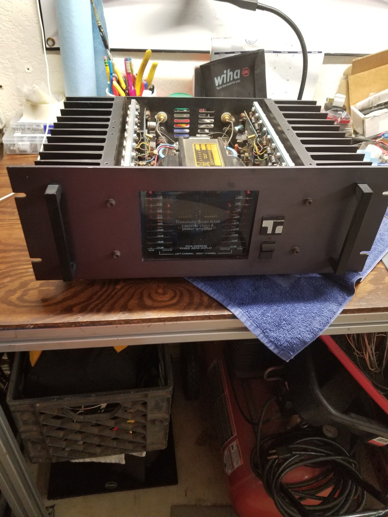

I recently picked one up (not working). Did not attempt to power it up. I can't find what fuses are supposed be in this. Assume there are all fast blow fuses.

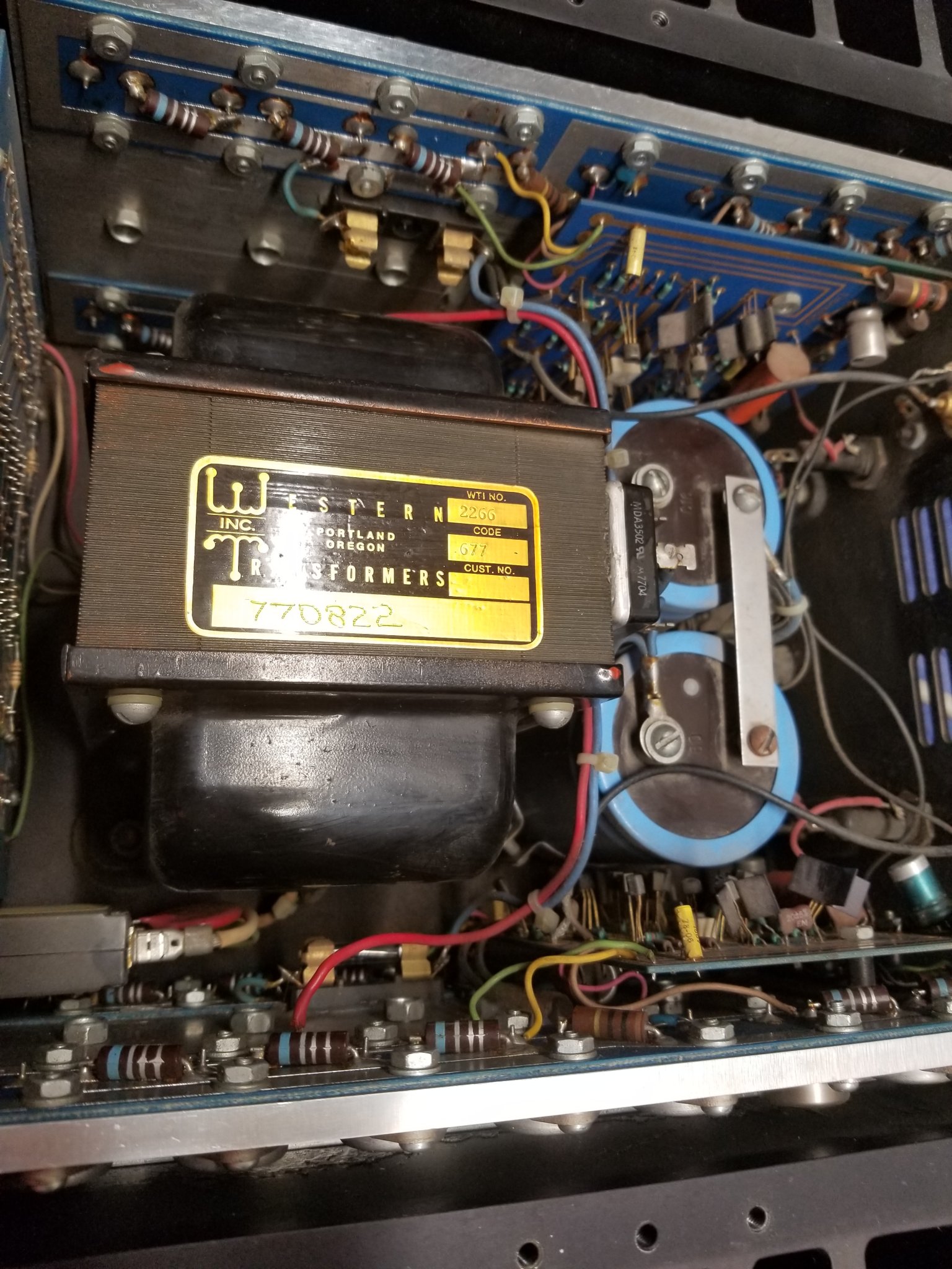

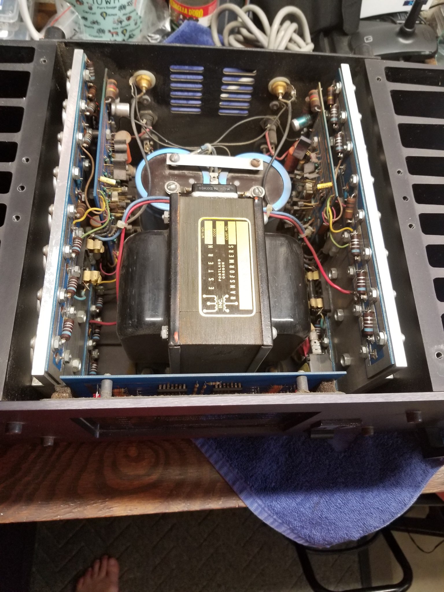

I removed the top cover to take a look inside. Left channel side there was a 4a 250v fuse and right side was a 4a 32v fuse. The 32v fuse was blown. Are these the correct fuses for this unit? If not, what is correct?
Anyone have the service manual for this? Like I can read schematics...Not! I'm an electronics Newbie. Mechanical side is my forte. Thought this would be a good project for this old retiree.
I would appreciate guidance getting the Amp going. What to do/not do etc.
Considering its age, it is in nice cosmetic condition. SN 770882. Ground broken off the power cord so need to replace the cord.

Background electronics education will be needed before tackling such a beast. All parts will require testing.
Also some test equipment will be necessary; to start, a scope, DVM, high power load, and signal generator.
Preferably more.
Doubtful there is a service manual. A schematic is available, but the exact parts will not be available any more,
which will require sound judgement when replacing them. Blown/missing fuses likely means damaged parts,
and time will degrade other parts.
Main choice is repair (replace only damaged parts), or restore (complete disassembly, replacing virtually all parts).

With a DVM, you could check the resistors and p-n junctions, all measured in-circuit and unpowered.
This may give you a better idea of the present condition. Read the DVM manual first.
But there may also be bad capacitors, bad solder joints, etc. Heat sink compound could be dried up.
Pretty much anything can happen in 50 years.

though, with this amp, it is really best option for your wallet if you find someone with experience to help you directly, or even to send it for repair
it could help even just to talk with Jon S. and receive sort of preliminary price for amp refresh ....... you'll certainly know more
I mean - in case that's NAD 3020 or MF A1, we will be already all the way in, ripping parts away and making list what and how to change
but, with this one, very possible damage (if working without enough experience) should be very costly
