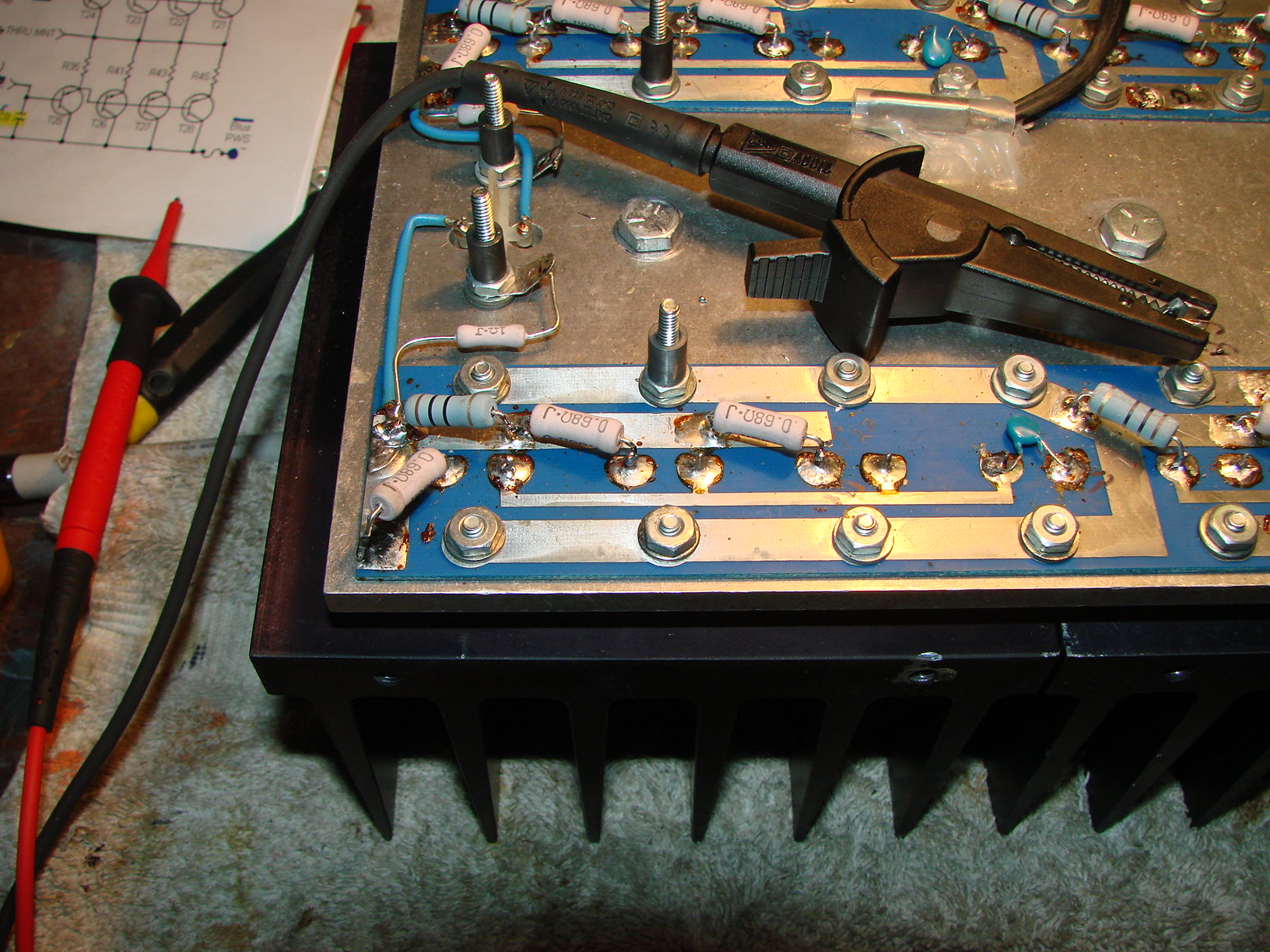

Ok, making progress,
Can anyone please give us some idea why there is a thermistor across
the Base/Emitter pins of the "first" power output transistor.
All the schematics we have show the thermistor going from the base pin
of the "first" transistor to the emitter of the "second" transistor with the emitter of the first transistor going to the base of the second transistor
so its not as if the connection shown on the schematic was physically achieved by an alternate execution.
Thank you, andrew
The schematic made by m2003br in post #14 shows the thermistor connected like you are describing.
All of the schematics show two thermistors. Do you also have two, both connected across the base/emitter pins?
May I suggest that the 5K bias adjust resistor has been turned or become shorted. Either could result in excess output idling current, such that the output transistor will over heat. When the first output transistor goes south, then the other two are additionally stressed, finally resulting in the other two also going south.
Verify that the bias adjust resistor is set the same for both channels to start with. The position should be near center.

Regarding the thermistors, there is only the one as shown on Marco`
schematic. There is another device wired into the circuit board and
"glued" to the output transistor base plate. It must be the thermal
overload which appears to open the line between the A92 LVA and
the A42. No other thermistors.

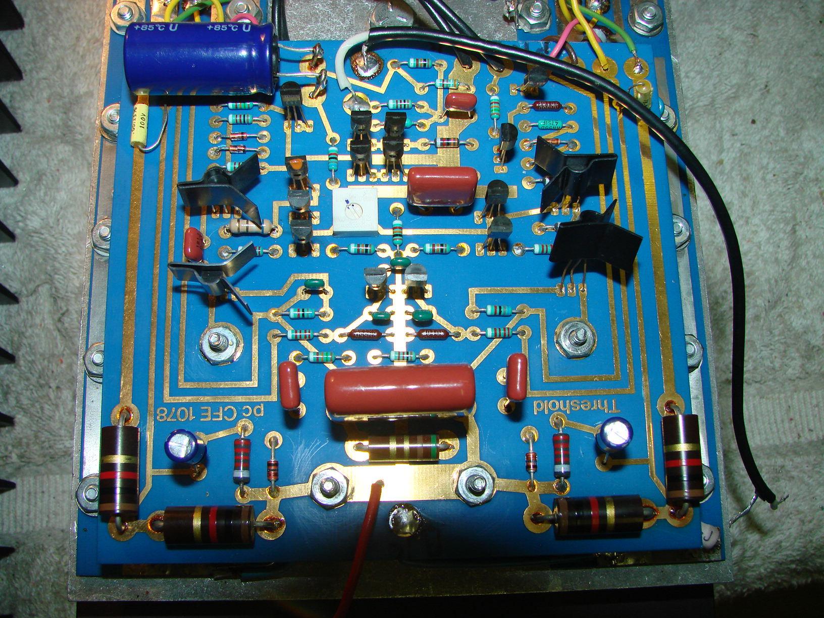

I have included a photo of the output section, you can see the two blue thermistors and the "overload" device glued to the plate.
(Also note that a couple of the resistors have been "lifted" while undergoing testing)
In the photo of the circuit board you will see the one transistor that I have marked with an orange dot. This was the other transistor that had partially failed along with the LVA A92. On the partially failed transistor once removed from the board I had from B to E .609 and from B to C .249 setting was on diode function with the Fluke 87V.
The failed devices have been replaced and you can also see the beige colored 68ohm resistor which is the one that had burned and split.
Awaiting a shipment of output transistors from Mouser and then we will begin again.
Thanks much to all for the help, andrew

I will tell you that as I went further into my investigation I decided
to dismount the output transistors from the mounting plate.
I found one that had escaped my previous examination.
It appeared to have some value of function and I must have been
reading possibly parallel through the other mounted devices.
With this new piece of information I am hoping that this was the final
problem which was causing the odd slow failure of the other transistors.
We are currently awaiting a shipment of replacement output transistors.
As soon as the new components arrive and are installed we will post our
results.
Many thanks again for your help with this repair, andrew
Good morning all,
We had the opportunity to rebuild the output transistor section of the amplifier and with the help of the forum members we have success!
The amp runs with 245mv across the output transistors on the rebuilt side and 250mv on the original untouched side.
The temperatures are 119.2F on the rebuilt side and 121.1 on the original.
The manual gives us 90ma and 113F with the amp that utilizes the .068 resistors across the output transistors.
We will make the adjustments to the current values soon to hopefully get the current and temperature to the specified values.
Additional information.
Prior to operating the amplifier we decided to check the small value capacitors on the circuit board. (These had been left untouched since all previous schematics did not show the existence of and therefore the values.)
(These caps did not indicate a shorted condition or appearance of physical duress so during that period of time we decided to leave them alone) Once we had a good working schematic and due to the fact that our meter did not indicate any reading on these caps we decided to substitute the "closest" value we had on hand.
For the 390p we installed a 470n, for the 20p we installed an 18n, both polypropylene.
Yes, we have chastised ourselves for our impulsiveness for taking this direction after all of this work.
Fortunately the amp works and we ran for about two hours.
(We also revel in the amusement this must provide to the electronic engineers who truly understand the
consequences of this action. )
In this configuration though the L-R balance must be shifted to send 90% of the signal through this channel. The sound on this channel was very "boomy" with the mids being far in the background, almost an echo effect. Opposed against the original untouched channel it was quite an effect.
(Momentarily considered leaving it that way 🙂 )
The proper value replacements are due to arrive soon and we hope to have a fully functional unit.
Many thanks again to the forum members for their kind assistance, andrew

Good morning Mr. Brennan,
🙂, yes a 1,000 times different.
We are hoping that this is the reason for the sound quality and signal level being "off".
Regarding the statement that I had found an additional output transistor which indicated a "value of conduction.
The initial approach to the overall repair was to disturb as little of the original amplifier as possible so therefore I did not summarily disassemble the major sections until indications would prove otherwise. When I believed that I had traced out all of the faulty output transistors I reassembled the unit and made numerous, resistance, capacitance and diode function "checkpoint" measurements throughout the unit. Being fortunate to have a mirror image fully functioning channel for side by side comparison and having the values match all along the way had the effect of raising the confidence level.
The only difference revealed was the point where the four small wires, (eight total, four for each side of the section) leave the circuit board and connect to the output transistor segment. The resistance reading was 4K between two of the wires, YtoGn if I recall correctly on both sides of the circuit board on the original untouched side of the amp and 3.8K on the rebuilt side.
With my level of experience I "convinced" myself that this must be the accumulated difference of the new OnSemi transistors as oppposed to the accumulated readings of the original Motorola` on the untouched side of the amp.
In this configuration the fuse was no longer blowing but the LVA transistor very slowly burned up. This then drove me to completely break down the output section and test each device individually. One transistor out of the complete package then revealed a reading of .243 on diode function of the meter from C to E if memory serves.
At this point the output section was completely rebuilt with a full set of the OnSemi MJ15025 and MJ15024.
A reassembly with another multi point side by side check now indicated 4Kohms and 4Kohms on both sides of each circuit board section and both sides of the amp. At this point the small caps were checked, (this is the point of the impulsive substitution since confidence and anticipation were running high).
The amplifier is now operating albeit with the "murky" sound which we hope will clear up once the proper small value caps are replaced.
Regards, andrew

Hi Andrew,
Congratulations for your success.
But, please, put back the original Silvered MICA caps. This is a (almost) "bullet-proof" component, never requires substitution.
My poorly hand-drafted schematic shows all three little caps, for sure.
Marcos
Marcos
Good evening Marco !
Very nice to hear from you !
Yes, most certainly those Mica caps will be reinstalled.
Since this amp received some manner of duress to its system
we will be replacing the old mica caps with new ones per
your schematic.
I agree with you and from what I have read these are very
resilient components. Since I was not able to obtain a reading
with my meter I thought best to replace with new and these will
be of the indicated values on the schematic.
I will post soon when the final parts are in place.
We hope for a succesful conclusion !
Thank you again for all your help and I hope others who may experience the same difficulty will benefit from your knowledge.
Regards, andrew
