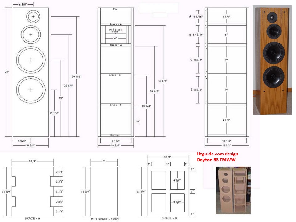

i am going to do three way stereo speaker project. i use 8 ohms for low ,mid ,high frequencies . for low frequencies i want to use two 8 ohms woofers per channel in parallel configuration . so low frequency crossover will see 4 ohm load ,mid and high frequency crossover will see 8 ohm load.
i am not sure about this configuration . is it possible have this configuration?

Yes, this is OK. The crossover is the same -- except the component values change a little. Example, the resistor values and inductor values are half. Even better, you can simulate and it will be just as easy as having all 8 ohm ;)
Three way TM-WW designs are very popular because a narrow cabinet can be used with two 8" woofers, but still have the high SPL and high efficiency of one 12" woofer. Htguide.com has a well reviewed TM-WW with modest cost Dayton drivers. A search will find several TM-WW designs with higher quality drivers.
When I ran a simple WinISD sim of two Dayton RS225-8 aluminum cone woofers the data showed that a ported box with 3cuft generates -F3 ~32Hz, which provides strong stand-alone bass.
The Dennis Murphy Design. Most of this research can be used with a slightly differently shaped 2-cabinet TM-WW construction to fit your style/needs.

It's risky to have two 8ohm woofers in parallel because the impedance can drop to such a low level that they become difficult for your average amp to drive. Problem is you are crossing where the impedance is very low. If it were a 2 way with parallel midbass drivers, you'd be crossing much higher, where the impedance is also high.
thank you, i have designed three way with single woofer per channel but woofer spl is low to my taste and i have to boost bass frequency in preamp . again thank you for your reply i will go for two woofer per channel for higher spl ..
