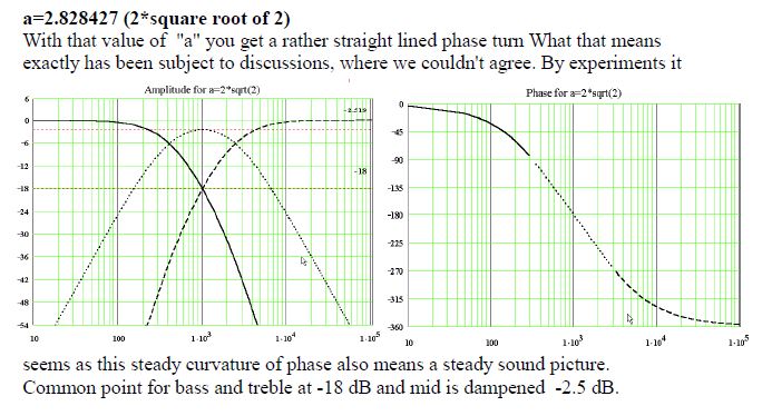

How phase aligned three ways work:
Vas of 200L, Qts of 0.41 on a 10" driver. The exact calculation is about 100L as you say, but everybody uses undersized boxes, closed or reflex. Usually about 50L is OK with 10" bass.
There is a point where it just kinda works. And smaller boxes have that property called WAF. Because you usually have to get it past the significant other.
