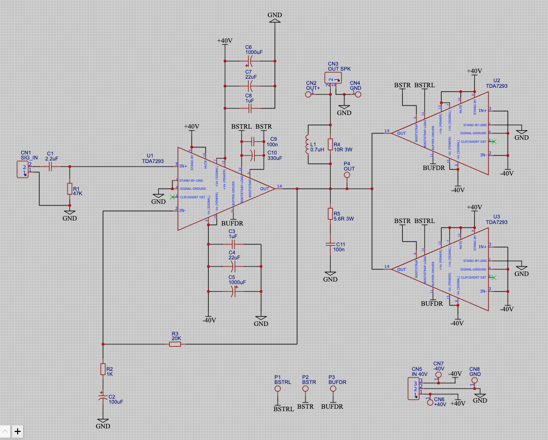

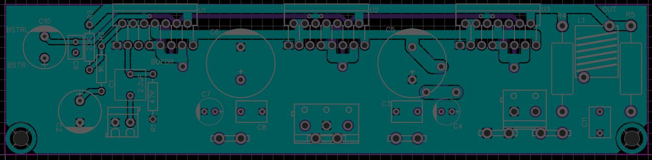

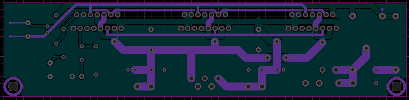

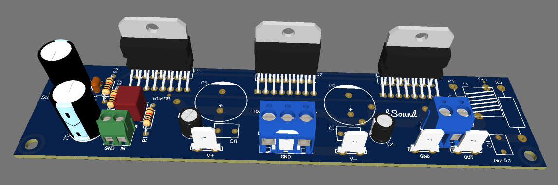

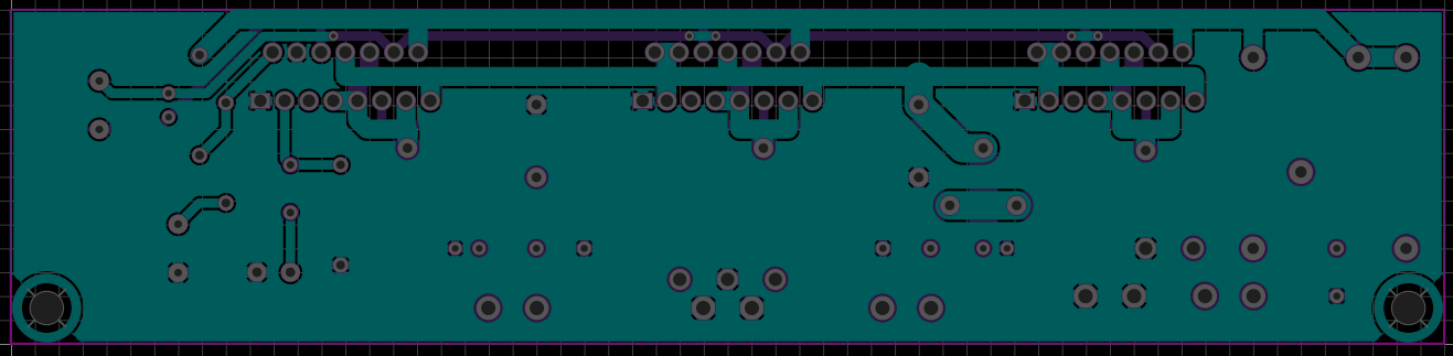

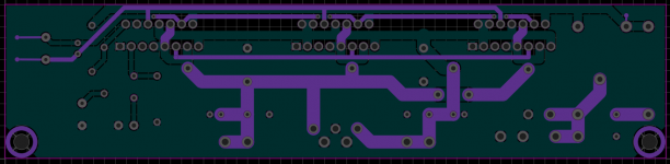

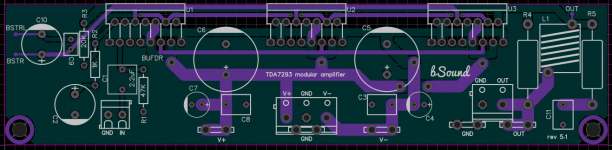

Three TDA7293 in modular schematics with PCB design and gerbers
Joined 2011

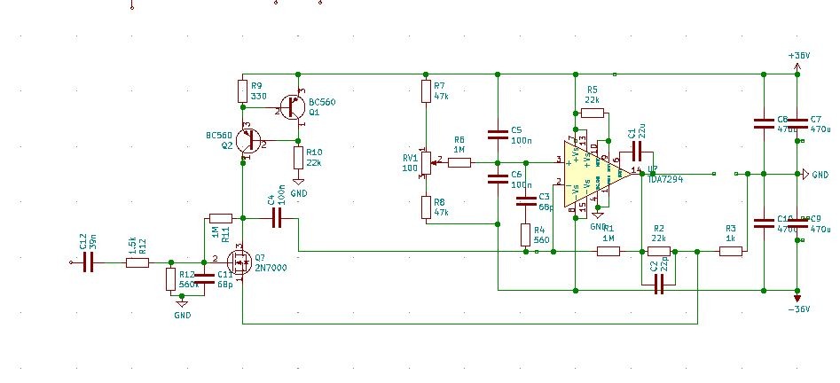

If you might be interested in simple composite with 70dbNFB@20khz instead of 24db, that is 200 times more error correction. Here is a working circuit, you can parallel to get 65W 8 ohm 120W 4 ohm.
It has start up plop issue.
