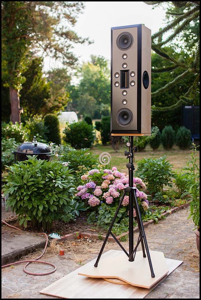

694083d1532807648-pseudo-coaxial-narrow-directivity-horbach-keele-filters-_mg_7342_klein-jpg
This post I just wrote, helps me understand Follgott's speaker. You wouldn't think that a low efficiency 2" midrange would cut it, but the efficiency gets REALLY high when you array them. And the use of a ribbon makes sense, because the center driver in the array has a huge impact on the other drivers, and ideally it should offer high output. It doesn't matter if the output of the center driver is achieved by high efficiency, high power handling, or both. All that matters is that it's the weak link, so it needs to be very capable.

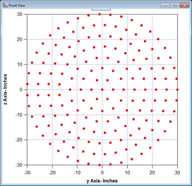

I took the seven element array from post #3, and cranked it up to nineteen elements.
This forms two concentric rings surround a single driver.
The 19 element array exhibits some unexpected behavior:
1) somehow, the highs from the 19 element array are superior to the 7 element array. I'm not entirely sure why this is. It makes me wonder if going to a 60 element array would be even better.
2) Going from 7 elements to 19 elements doesn't lower the directivity cutoff a whole lot. This is because going from 7 elements to 19 elements only increases the diameter of the array by about 50%. Basically:
a) a one element array is 9cm wide
b) a seven element array is 27.5cm wide (3x wider than a single element array)
c) a nineteen element array is 45cm wide (1.63x wider than a seven element array)​
From that math, you can see that adding elements raises your power handling and efficiency in a big way, but only increase the directivity cutoff a bit.
3) It appears that adding the 2nd ring makes the over beamwidth wider. This statement needs some research, because the beamwidth of the device is dramatically impacted by shading. Basically the more you 'shade' the outer ring, the wider the beamwidth of the array gets.
Patrick will you simulate this disc with shading?
I've been running sims all day (it's a holiday) and the sims seem to indicate that there's no good reason to use small drivers in a 3D array.
Basically the center driver in these 3D arrays really needs to be a tweeter, but once you go that route, you might as well use (fairly) large woofers around the tweeter.
To me, it looks like a driver that's about 6.5" in diameter is the "sweet spot." An array of a hundred 5cm drivers is not a good solution, from what these sims are showing me.
