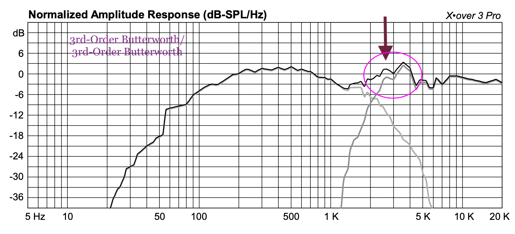

The little bump at the arrow doesn't worry me as much as the elevated levels in that region in general. Peaks at 3-4 kHz tend to be like an ice pick to my ears. Maybe that one's narrow enough that it's not an issue, but from a design standpoint, I'd typically push the highpass up a little, jiggle the Q, etc. to try to eliminate the peak at ~3.5 kHz and push that region down some. Obviously I don't have your speaker in front of me, so I can't judge what it sounds like, just what the plot looks like and what that has meant to me in the past.
Of course some listeners prefer a brighter/more revealing presentation as well, so it might suit them.

Thanks for your contribution!The little bump at the arrow doesn't worry me as much as the elevated levels in that region in general. Peaks at 3-4 kHz tend to be like an ice pick to my ears.

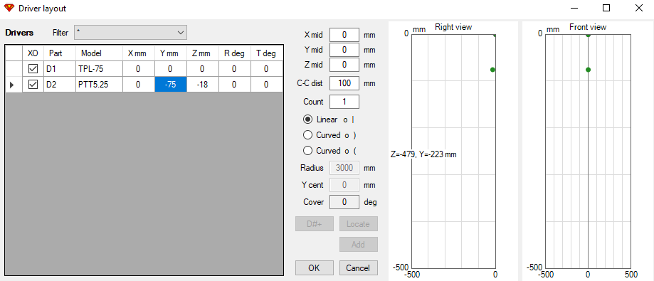

I think negative z is correct for the woofer in VituixCad. Looking at the right view in Driver Layout the woofer's acoustic center appears deeper than the tweeter's.
I'm not so sure.

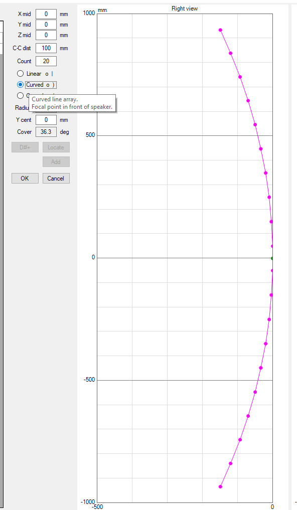

If you use the curved line array making the focal point in front of the speaker as shown, then a -ve Z would be toward the listener / mic.
I'm pretty sure the Driver delay tab plus per Z setting on the driver in the crossover tab work as follows
+ve mm / usec = away from listener / mic
-ve mm / usec = closer to listener / mic
