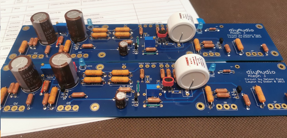

entire P series (upcoming) is having SE/Bal inputs
besides that, Aleph J - shown by 6L6 in his BAF episode , is having SE/Bal inputs
practically all of my recent amps with autoformer gain, where autoformer is replaced with active FE
rails and Iq the same, thus power
ok, in reality maybe a smidgen lower power (active FE being unable to have swing greater than rails), but that's ballpark anyway
